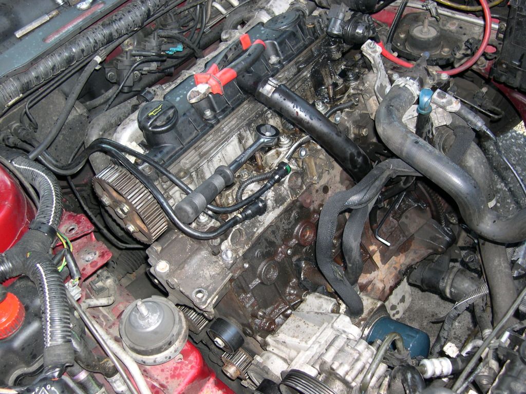

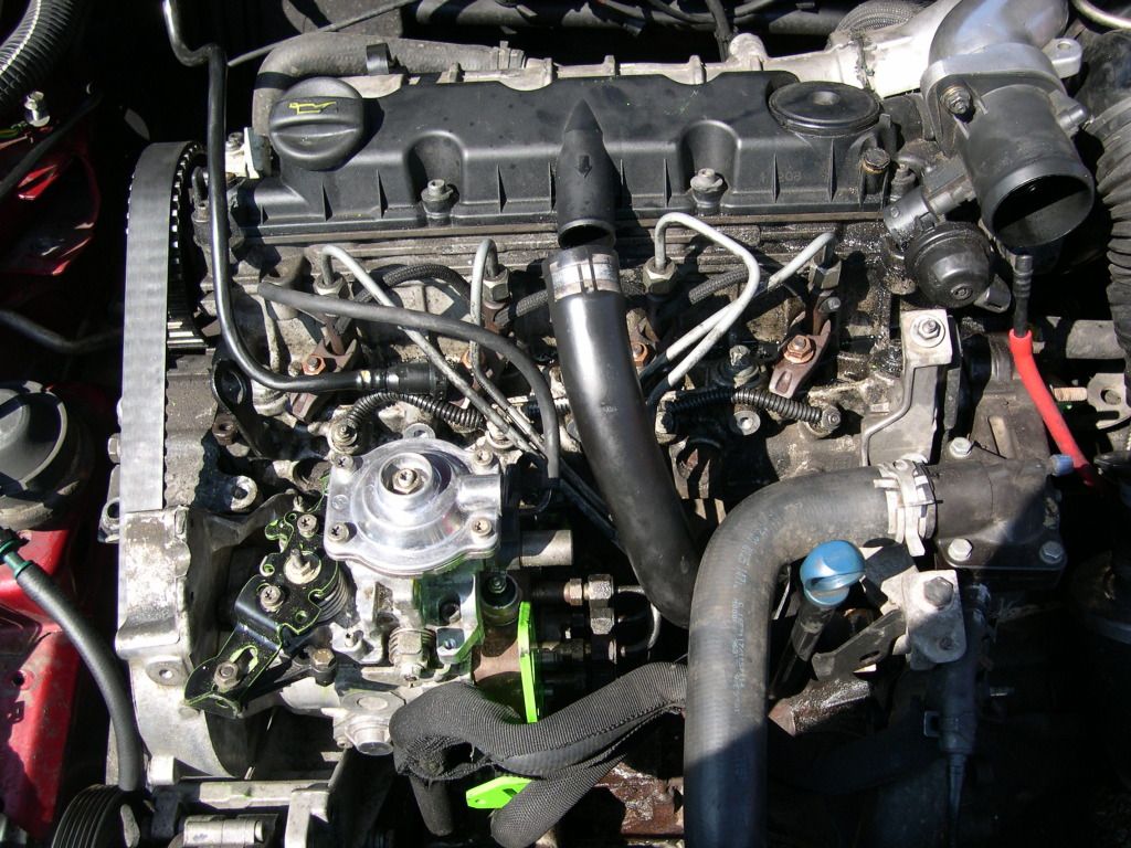

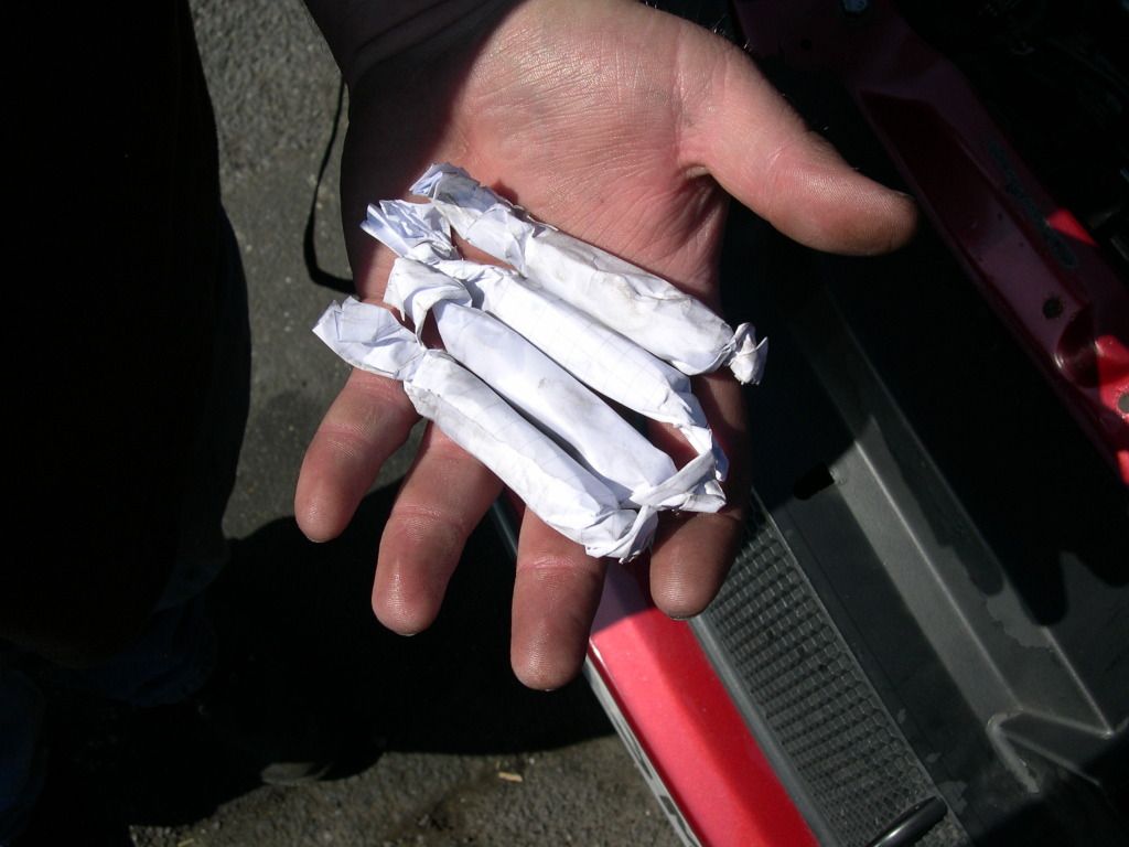

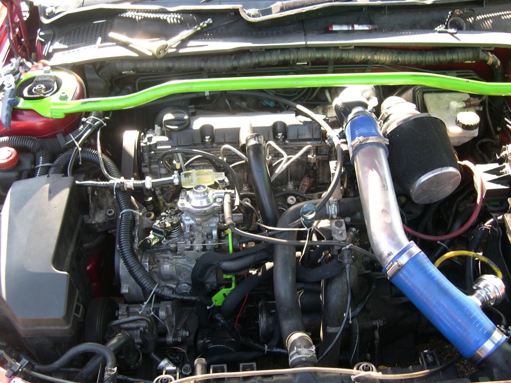

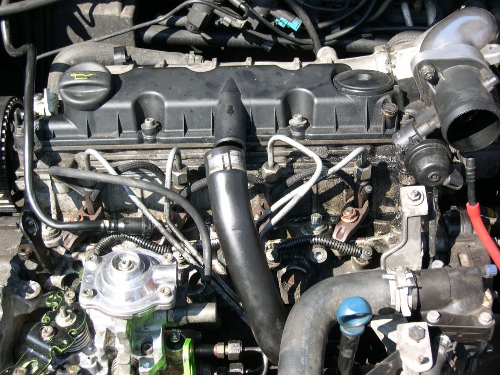

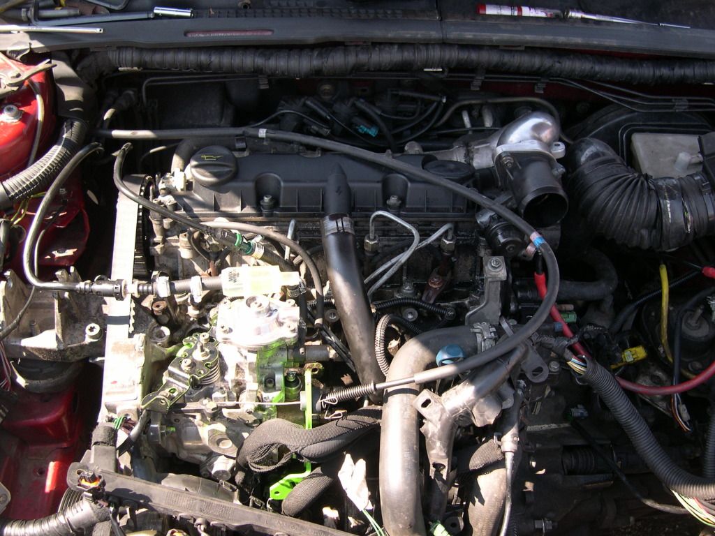

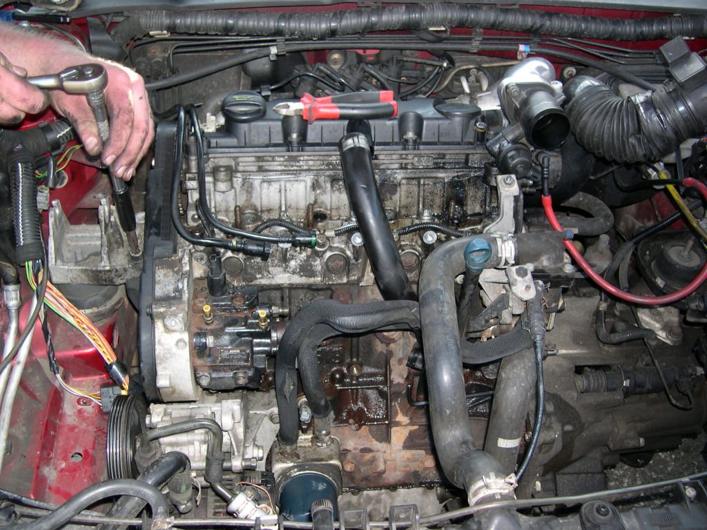

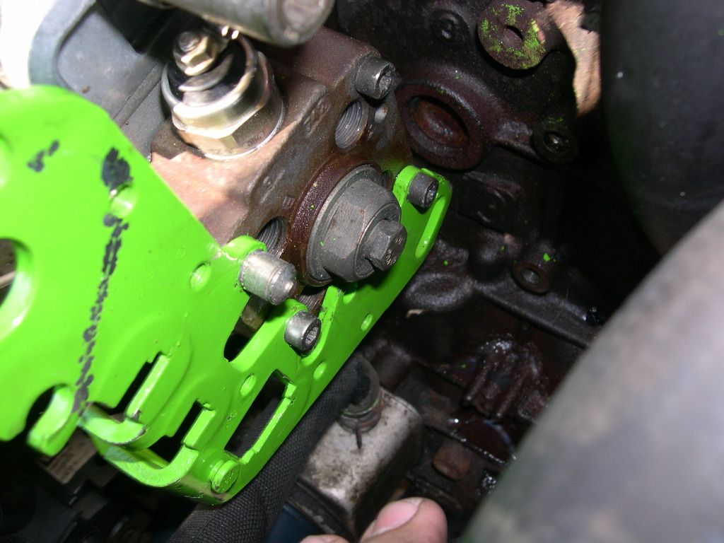

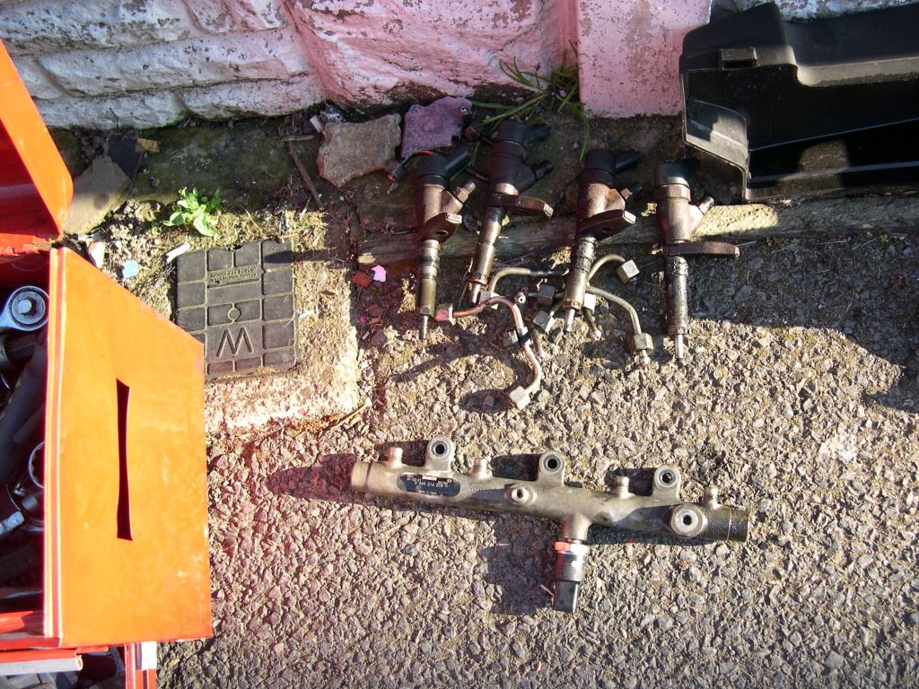

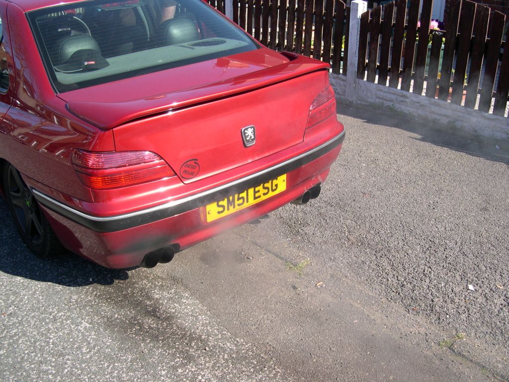

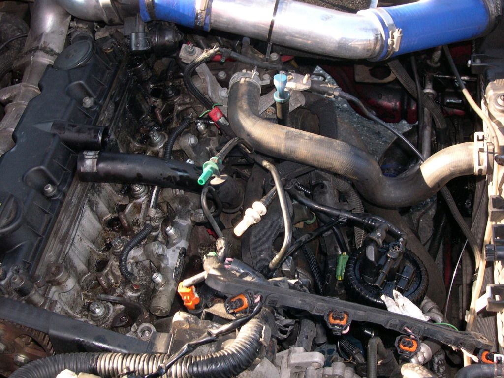

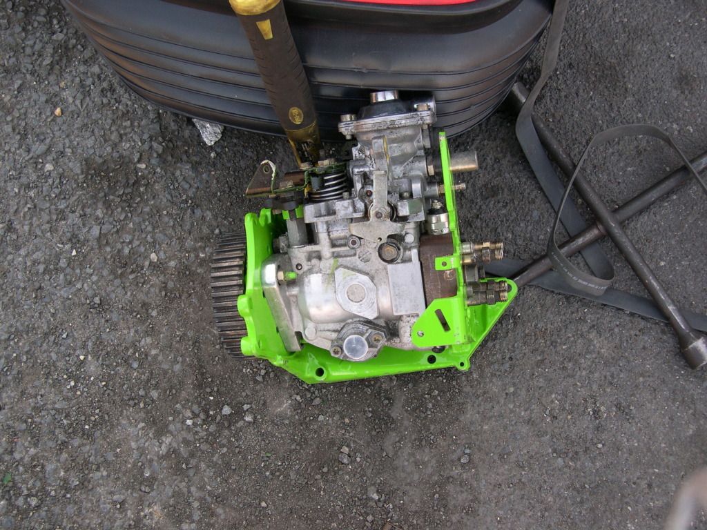

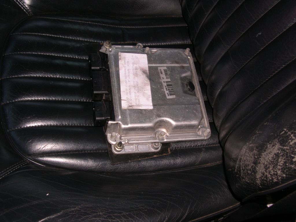

a few pics of us doing conversion
riped a few bits off engine starting with ecu wich when it goes back on it will only be running as a bcu or body controll unit

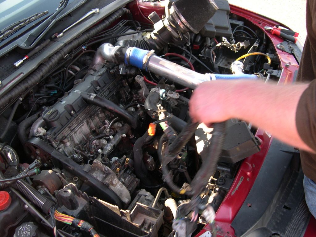

injectors and fuel rail

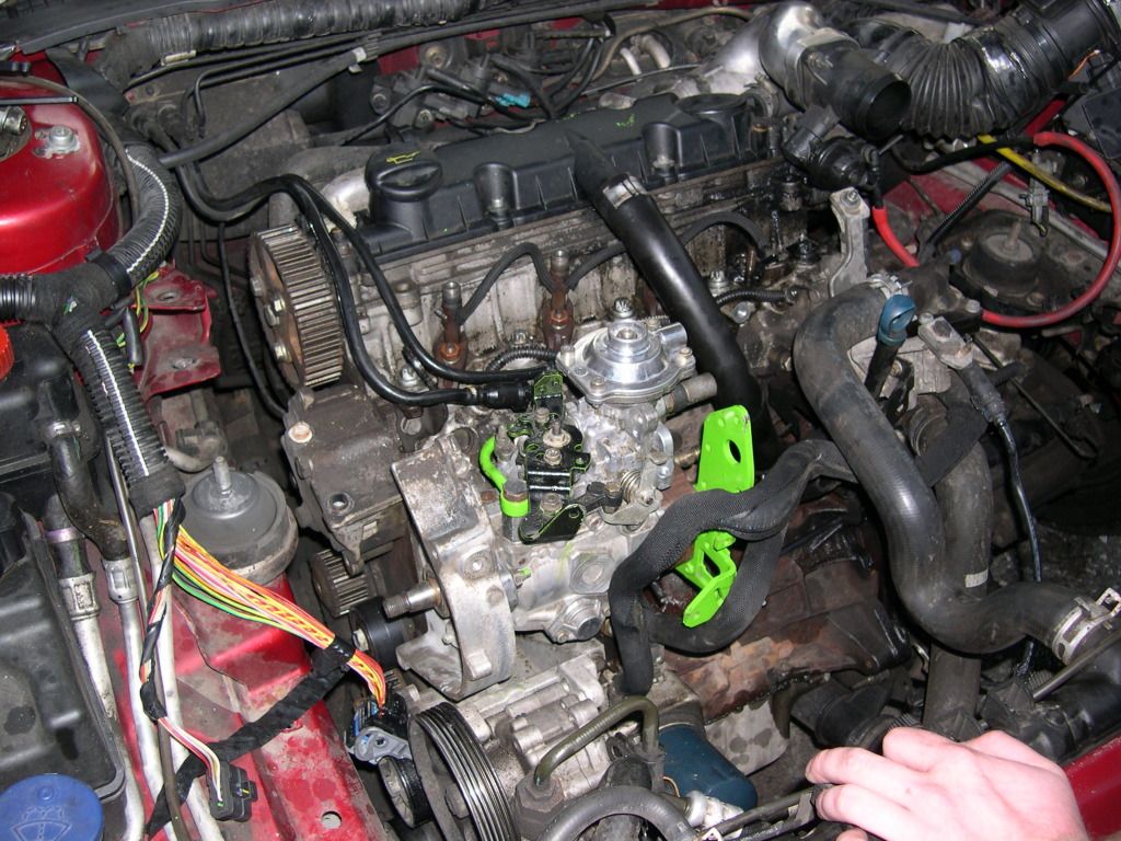

hdi pump removed and bracket removed so i we could bodgeyfiey the pump bracket to fit ve pump because it was a farse messing with the dturbo bracket the bodgeing wasnt easy lol but it works

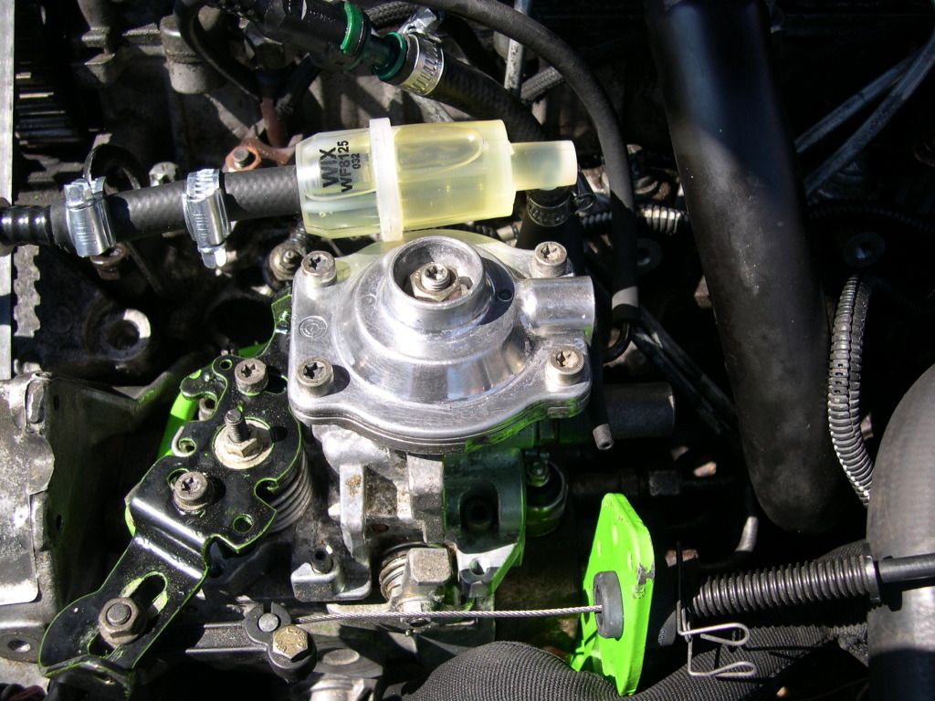

ve pump ready
pump mounted on engine

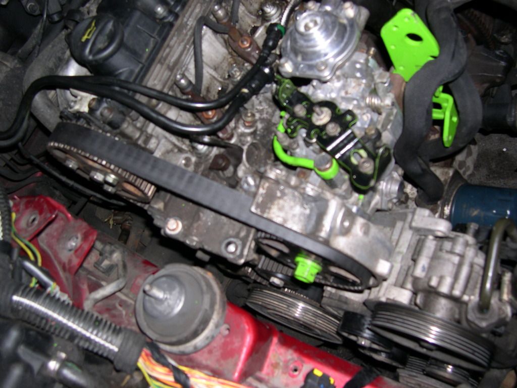

belt on and timmed up
delivery valves removed to acommodate better reconditioned ones
reconditioned valves
injectors in injector lines in pump on timmed no fuel lines
fuel lines made inline filter on
all back together
smoke on first startup dident get a vid didnt have time
ve pump ready
all back together
