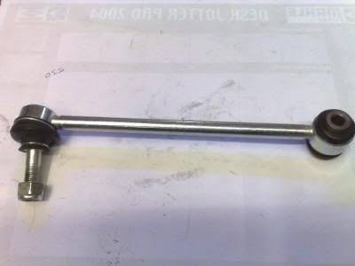

which ones are you changing ? the droplink or top link ? plastic or metal ?

which ones were you looking at on euro car parts ?
this
or this
Re: Rear links which one's ?

this
or this
I presumed its the bottom pic but now i dont know. i phoned a motor factor and said i needed links
and they dint ask me top or bottom they just gave me a price
who ever told you you needed the stabilizer links chaging you need to ask them which ones.
there are 2 on the back. as in the piccys.
plastic one is the lower droplink and sits vertical
metal one is the upper toplink and sits horizontal
both are cheap and should not cost £54 a side :shock:

Gary406 wrote:who ever told you you needed the stabilizer links chaging you need to ask them which ones.
