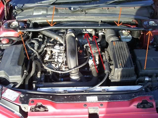

Re: 1.9 td staying on auto choke (cold start) 1000rpm
ok found a pic i had in my photobucket album
the RED arrows indicate were the idle speed controll is. you can see the circle thing on the right.
and the bolt on the left. just unscrew that bolt out with the engine running. if you look closely were the cable runs on the pump you can see it pulls a valve.
if you unscrew it out. keep unscrewing you will hear the engine revs drop
if it doesnt drop the revs when you unscrew it. try it the other way round and screw it in. either way it will drop the revs. i'm just not 100% which way it drops then revs
then simply tighten up the little nuton the bolt to hold it in position .
let me know how you get on
i did try pulling the cable slightly nothing happened but i will try unscrewing it tommorrow and hope for the best, will this affect the cold start in the morning? thanksGary406 wrote:ok found a pic i had in my photobucket album
if you unscrew it out. keep unscrewing you will hear the engine revs dropif it doesnt drop the revs when you unscrew it. try it the other way round and screw it in. either way it will drop the revs. i'm just not 100% which way it drops then revs
i looked at my idle controll screw today and noticed it was screwed in.
did you do yours ? how did you get on ?
