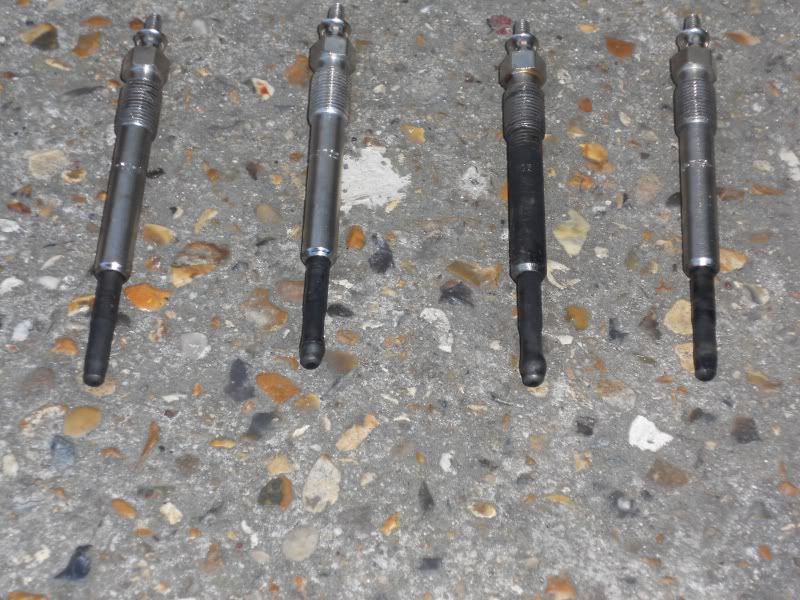

Diagnostics done today, came back with error permanent error P1352
Raplaced the Glow Plugs again - did all 4 for good measure.
These are what I removed - These have done 200 miles from new - whats the best way to test them, also
any idea what to check that caused them to fail so quickly

to test just get a 12v battery and attach jump leads touch the positive to the nut on the top and clamp the neg to the body of the plug.the plug should glow red ,if it dosnt its had it.
ps dont touch the red bit

A quick update - Advice still needed as where to go now
Have done 480 miles on yet another set of new glow plugs from Halfords (They replaced last set) and have failed again.
Fault P1352
Got a new set from EuroCarparts, this time they are Beru. Fault cleared immediately. Could it be a faulty batch from Halfords or should I check anything else on the car.
