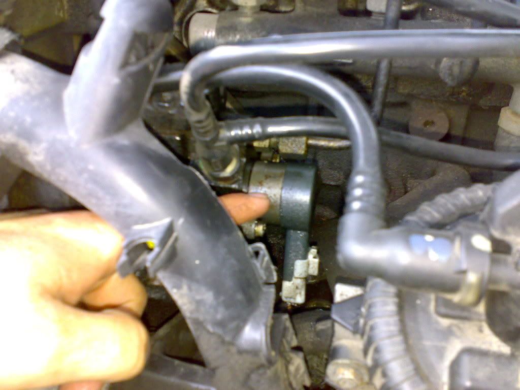

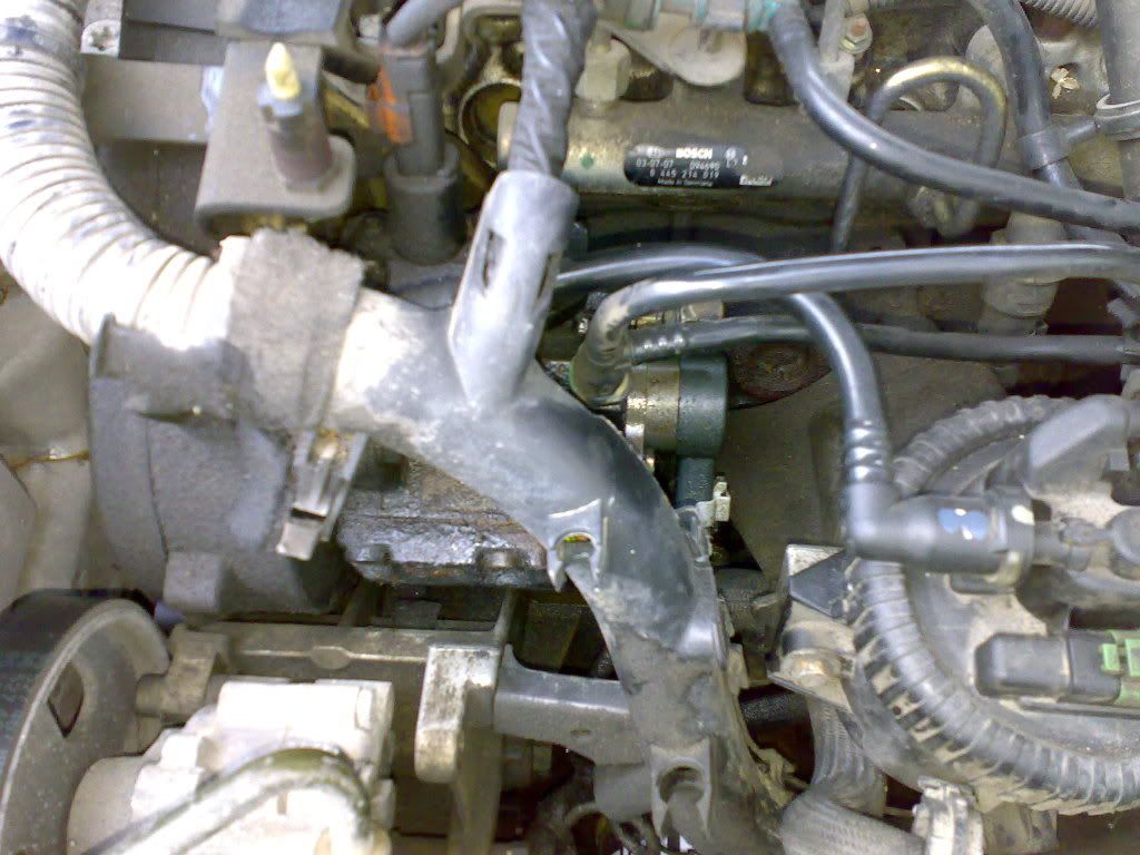

My 2003 Hdi 110 has started leaking diesel from the high pressure pump :roll: As you look at it from the front of the car,there is some kind of unit fitted to the end of the pump(opposite the cambelt side)with a plug.It is leaking from the underside of this unit,which seems to be fitted with 2 bolts.It only leaks when driving,quite badly.
I would assume that if i unbolted it i would find some kind of O ring or seal that would need replacing.Has any one removed it themselves,& is there anything inside that might "fall out" if you see what i mean.
The unit is at the end of my finger in the pics.Thanks in advance :)

That's an electro valve apparently. There's a gasket of some sort under it, plus a support ring and a couple of o-rings it looks like. FFS Pug want 346 quid for the valve :shock: :shock: :evil: and a couple of quid each for the gold-plated o-rings :roll:

I`ve taken the valve off but cant see anything wrong.Just going to cut a new gasket with some gasket paper to see if that fixes it.My local dealer has ordered a new gasket(no 5 in the pic),will cost a £2 :D .And the whole valve costs £295 + vat :shock: :shock:
Thanks :)

Any leak in the high pressure side of the pump is bad news for instant starting if at all.
The output pressure is monitored on the common rail and will not allow the injectors to fire if it is too low.
The Electro valve is the gadget that regulates the fuel pressure on the pump, it is driven by the ECU that supplies it with variable width 12v pulses.

Well,i got all the gaskets etc from the dealer.Could`nt get it to seal.Took it to a diesel specalist,£90 to fix,been dry as a bone ever since(3 mths)
