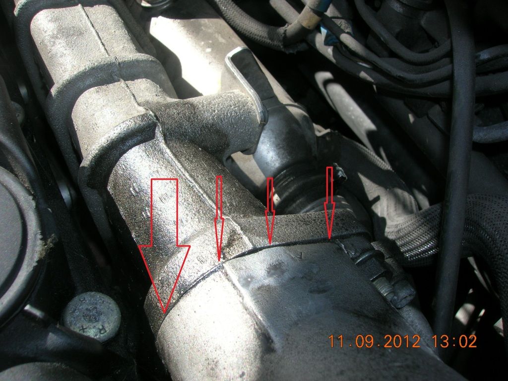

Hi,
When I removed my EGR, I blanked the intake pipe and used "instant gasket" type thing to seal it. Now, the intake pipe from the intercooler is leaking oil from it. I want to take it apart again, clean it with brake cleaner spray to degrease it and then seal it... but with what? Instant gasket stuff didn't seem to work...

they can be got from a dealers for about £1

Is that #3 on this? http://peugeot406coupe.nl/catalogus/D9G/1/14N18A.HTM
Dammit, Service Box is on its usual Sunday evening break :roll: http://www.ebay.co.uk/itm/CITROEN-PEUGE ... 0755446729
We used to use the back cover from a phone book for that sort of thing but I don't think they exist any more...

they are less then £3 at the dealers i remember them being about £1 the other week i got on from another forum for 50p
Re: Which gasket?
Thanks boys! That's exactly it!

thay are 50p from the delers part number 0348 N4
Re: Which gasket?
That's why I wanted to look on Service Box, some of the sellers on ebay take the pišš in the hope you don't check...
