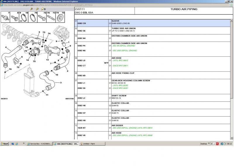

You could replace it with the pipework from a 2003/2004 model which bypasses the air-doser for a neater engine bay if you like.

Thanks I'ii see if I can find the pipe work at the local breakers

Re: air doser
This shows the alternatives
