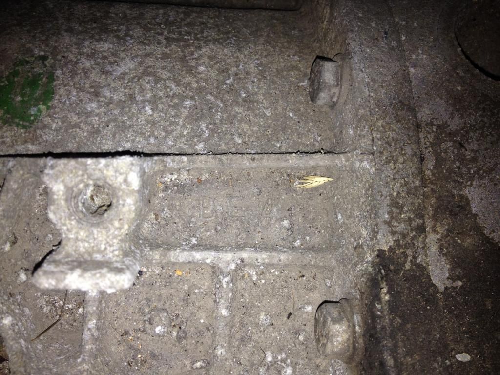

I took at the gearbox there it also says BE4 on the casing
