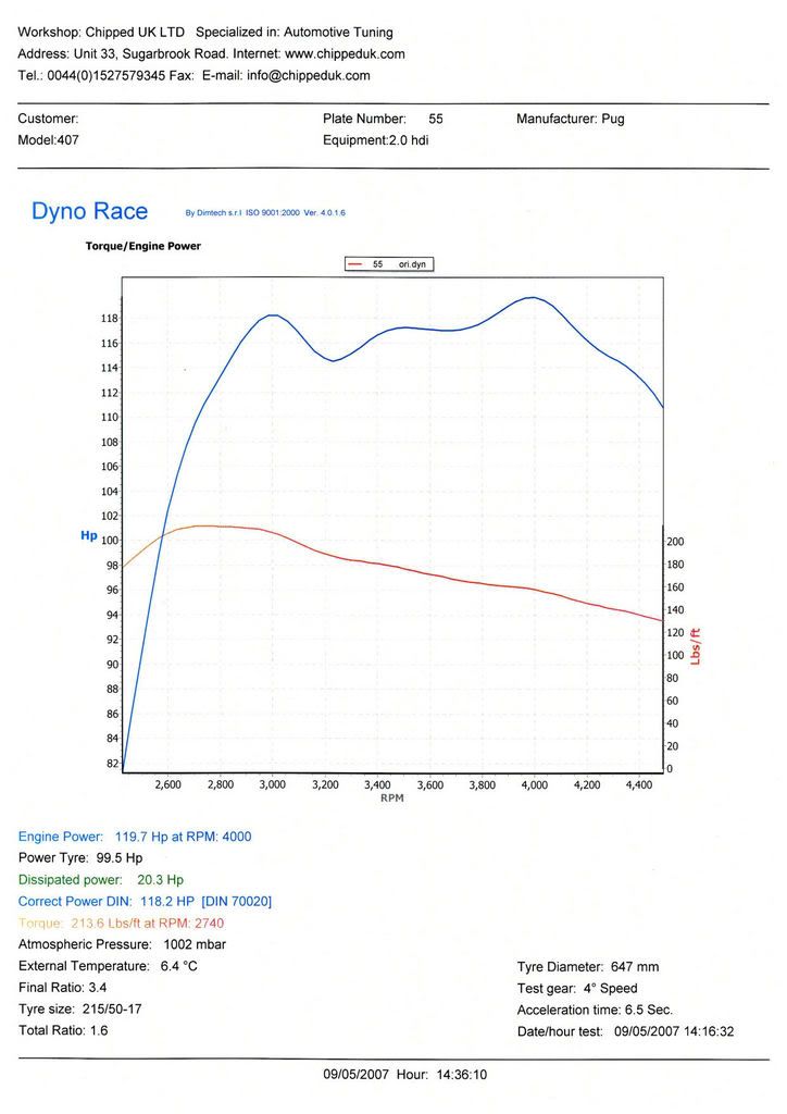

Initial rolling road test showed only 119.7 bhp at the crank (99.5 bhp at the wheels) and a max torque of 213.6 Lb/ft (289.4 nm) not very good for a vehicle with 20,000 miles that's supposed to be 136 bhp and 240 Lb/ft (320 nm)
I had even just had a service, fitted a Pipercross element and was running with BP Ultimate Diesel!

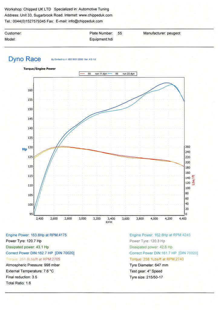

After the remap, which only took 1/2 an hour, we ran another test:-
167.8 bhp at the crank, 117.0 Bhp at the wheels and 268.4 Lb/ft (363.6 nm) of torque, that equates to an increase of 40% in Bhp and 25% torque
The car is a completely different drive, it is more responsive and feels much more like it should have left the factory. I did a couple of runs with my OBDII software which has a 0-60MPH timer and achieved a 8.5s run, unfortunately I didn't try this before the remap. (Book time is 9.5s on this vehicle)
This is now a very quick car and overtaking in 4th, 5th and even 6th is a breeze. Because of the torque it can go from 50mph in 5th and accelerate briskly right up past 120mph (Private road) before needing to engage 6th. 1st and 2nd gear in this car has always been a waste of space, they are so short that you're snatching the next gear very quickly from a fast start.
So what about the fuel economy, obviously if you hammer it everywhere like you just nicked it then it will suffer, but on a sensible run to work I can still achieve 53.3 mpg which is exactly the same as before the remap
I spoke to a couple of engine development guys who reckon that a diesel engine doesn't fully loosen up until at least 60-70,000 miles so the economy and power output will still rise!
Having spent some time analysing the data on the graph, I was a little concerned about the big increase in 'Dissipated Power' shown on the 2nd dyno run, having spoken to Jayson at Chipped UK, he explained that this is due to the engine and tyres getting warmer and that this effected the losses from the crank through to the dyno. The dyno they use automatically calculates losses on the run down after the readings for engine output have been taken. Because I was concerned he offered to do another run on a day when the car was cold.
Here are the results from the two runs we did:-
A small drop in both Bhp output and torque, but the graphs show a much more smooth delivery due to the engine learning it's new specifications. Apparently the Bosch ECU on the 407 HDi has 2Mb or RAM for learning engine and driver paramaters which is unheard of previously.
As far as rolling road (Dyno's) go I would take the figures with a pinch of salt, even though they are calibrated they can only measure the torque applied from the wheels onto the rollers; everything else is calculated based on somewhat 'wooly' parameters. Taking the vehicle to another rolling road would likely give different readings. Do some reaearch on the web and you will find loads of sites explaining why rolling Roads/Dyno's can not provide accurate readings - the only way to measure a engine's output is to take it out of the car and put it on a engine dyno. However they can provide an indication of improvements, but you'll notice these more on the road

I agree with you point about Dyno's every one is different, they can only give an indication and figure should just be taken with a pinch of salt. I've been running Peugeot diesels for nearly 20 years now and have found that every one only came on song around 130k miles, at this stage they really fly, engine smooths out, emissions drop and fuel consumption improves. Diesels need thrashing using the fuel rev range from idle to cut off, this is especially true with 'learning ECU's' as it's the only way that the computer can set all parameters correctly. I just wish more people would realise this, they would get far more enjoyment from their car.

That Bosch ECU learning thing has been around for ages on cars(Probably not 2mb of memory previously though!). My old Volvo 480 Turbo had the exact same system and the turbos had been out since 1989 so definately old technology. If you ever want to liven it up a bit more, disconnect the battery for a couple hours to reset it and then drive the next 100 miles like you stole the car and it will learn your driving style as being a quick driver and the ECU will come boost a bit quicker ect and allow for slightly more boost. Certainly worked on my old turbo so I imagine it will be the same for one of these new fangled diesels
