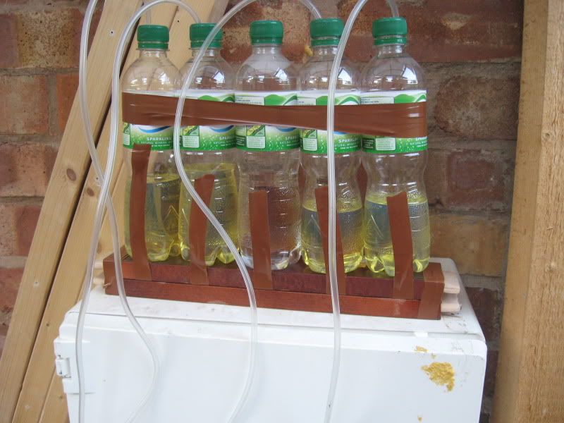

Read up a bit on this & it does seem the way to go, (Thanks, Steve).steve_earwig wrote:You connect 4 little bottles to the injector leak of ports, crank/run the engine and measure the amount of fuel the injectors don't use - apparently it's the standard test on common rails to identify any injectors that have "issues".
Anybody know what size pipe's needed, or where to get some?
Oh - & for anyone else wanting to 'try this at home' remember to plug the return line the leak-off pipes normally connect to.

Was going to start a new thread, entitled, "Doggy's been for a leak", but in the interests of continuity.......
Did the leak-off test today, as you can see, there's a big variation. Weighed the bottles, (& and emtpy one to get some accuracy).
Injector No. 1 - 179 g.
Injector No. 2 - 207 g.
Injector No. 3 - 124 g.
Injector No. 4 - 153 g.
(Collected a total of about 800 ml during the test - ignore the middle bottle, it's still got water in it to help the rig stay upright).
The figures don't exactly bear this out, but the general impression was that cylinders 1 + 2 were about the same as each other, likewise 3 + 4, but the two pairs are very different. (I understand a healthy set should all be within about 10% of each other).
So, what conclusions can we draw?
Do I have TWO faulty injectors, (1 & 2)? Or something else?
Bear in mind this fault is intermittent, (and gradually worsening). Now, I think two intermittently dodgy injectors exhibiting the same behaviour simultaneously is vanishingly unlikely, so what else do they have in common?
The ecu generates two 80 Volt power supplies, serving injectors 1+ 2 and 3 + 4 respectively, but according to PP2000, both are reading about 79.5 V, under fault conditions. I know from experience that failing switch-mode power supplies can give the right voltage, but with a huge ripple content making the kit they power unreliable. Maybe that's what's happening here?
Anybody got any thoughts / suggestions regarding any of this?

Re: Wobble when idling????
Oh & forgot to mention - carefully examined all electrical connections at injectors and ecu - everything looks perfect / identical resistances.
Started it with one injector disconnected - it's noticeably worse and you get the good old 'ANTIPOLLUTION FAULT in seconds, therefore I reckon that rules out any dodgy connection problems whiles it's running, as Auntie would let you know PDQ.

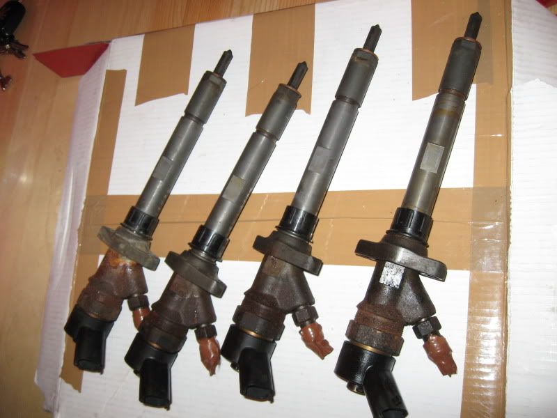

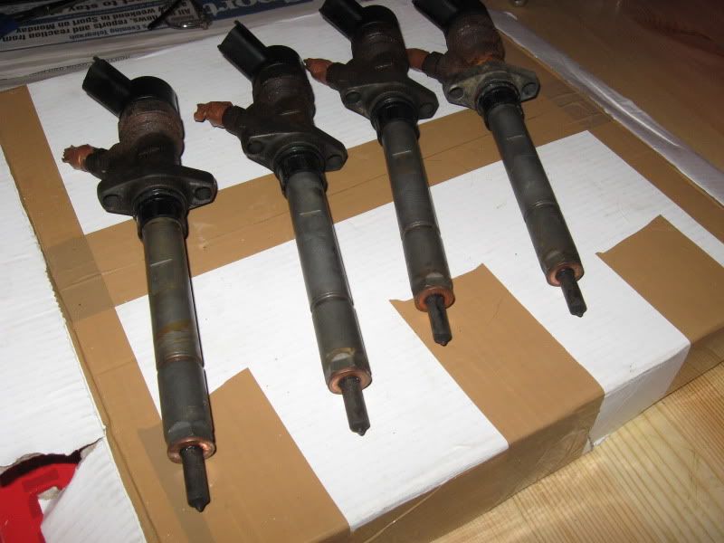

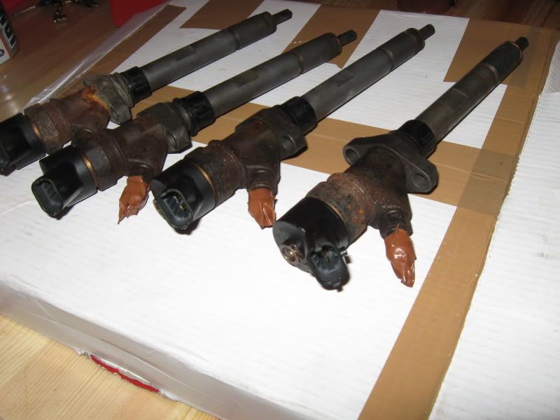

So I bought a 2nd hand set from Ade on the coupe forum. Came from a lowish mileage coupe that shed its cambelt, he was surprised to find these came out easily & reckons they couldn't have been in there long.
Started soaking mine in WD40 on Sunday, 2nd dose tonight, plan to do this daily until I try to shift them.
Off work next week, so wish me luck folks.....

Good luck getting them out doggy hope they turn out easier to remove than
you thought they would be , watching this thread with interest . Piccies
please when you do them .
