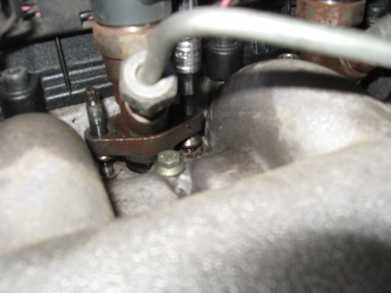

Intended attaching TMOASH via 2 lengths of 8mm studding with nuts under the clamping yoke previously pictured on the replacement injectors, I somehow managed to overlook the blindingly obvious fact that there are already two 7 mm studs screwed into the head to clamp said yoke & hence injector in place.
In a fleeting moment of optimism, I decided to unscrew one of the studs - surely it must pass through the yoke? They wouldn't design something you couldn't get out with the injector in place, would they?
Now the studs are helpfully not threaded all the way to the top - the last 5 mm or so is splined, so you can easily insert / remove them, yes?
No. Cos I don't happen to have any inside-out torx sockets. :evil: Maybe a 5 mm hexagon socket? Non! All this suceeded in doing was rounding the splines off a bit. :frown: 3/16 socket? Nope, now it's properly rogered. :cry: Not having the common sense to give up & drink beer, I set about the stud on the other side of No. 4 injector, giving it a firm tap before trying to turn it and mugger be, it moved! :o

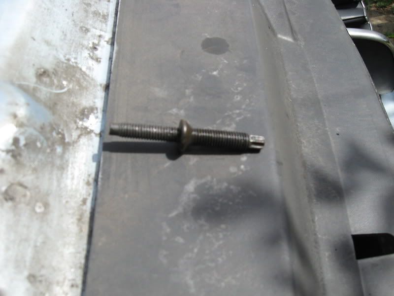

I unscrewed it a but further, and sure enough Peugeot in their wisdom have fashioned the studs with a 10 mm or so diameter 'bulge' in the middle to ensure even their techies cant actually tighten it all the way into the combustion chamber.
Needless to say, there is no chance this'll pass through the 8.5 mm hole in the yoke..... Ah well, in for a penny.... Unscrewed it until the 'bulge' made contact with the yoke & started to lift it, (no real surprise, the yoke can 'float' up down the casing by a mm. or two), went a tad further and the injector moved! :shock:
A bit more, yes! it's definitely sliding virtually effortlessly out of the head. :P Piccy below shows one of the injectors, 'extracted' by about 3 mm. by the stud to the left of the injector, the one on the right shows the 'bulge' halfway between head & yoke.
I tried all 4 - they all started to slide out with litte effort, just turning the stud, with a 1/4 drive socket extension, the kind with a screwdriver-like handle on it.

They all came out dead easily, only No. 1 put up anything of a fight - I jacked it out by unscrewing one of the studs, (pictured below), all the way, then manage to pull & twist it out by hand.

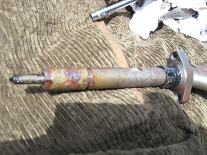

They looked a bit grotty, (see below), but nothing obviously amiss.
No.1 & No.4 ,(pictured above), had some slight rusting of the anodised outer shell as you can see, 2 & 3 looked like new. The gunge at the tip is a mixture of WD40 & carbon deposits.
