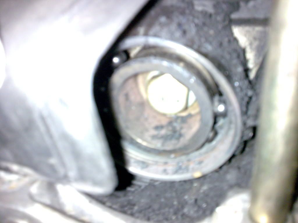

dont have the engine out the car as yet am striping it down to the block as am getting all the good bits off for spears i will upload some others of what i have done so far my pc is being a nob
