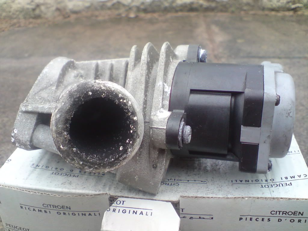

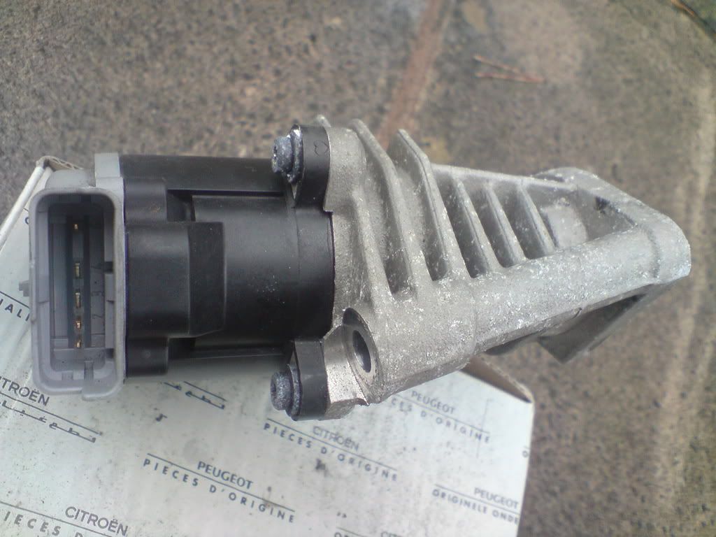

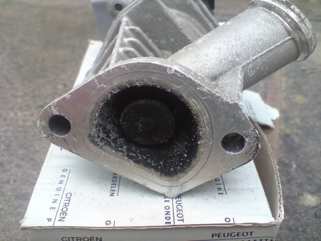

Re: 2001 406 EXEC HPI 2.0 EGR problem

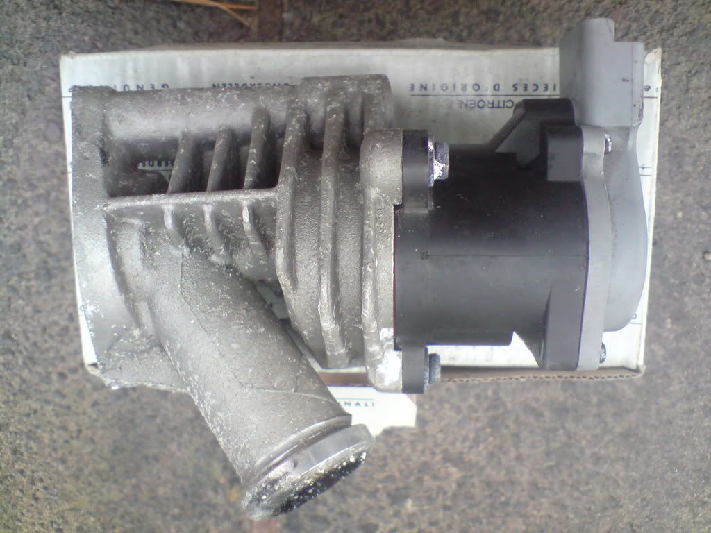

Doesn't look hard to get to, couple of bolts and a miltiplug by the look of things. I've got my old one in the garage, not sure if it's knackered or just dirty, you know what main stealers are like. I've got some pics of it somewhere I can post up if you think it might help?

Yes please that would b a great help! as i havent a clue what im looking for lol. Im hoping a clean will do it!
Thanks! :)

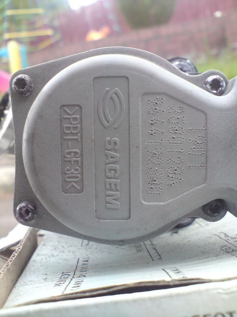

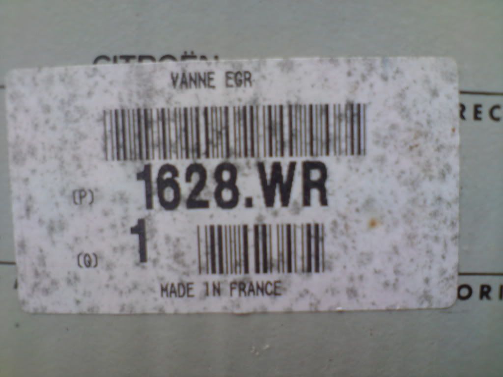

Here ya go mate..
Post by johnboy »
Wow that was quick! Cheers for that ill have a look tommorow, at least i got the part number too so can have a look about if the clean dosent work!
Thanks again! :)
