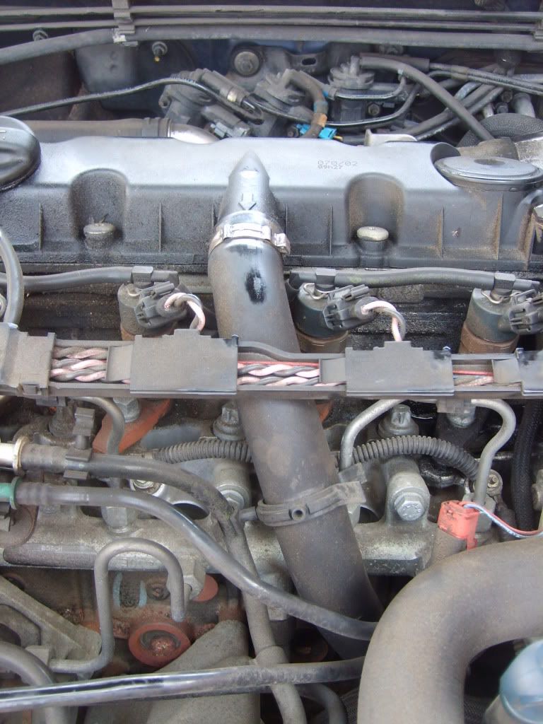

nope still does it
but the pipe that comes from the rocker to the block seems to be very hard but not sure if it is meant to be
hopefully someone can tell if it is a breather pipe that might be blocked and whether this could resolve the anti pollution fault

Any chance of a pic of this pipe?
Re: back pressure and engine managment light
here is the picture of the pipe
That's a fairly large pipe, quite hard to block I would have thought. Still, if you suspect it then whip it off and have a look. You'll have to cut the old clips off and replace with a couple of jubilees. There's also a pipe from the end of the rocker cover to the inlet - #2 here:
Might be worth investigating too.
I think these pipes are a plastic reinforced with some sort of fibre, so it's also possible they can separate inside and block up that way.

i looked at the smaller pipe at the back and it doesnt seem to have a great seal also it seems to have been shortened at some stage and has tie-raps holding it so im going to take that of and possibly renew it do i use jubilee clips instead of ties ?
I reckon they'd be more secure.
