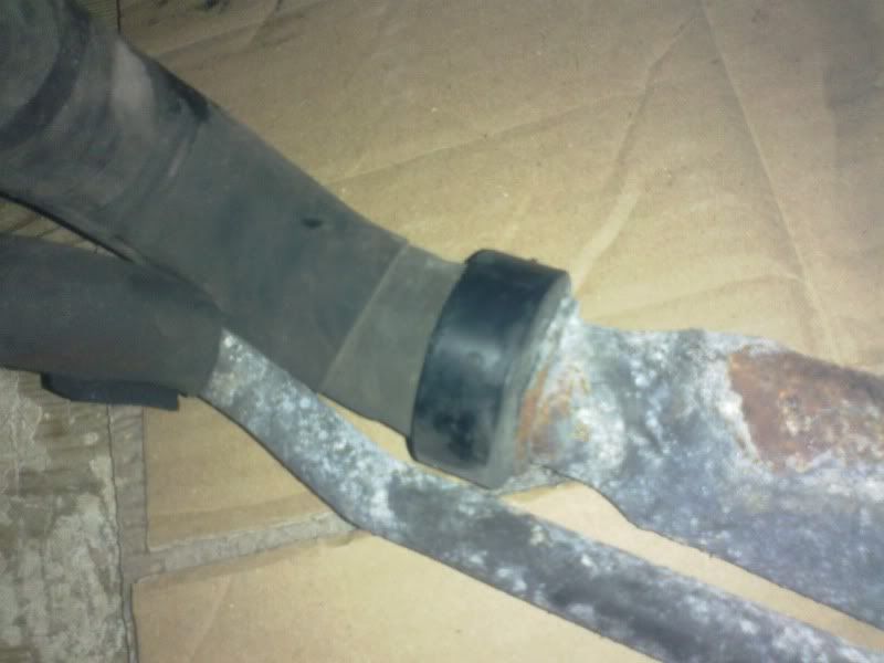

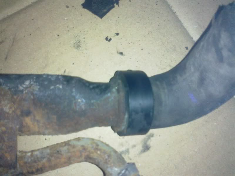

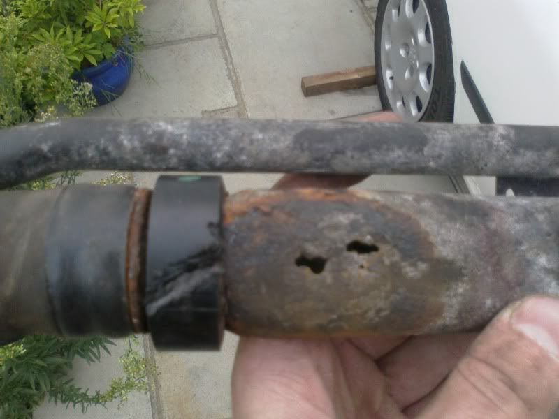

i found the source of the coolant leak and i now have a replacement £4 from a scrap yard
But as always peugeot design must go against nature and be ridiculous so the BIG question is how to remove the seal?? It wont screw or pull off
I know its rusty but there's no holes so a night of being soaked in vinegar will cure that

I don't think you'll get it apart, the bottom hose comes as one piece!

I feared someone would say that ha. There was a full piece at the scrap yard but some guy came over saying he had bought the car and i couldn't be asked to argue. What are my options? Find a different scrap yard or order a new one from peugeot (can you do that)?

Its fixed!!!!!!!!! with a load of patience, my step dad and his mate and a load of jubilee clips. I don't have a photo of the finished piece but thats not what matters. We hacksawed of the unbreakable plastic clip and jubilled them on. This pipes now long gone
Thanks for all the help guys. Oh and the grand total for fixing came to £11.51
