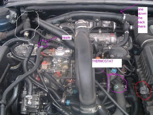

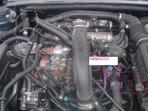

ok is it a 1996 1.9 ?? your title is a little confusing as there wasnt a HDi in 1996 car
possibly the thermostat, its worth doing 1st as its only about 8 quid,
make sure you buy some anti freeze to top it back up, get about 3 litres wen u buy thermostat
and make sure you bleed the system ,, its very easy so dont get worried
heres a picture for you if it is 1.9 just remove the 3 bolts and it sits under the fuel filter

bleed nipples here, but once you have topped up the coolant leave the coolant cap off the main housing and press the pipes around the radiotor gently , you will see all the air come out you can also feel it in the pipes. keep pressing for a good few minutes
