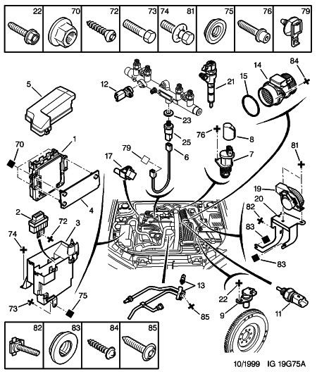

I have a 406 2.0 HDI diesel it theres no boost( engine 2200 rpm max only). Check faulty code - P0238 - MAP sensor error. Where is the MAP sensor on my car ?

Hi markoni & welcome to the site.
I'm not sure, but your car may not have a MAP sensor as the turbo boost is controlled mechanically on the HDi 90, (110 & 136 models have electronic boost control) I think
This is the sensor layout for an HDi 90 / Bosch system, (Newer 90's have Siemens systems), but neither has a corresponding sensor to the other HDi's.
Someone else may know better, please comment if you do.

The 110 has a pressure sensor on the intercooler but the 90 doesn't have either an intercooler or pressure sensor. Searching with p0238 definitely comes back with turbo pressure sensor, despite the car's apparent lack of one. Off for some research...

Wouldn't this fault be to do with the vacuum solenoid on the bulkhead? maybe it has dropped the boost and the wastegate has defaulted to wide open?

This is driving me nuts, it's definitely too high turbo pressure but I can't see how it would know about it if it has no pressure sensor
As Welly says, the bit that controls the wastegate on the turbo is the vacuum solenoid up on the bulkhead - check the tiny filter on the bottom of the vacuum solenoid up on the bulkhead for being blocked up and check the vacuum pipes for damage/falling off. To test it will need vacuum gages etc. Other than that, the wastegate could be damaged/stuck. I hate this, this is ignoring the fact that the ECU is using telepathy to detect the fault

That's true on a 110 - but I thought a 90 had one less solenoid valve and a mechanical pressure regulator.steve_earwig wrote:As Welly says, the bit that controls the wastegate on the turbo is the vacuum solenoid up on the bulkhead
(FWIW the 136 doesn't do it this way either cos of the V/G turbo).

dogslife wrote:That's true on a 110 - but I thought a 90 had one less solenoid valve and a mechanical pressure regulator.steve_earwig wrote:As Welly says, the bit that controls the wastegate on the turbo is the vacuum solenoid up on the bulkhead
Re: no boost 2.0 HDI 90HP
The MAP sensor is on position 14 in the drawing send by Dogslife. It is measuring the airflow going into the engine and the amount of injected diesel fuel can be corrected by this measurement. These senors have a limited lifetime, I'de to replace mine as well.
