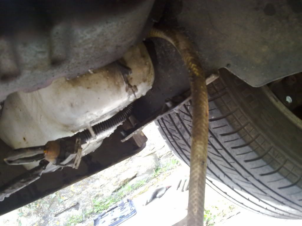

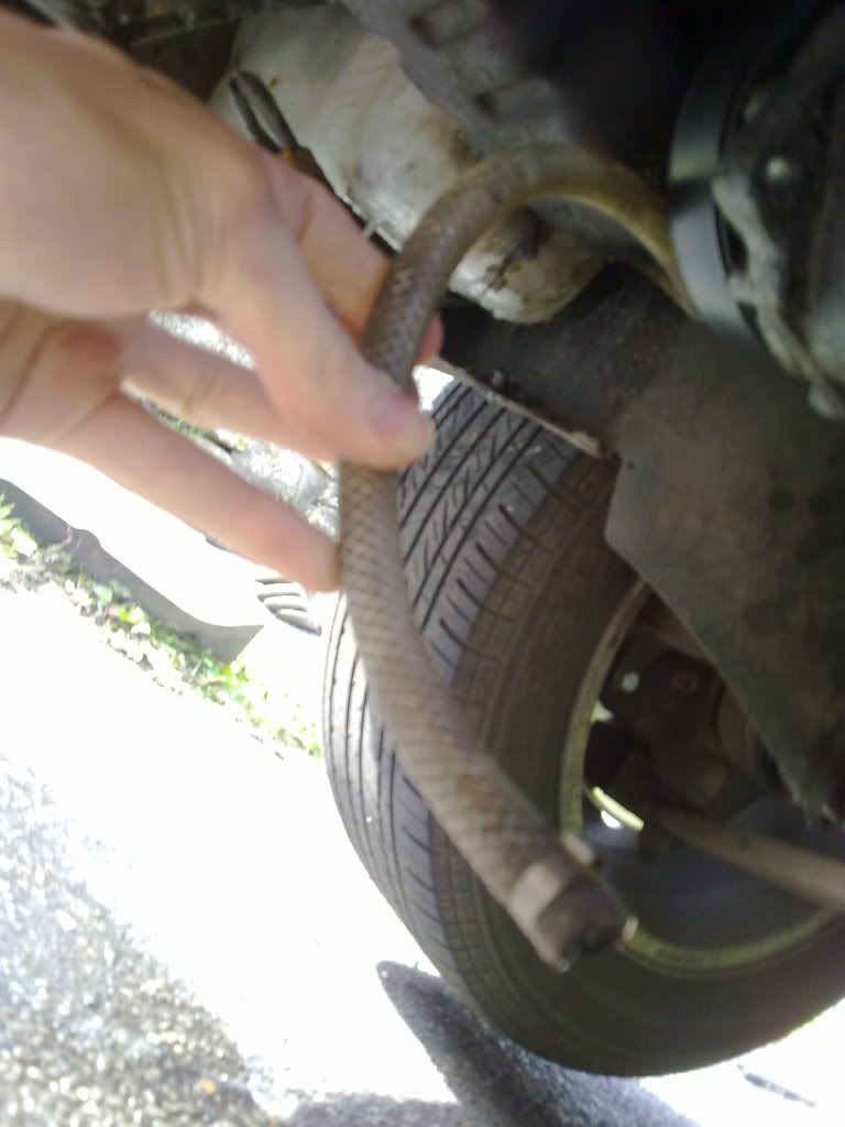

right i took the guard off underneath and had a look under the washer bottle but i cant see where the leak is coming from, maybe its the bottle cracked from when its frozen from just having water with no de icer? also there is a hose hanging that has come off somewhere, think it joins onto a set of 2 hoses but not sure what it does?
Re: window washer system is leaking
oh and my sri has headlight washers but they havent worked since i had the car, saw them work on the test drive but not since, should they come on when you have the headlights on and squirt the windows? maybe this is causing a leak?
Re: window washer system is leaking PICS
That does have a distinct broken off look to it. I dunno how the headlamp washers work but if that's broken off the pump then perhaps the sceeenwash is running out through the pump.

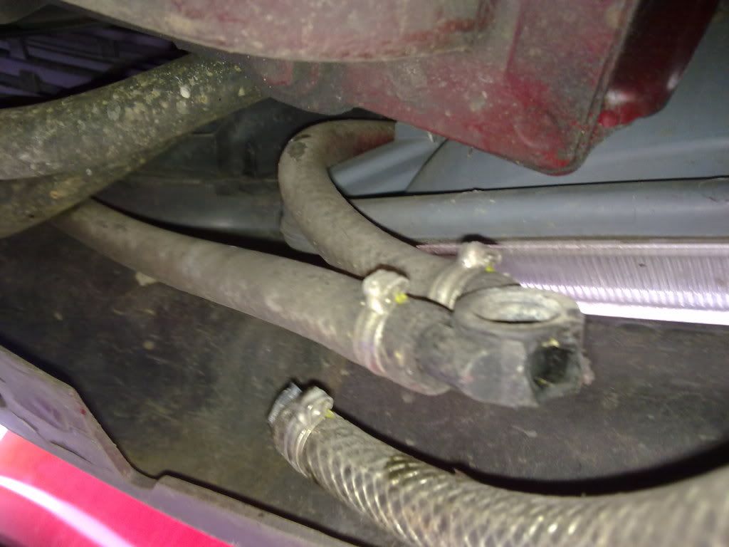

i can see what its snapped off of, but i dunno what it all does? theres 2 pipes near the radiator and this pipe looks like it tees on to it, 2 into 1 sort of thing, anyone know?

this is it:
but its not coming from the pipe thats hanging or from the broken join
Any use?
not sure if the adapter in my last pic is for the headlamps? whatever it is for thats what the dangling hose has snapped off of, but the water isnt leaking from there
the seals most probs perished,
number 5 on the the pic above

and that pipe is for your headlight washers but if its broke it will drain your water bottle so a cheap option is to block it off.
