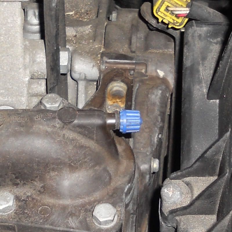

Is this the bit you are talking about - The blue bit is the bleed screw
Re: engine overheat
no its not that , its back towards the back of car from that

Hiya oxy,
ive had a look on mine today, and iknow what you mean now,
your thermostat housing will be the Alloy type not plastic,
the part missing will be a Brass head type bleed screw, with a alan key type head ,
Do not block up the hole the Bleed screw is needed, withought that youve no way of getting air out of the pipes and potentialy cook your head gasket !
grab one from a scrap yard best bet ithink,
