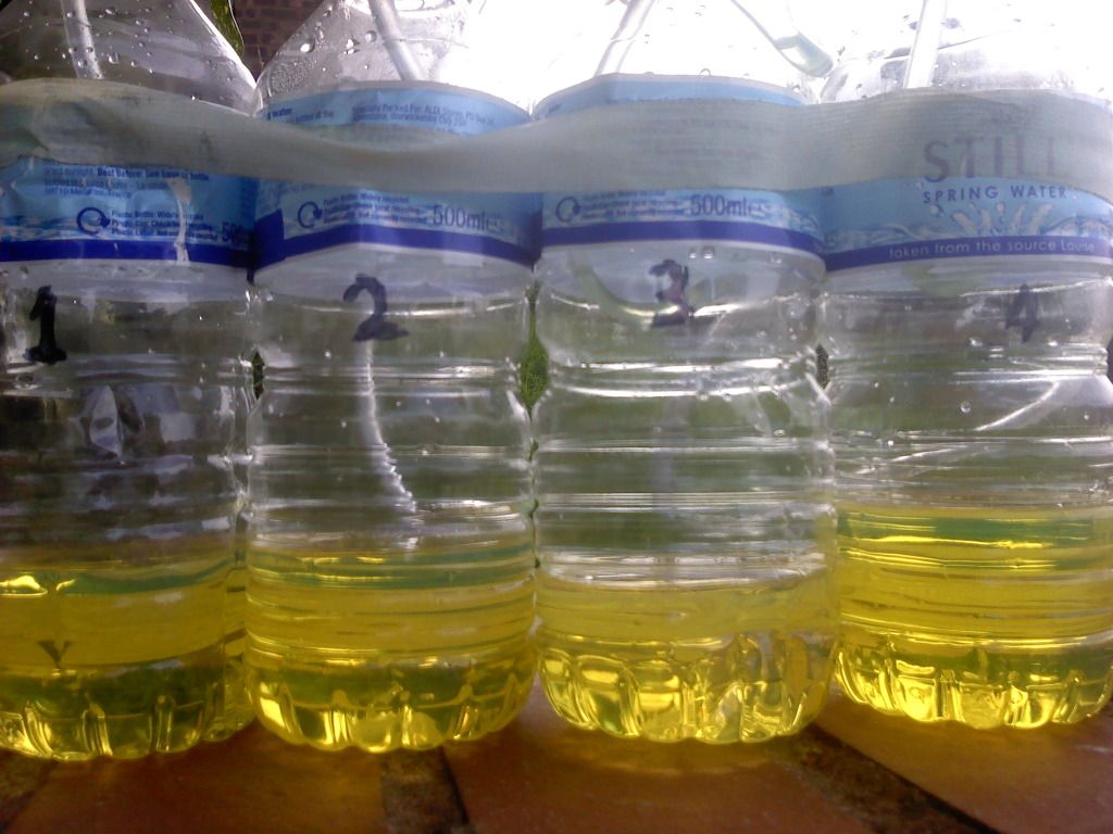

Decided to do the spill test today...
Labled them as 1 being the belt side of the engine...
1 and 2 are very similar so I'm happy with them, 3 is close'ish... but 4 is quite a bit different. Think it may be the first to get changed, but then again number 3 :? :? :?
