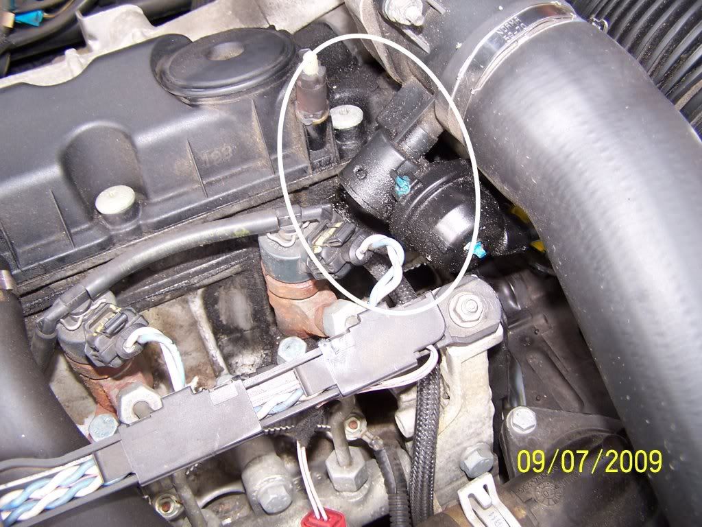

You sure it's not your air doser leaking? My original gasket wasn't leaking in the end, but it was good to eliminate it.
Re: Rocker cover gasket
Whats the air doser? Is that the thing that looks like a crankshaft breather pipe on the side of the engine?
The circled bit...
mine was leaking there too--gave the impression was the rocker cover gasket but was actually leaking from the air doser.
Take it off--two 10mm nuts I seem to remember then I put plenty of gasket sealer around it and bolted back on--oil never came back.
But that pipe isnt it the one coming from the intercooler going to the intake manifold, should it be leaking oil? Or is the doser itself actuated by oil pressure, the pipe going to it looks more like a vacuum line.
There's always a bit of oil in the intercooler, so oil just leaks from the butterfly hinge ..thing.
