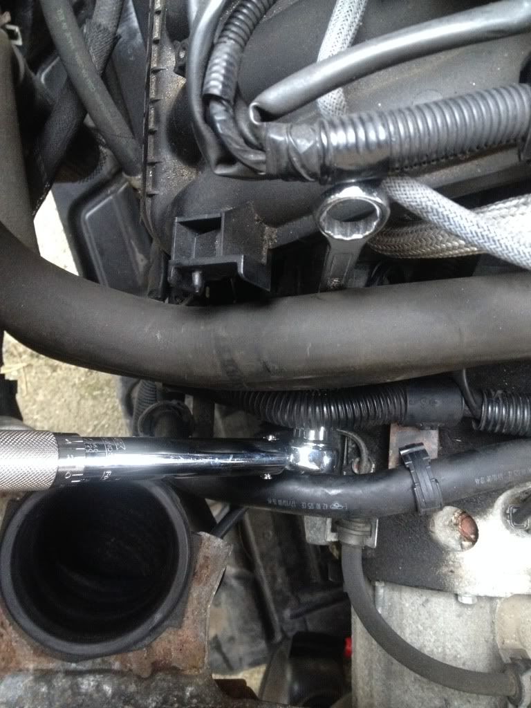

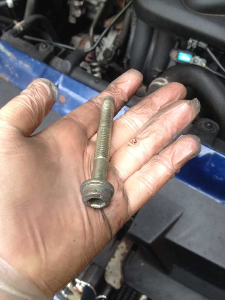

Now, I have removed 1 x 8mm hex bolt.

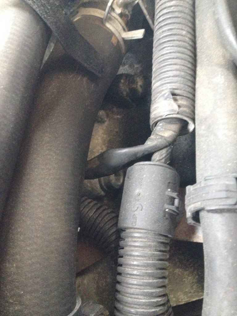

I have found the earth connection which has 2 nuts and do you think I can get that off without the earth strap coming with the bolt?
I have put a spanner in to hold the other nut in place whilst trying to un-do it and still it won't move, even with a healthy dose of WD40.

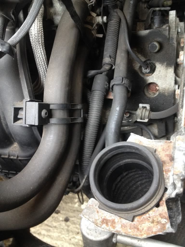

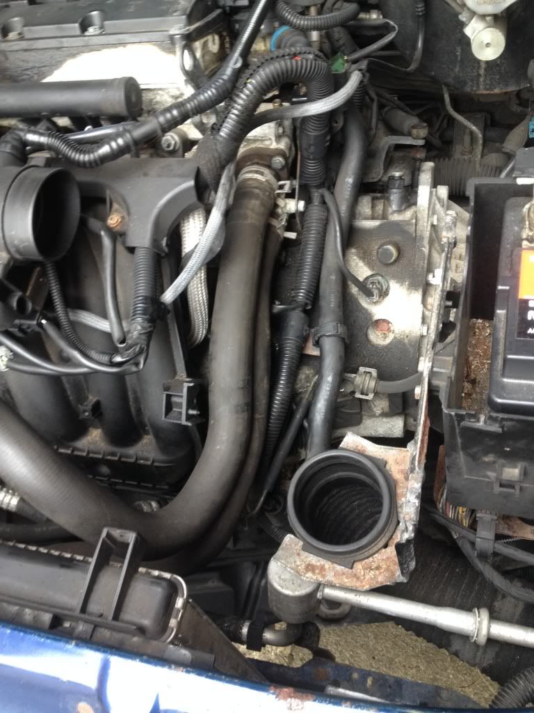

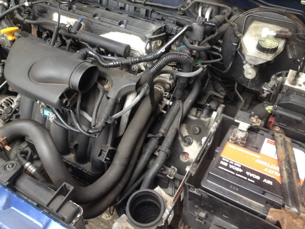

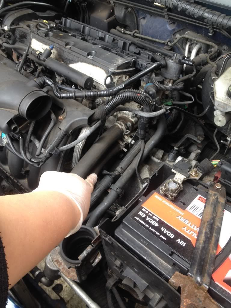

Here are a few photos of todays progress.

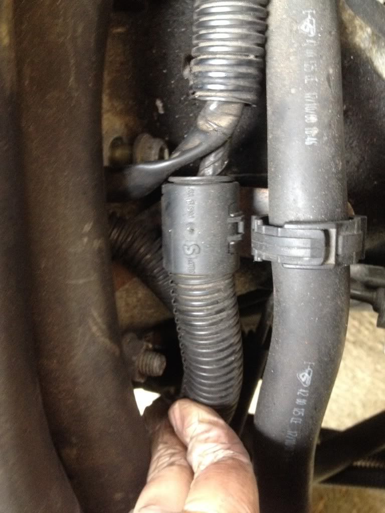

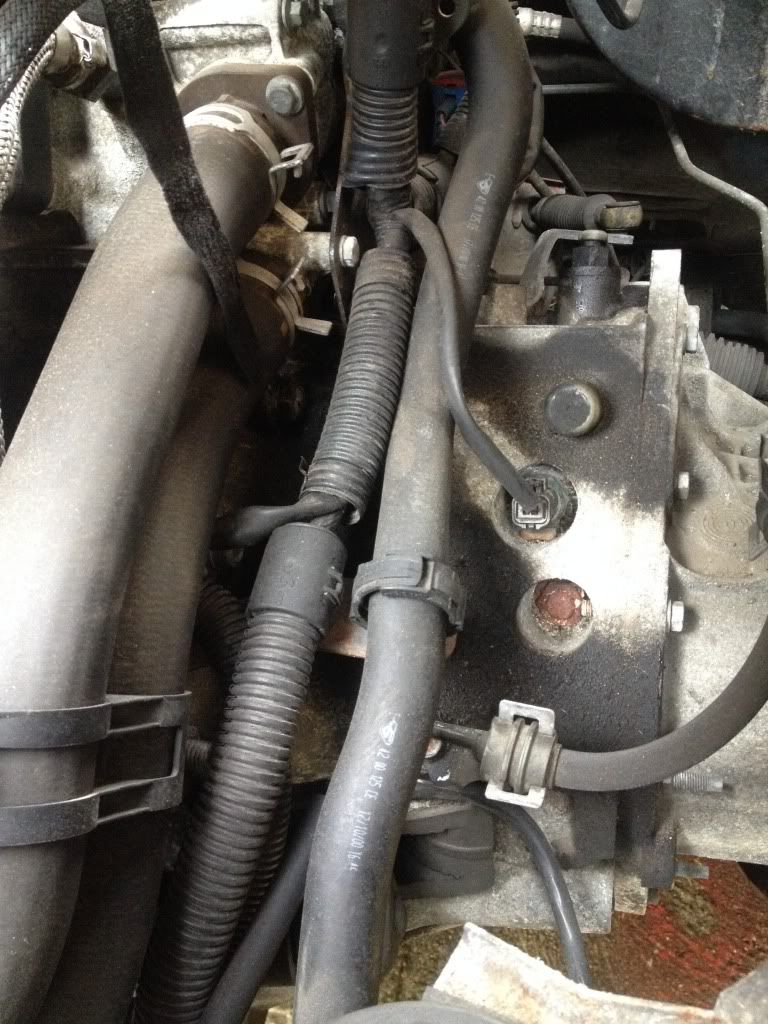

As you can see, access is a bitch....
Pointing for good measure (this was to point to Jasper5 where I thought it was...)
Earth bolt:
1 down:
View from underneath the car:
Any advice on how to separate those nuts so I can take that bolt out without the earth wire spinning around with the bolt?

Sounds as if the starter is really knocking the stuffing out of your battery :shock:
Can you disconnect the earth trap the other end, so it doesn't matter if it spins?

steve_earwig wrote:Sounds as if the starter is really knocking the stuffing out of your battery :shock:
Yep, battery is taking a right beating!
You mean disconnect it off of the battery? Good idea, could try that couldn't I?

Re: Starter Motor access
Post by crackpotterpig »
yea disconnect it at the battery, and remove it with the starter motor as you take it out then you can remove it and refit it onto the new starter.

crackpotterpig wrote:yea disconnect it at the battery, and remove it with the starter motor as you take it out then you can remove it and refit it onto the new starter.
