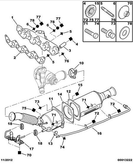

The additive tank is bolted underneath the fuel tank on the passenger side, #15 in the below. It's held on by a retaining bracket which unbolts on one side and then unclips from the other. It holds about 5 litres when full, but could be completely empty. Mine had just been topped up by the (unknowing) previous owners. Costs about £30/litre that stuff!
I can't remember the bolt diameter I used to plug them, M4 or M5 perhaps? The electrical connector is on the back of the tank, it just unclips and I tied it out of the way above the fuel tank with a couple of cable ties.
Don't worry, it'll all be very obvious once you're under the car.

jonsowman wrote:The additive tank is bolted underneath the fuel tank on the passenger side, #15 in the below. It's held on by a retaining bracket which unbolts on one side and then unclips from the other. It holds about 5 litres when full, but could be completely empty. Mine had just been topped up by the (unknowing) previous owners. Costs about £30/litre that stuff!
Sounds so easy when you put it like that.. thanks :D
Picture also helped :)
