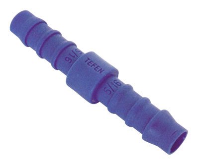

Cutting the rubber tubes and looping them out is the only real answer, you just need a smaller-diameter tube section to fit inside the rubber hose and give you something to clamp down onto. Any solid tubing will do, maybe some nylon piping or steel tube even.
Best would be something like this with raised sections to stop the hose slipping off under pressure.
Firstly though it would be worth checking why the Matrix is leaking, it is a weak point if the system is under too high pressure through over-heating or head gasket failure the matrix can be one of the first parts to feel the strain.
