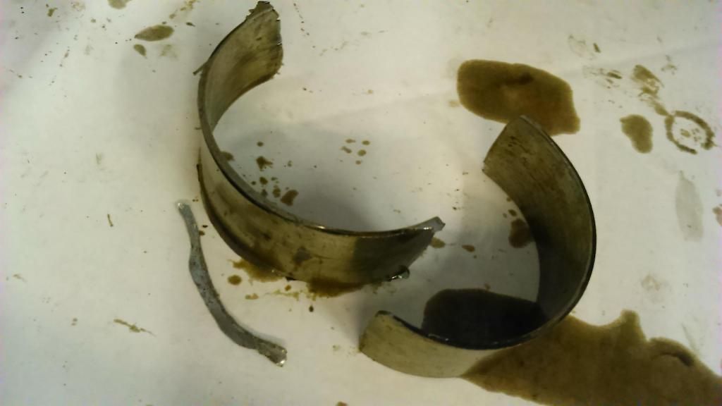

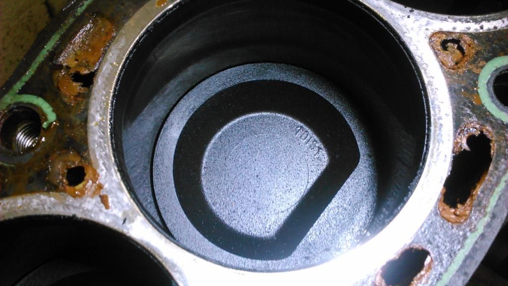

Re: Engine knock

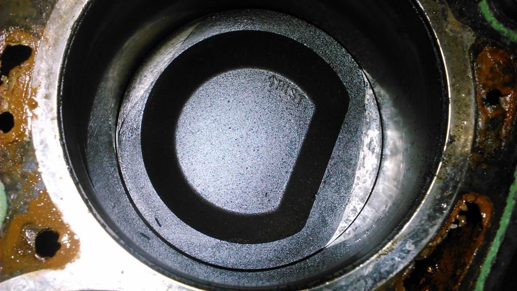

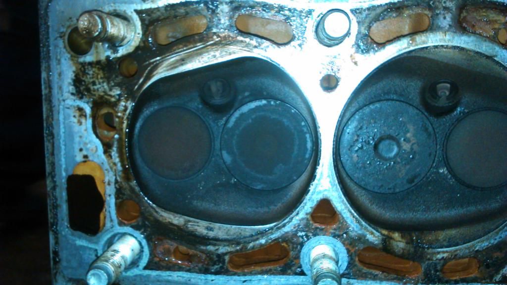

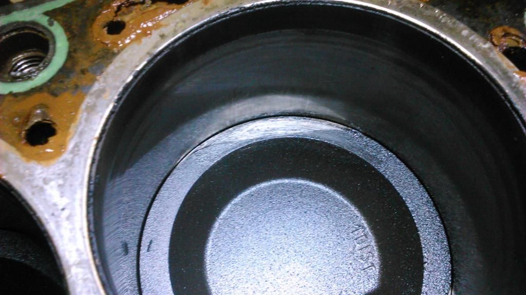

Wee update just for anyone following the thread...
Pulled the head off last night and found what looks like marks from the piston hitting the head. Luckily I think it has only grazed it rather than create a noticeable lip on the head or piston. Il will know better once I clean it up. So bottom bearing is totally f*cked. Hopefully it hasn't damaged the crank.
Re: Engine knock
I can't get my head around that, a piston clashing with the head is weird. The conrod would have to be separated from the crank?
Scratch that, just found some info after a quick search, you can see the same marking on the pistons:

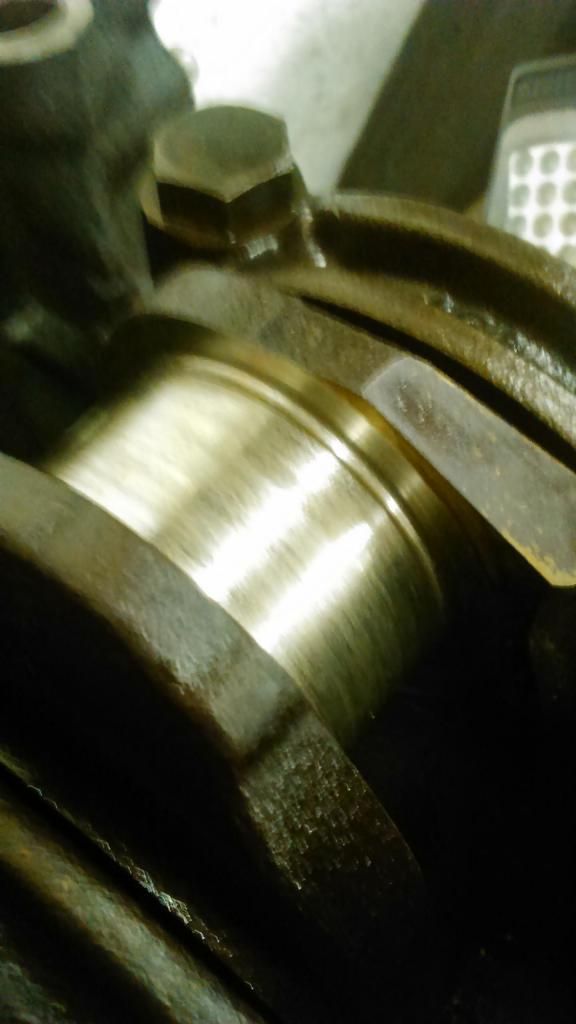

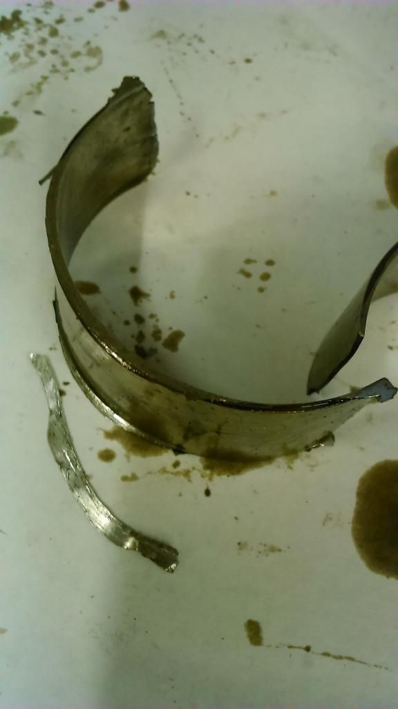

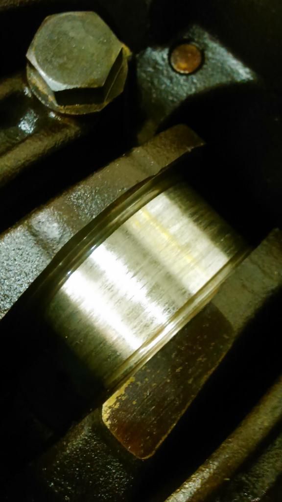

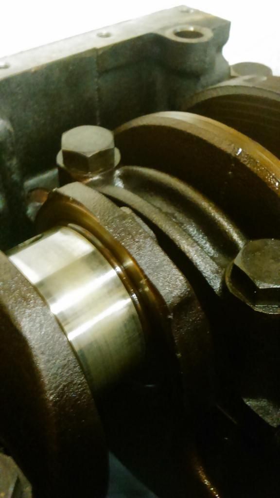

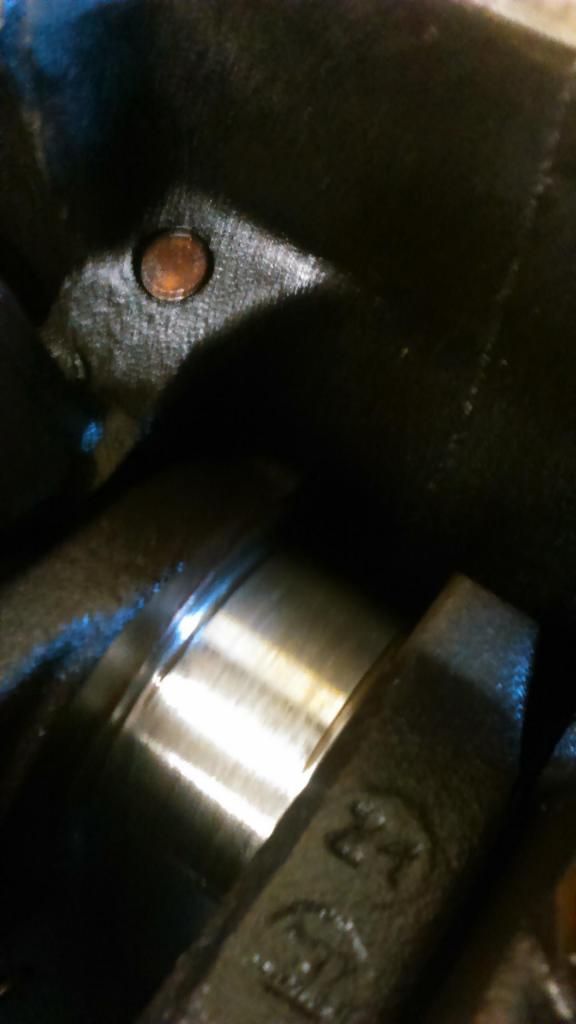

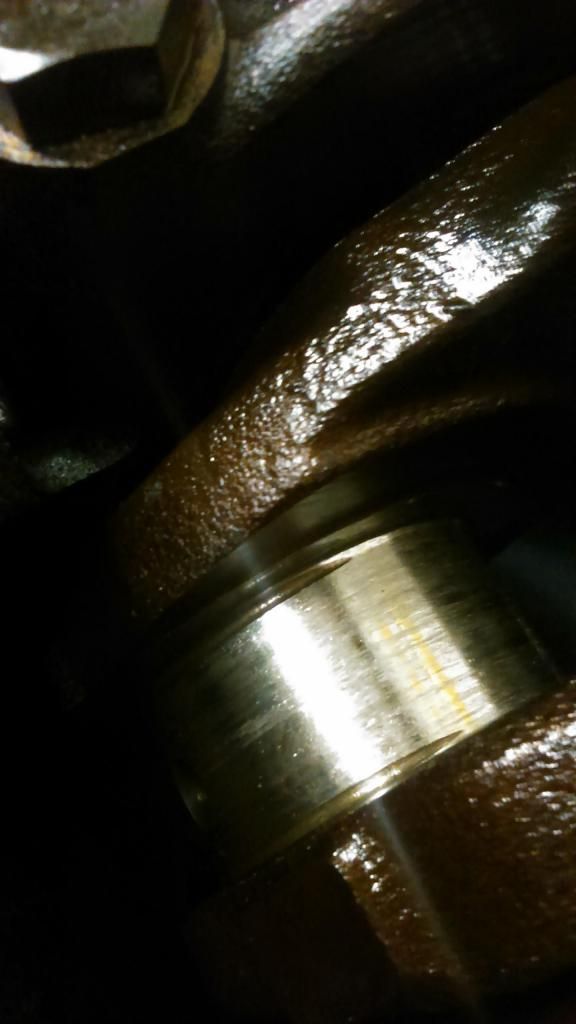

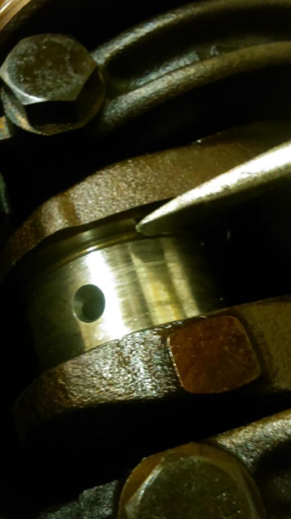

Re: Engine knock
Yep spot on.
Bearings and crank are shot. It looks as if the bearing from the cap ended up under the other one. I'm pretty sure the rod is damaged as well becasue the cap was very difficult to release and then it also needs forcing back together again. You can see how the groove on the crank has been worn away.
Re: Engine knock
Nasty
Had to be the crank with that noise
