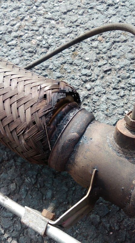

Prior to discovering this I'd had the whole cat/fap and exhaust off to check for leaks. Found this on the cat flexi....
I then hollowed the cat out and blocked one end of it and filled with water to test for leaks but there weren't any. I guess the metal is in order behind the frayed braided section. I am still getting an exhaust smell tho, could that be anything to do with the turbo issue?
