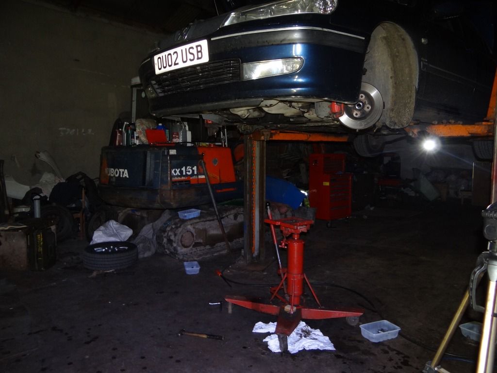

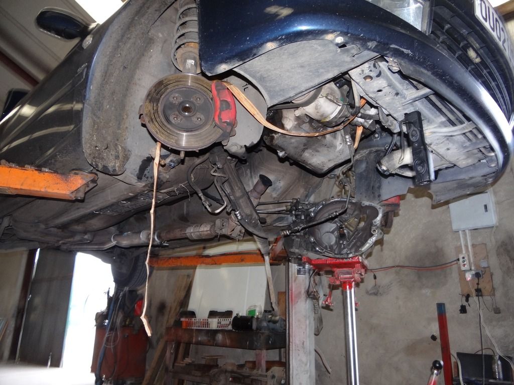

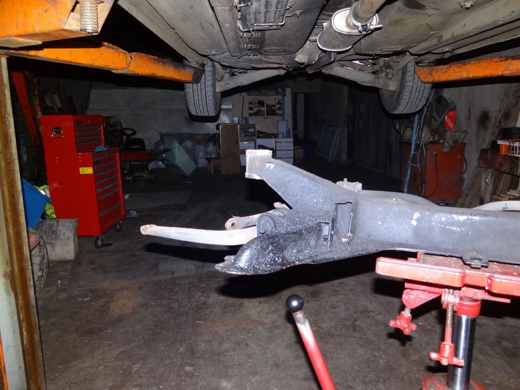

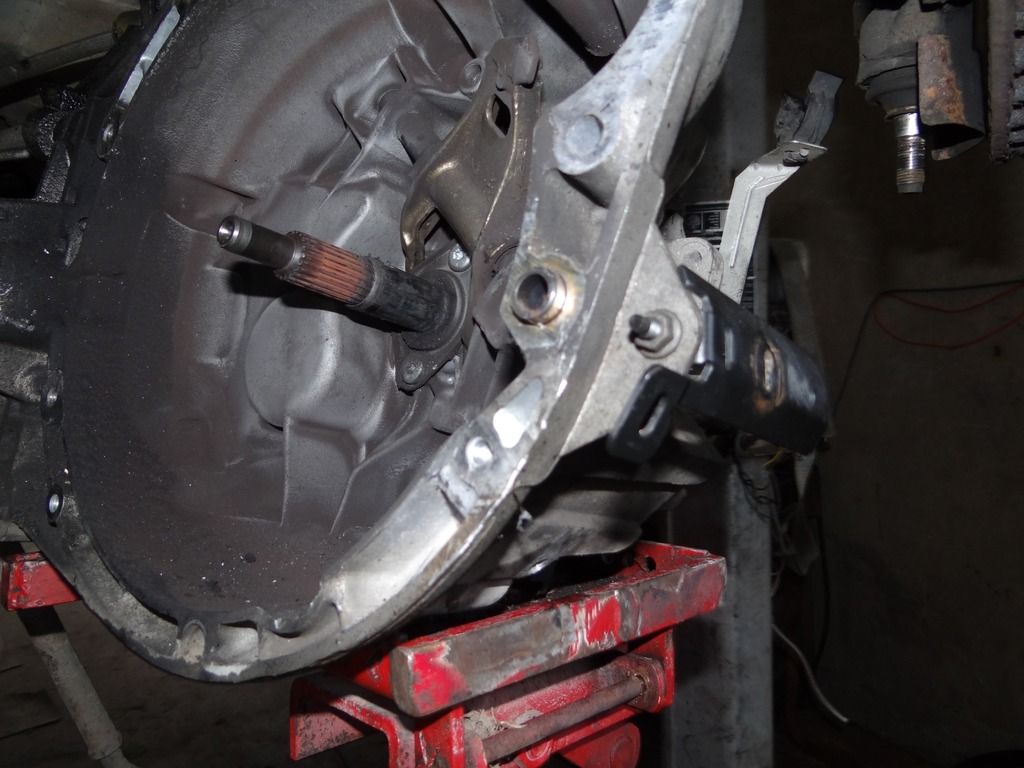

Here are some pics of the job so far, was talking to a chap who breaks 406es not far from here he said to drop the subframe as it only takes about 20 mins extra, fair enough it did. thankfully all 4 bolts came out without the nut breaking loose, although they were rather rusty, might be just as well removing the subframe to get a bit of engine oil/grease mix up into the cavities to stop any rust. It also made getting the rear engine mount looked at, its not completely shot but there is some play in the old one.

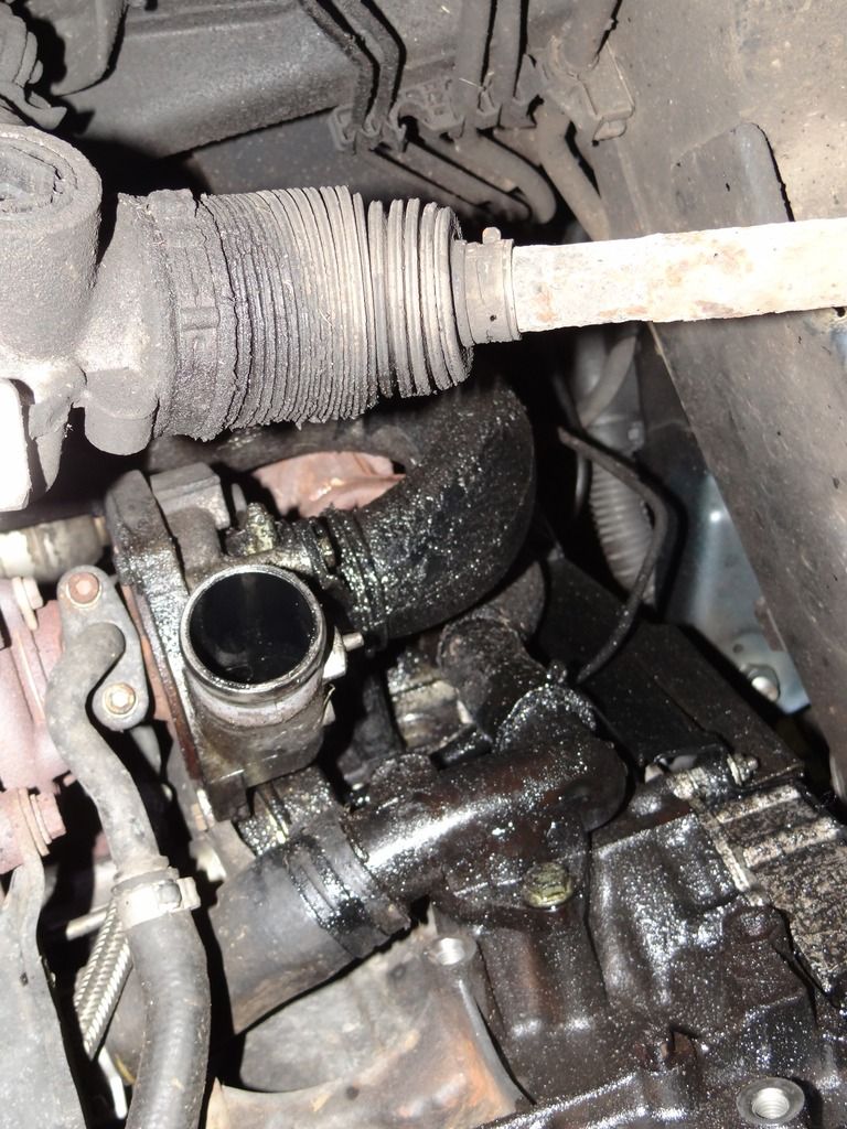

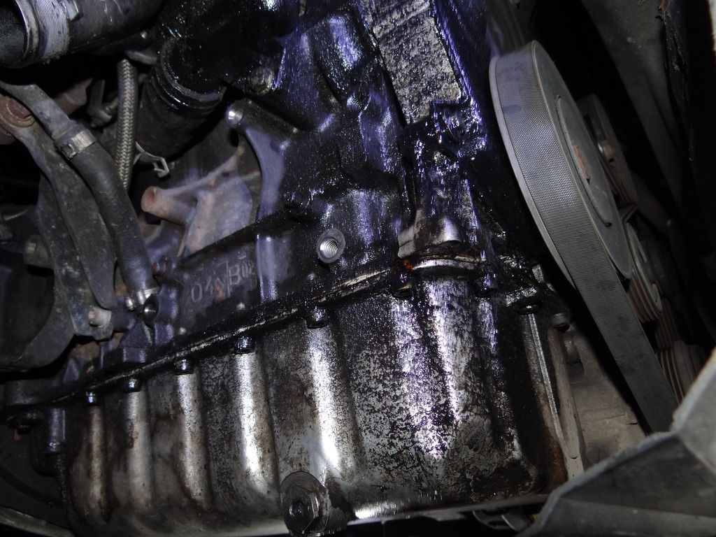

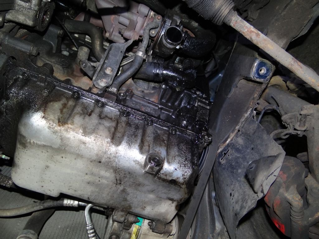

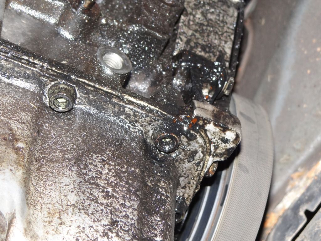

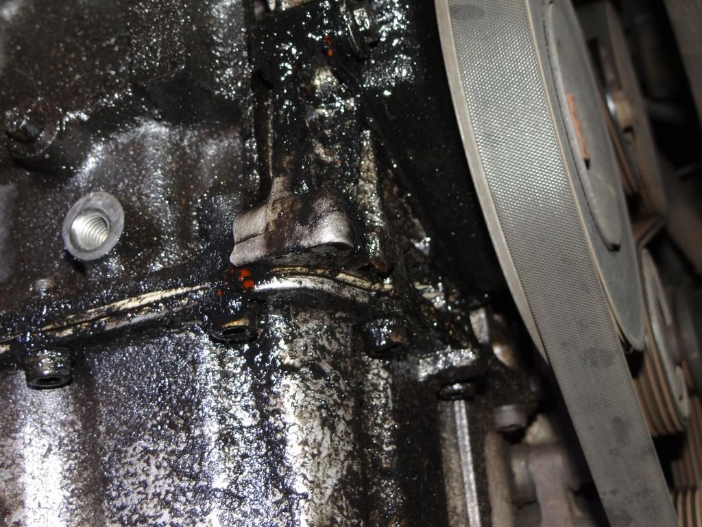

The engine is, and always has been a bit messy around the drivers side, I've never noticed any oil usage between the 10,000 mile change interval but don't like the look of this:
I put a new crankshaft seal into it about 2 years ago when doing the timing belt, and a new water pump. Oil is everywhere, also there are some visible coolant drops.

Argh! So I guess you'll also be doing a cam belt on it too
Any idea where the oil slick's coming from? I suspect that's too much to be left overs from the cam oil seal.

Ill take a look at the cam belt soon enough, im doubting if the oil leaks coming from the crankshaft seal seems to be originating higher than that, its always been a bit oily round here same on my mums xsara. The coolant is a bit more worrying, i think using instant gasket in addition to the gasket that came with the pump may not have been the best idea.

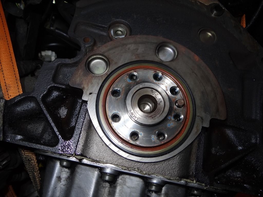

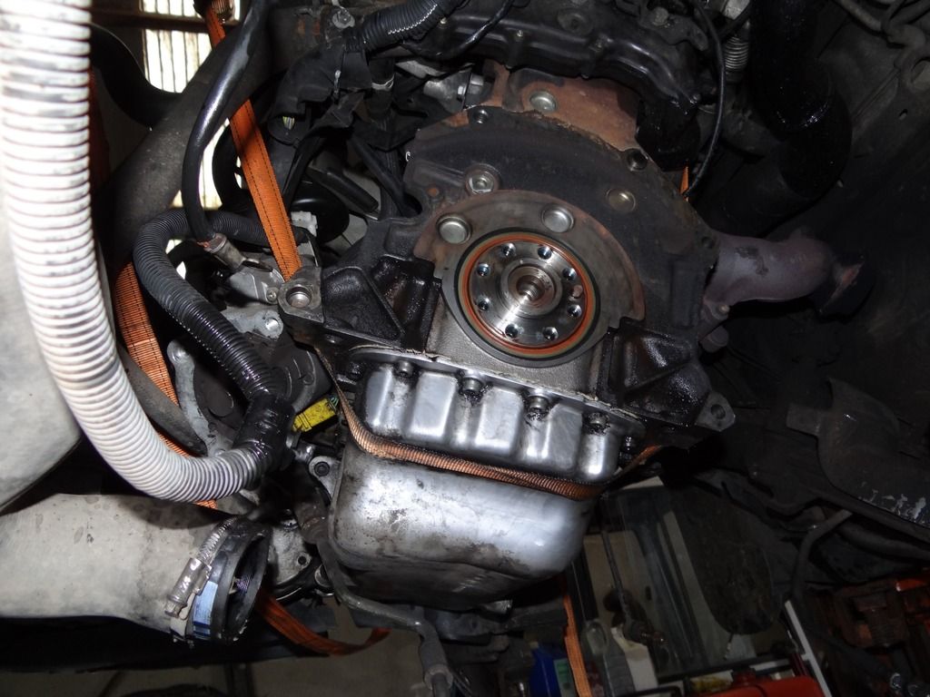

An engine minus the flywheel, i didnt bother changing this seal as it doesnt seem to be leaking

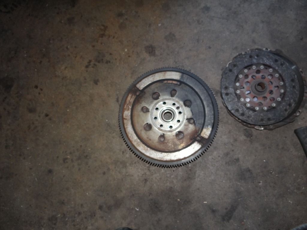

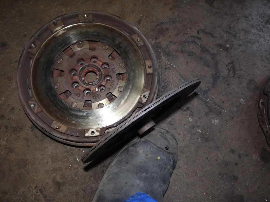

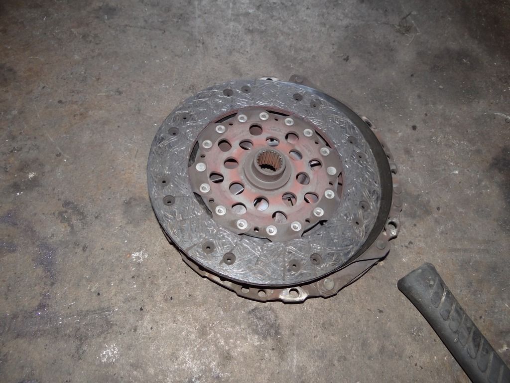

The old clutch and DMF:

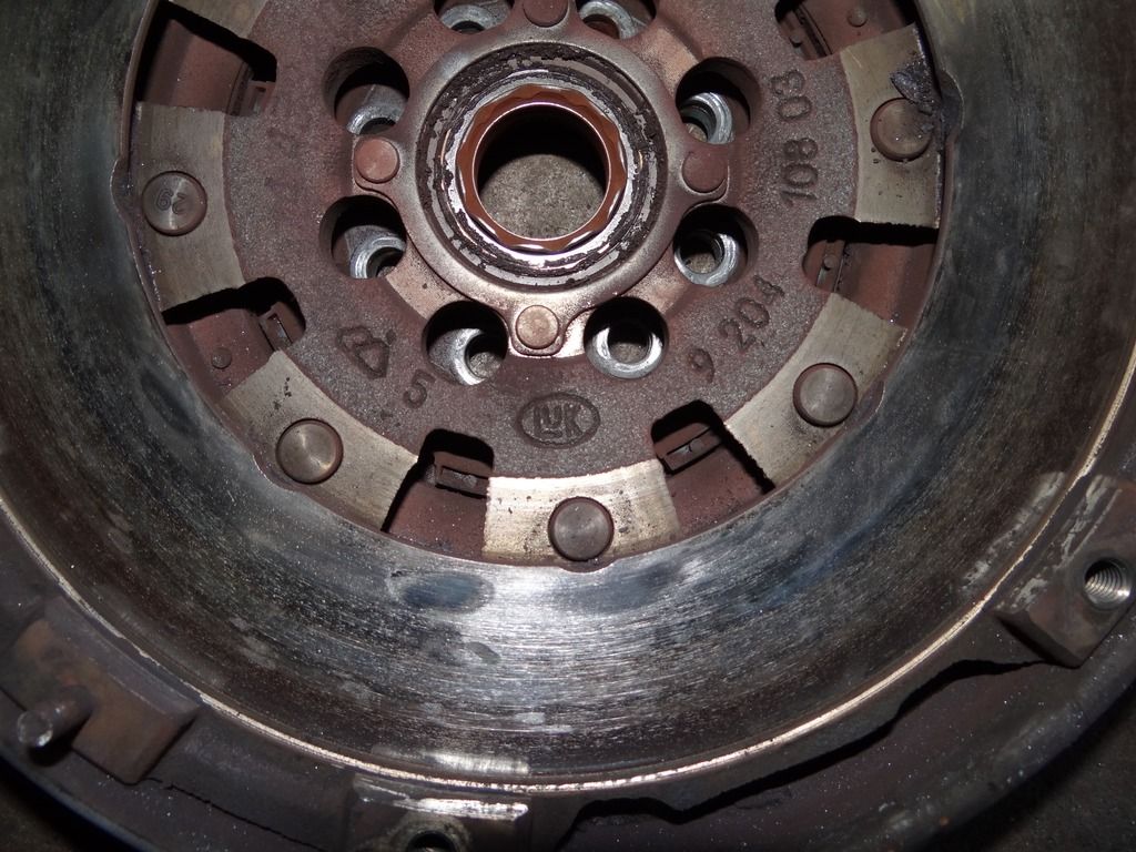

I have fitted a LUK kit, interestingly a LUK flywheel was what had been fitted previously. The question is what was fitted originally to 406es when the left the factory? I always thought Valeo made the clutch kits, it would be good to know if this previous DMF was the original or if it had been changed at some time by the previous owner.
The new clutch in place:

LUK are the original clutch supplier.
