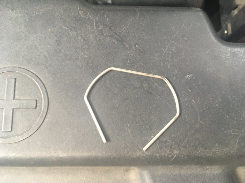

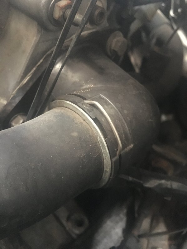

Re: Radiator hose retaining clip
It's not my photo, but I also didn't ask for permission to post on this forum, so...
I just checked on my car (which should have the same kind of engine as you do). If your thermostat housing is still standard (not modified) you should see there's a clip holding the upper radiator hose in place. When I removed that clip, it looked the same as the pictured I posted before.
Picture of thermostat housing with the clip in it:
The clip which I removed from thermostat housing:
The location of thermostat housing if you're confused (image taken from the 'net):
Thanks again Wul for taking trouble to post. I had not registered previously that there was an identical clip on the stat housing...
I am pleased to report, however, that having sent your photo of the clip to my local Peugeot dealership parts department, a more helpfully-minded person there was kind enough to do some searching and has advised me that the clip IS, in fact, still available after all and has ordered me some, delivery expected tomorrow!
It seems that the first person I spoke to either didn't know what I meant, or felt that finding a low-value part for a 25 year old car wasn't worth his while. (I talk to a lot of dealerships in my work and that outlook isn't entirely unfamiliar )
Update for interested parties:
My local Peugeot agency were able to supply necessary clip after I managed to talk to a more helpful person in the parts department as described early.
The clip supplied is part number 133995.
Price about £2.50.
It seems they are still used on modern models.
Once again, many thanks for all replies and assistance.
