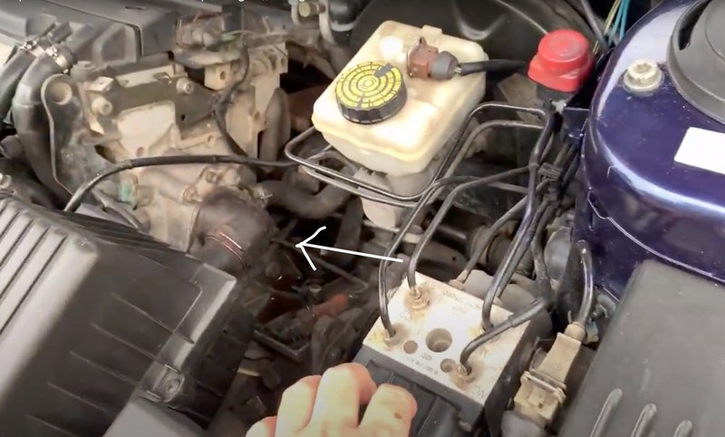

I just checked on my car (which should have the same kind of engine as you do). If your thermostat housing is still standard (not modified) you should see there's a clip holding the upper radiator hose in place. When I removed that clip, it looked the same as the pictured I posted before.
Picture of thermostat housing with the clip in it:
The clip which I removed from thermostat housing:
The location of thermostat housing if you're confused (image taken from the 'net):
