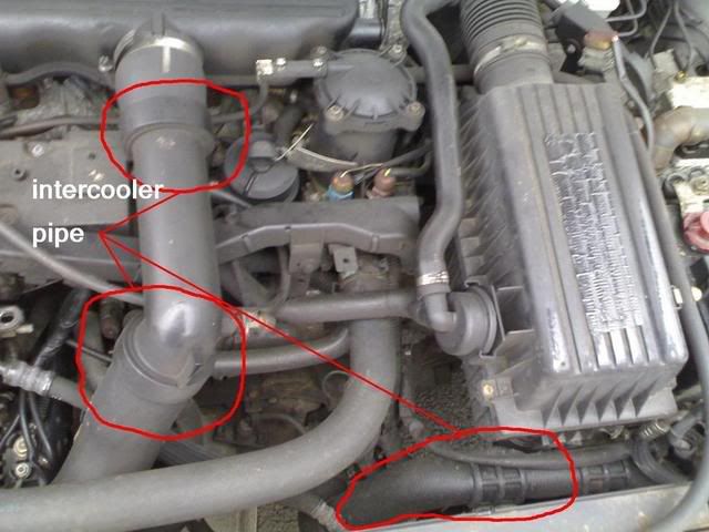

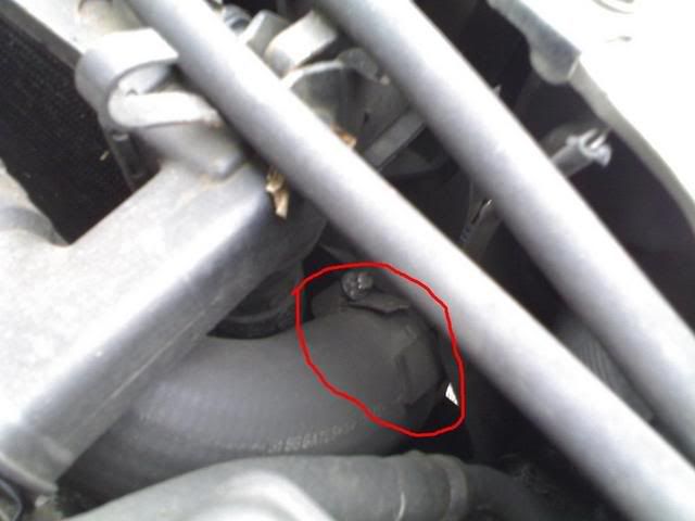

the intercooler is inbetween the rad and the a/c condensor with a thick black pipe on both sides , iv circled them ( badly lol ) in these pics , hope they help
the pipe in the top pic on the right hand side runs under the engine , have a check to make sure it hasnt come off as mine did when i had the clutch done and then it felt like a non turbo untill i done it back up
