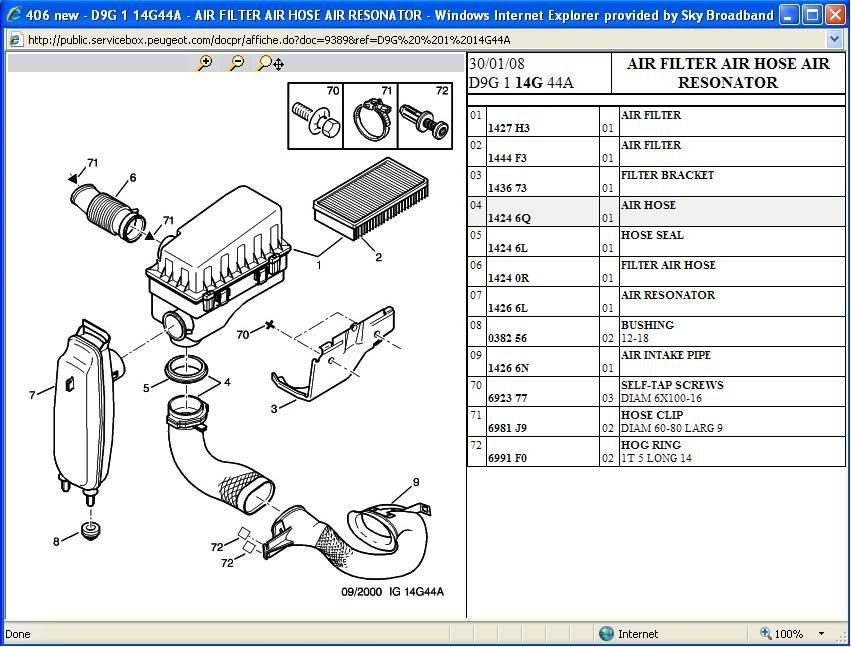

Christ knows, can you find it on Service Box and work backwards?
Re: MAF Sensor
Who knows what they'll call it though. last week I bought a little bit of plastic interior trim from the stealer, pugs description was "plug towball" :roll:
Re: MAF Sensor
if you go on service box and look in air filter for your car all the piping should
come up and it should be part of that :|

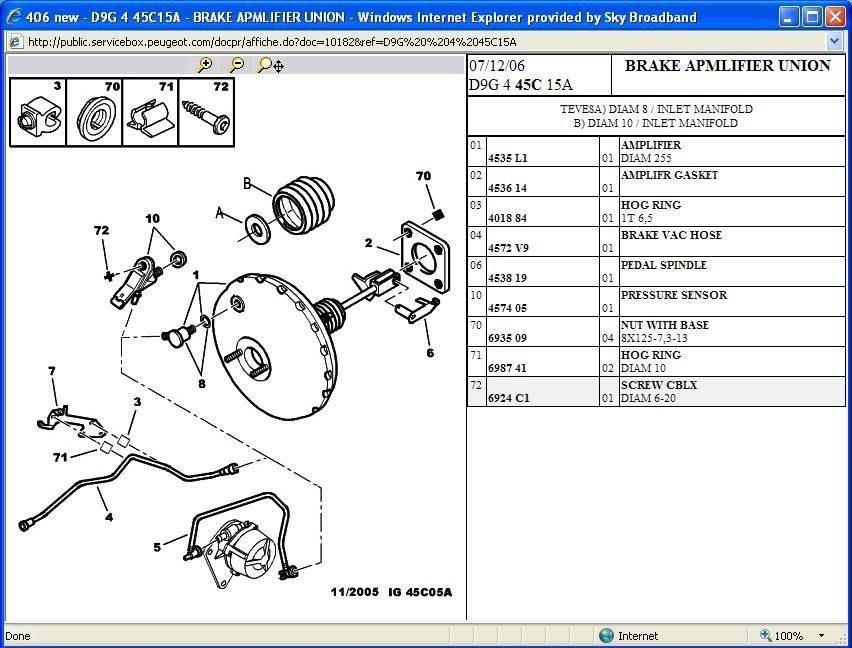

Just been reading a Shitroen forum, (C5 has the same engine) and found this...
Looks suspiciously like something to do with the Air Flow Sensor (or is it an MAP sensor?).
These engines have a MAP sensor,its located in the pipe at the brake servo though.
So now what the hell is a MAP sensor? is that something to do with geography?

Item #10, pressure sensor? :?
Re: Does the HPi have a MAF Sensor?
Your engine doesn't have an air flow meter - it senses manifold pressure (a MAP sensor) it measures absolute pressure and the ECU converts this into an air volume.
They are small sensors, screwed into the inlet manifold somewhere.
