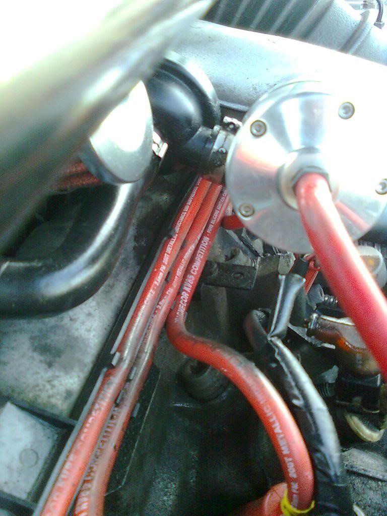

i disconected ''wing filter'' just for few minutes, cause i saw car breathes more easilly... But after that i connected it again. And asked you about changing it ? Or it must be like what ? This evening i'm going to my mates garage and will check whats going on + will make some pictures
