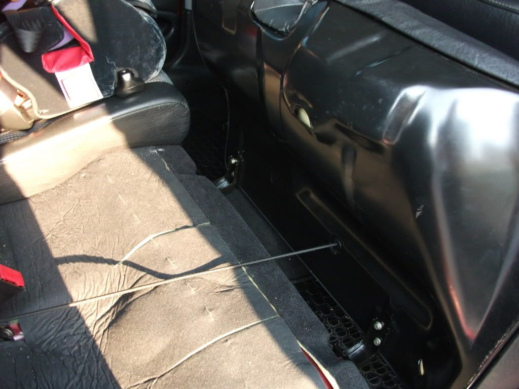

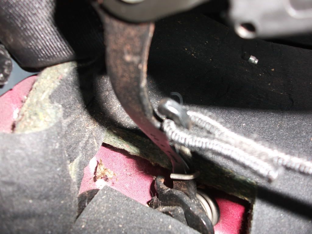

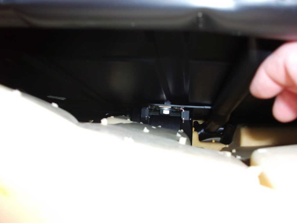

If you're lucky enough to get the bases, the next step is to remove the bases from the car - really easy. You lift up the bases & here is the view:
The black bungee cord simply lifts off of the seatbelt clip:

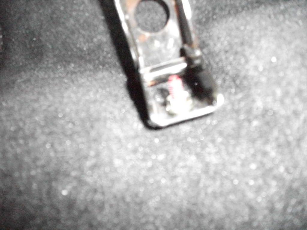

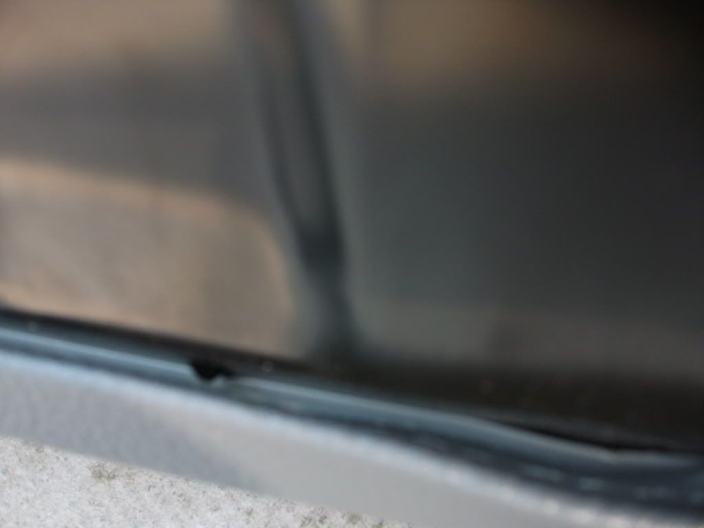

If you look at the front where the hinges for the folding base are, you see these:

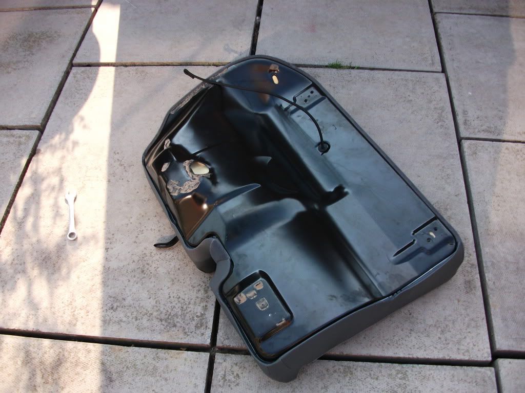

Unscrew the nuts & the base will come straight out:

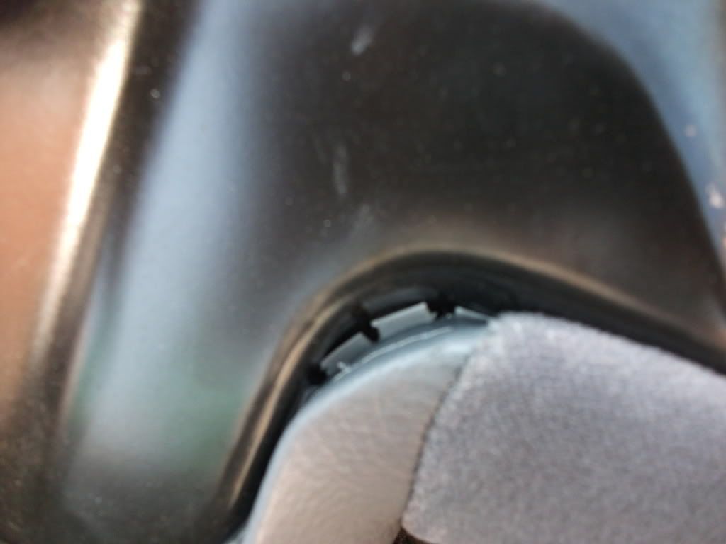

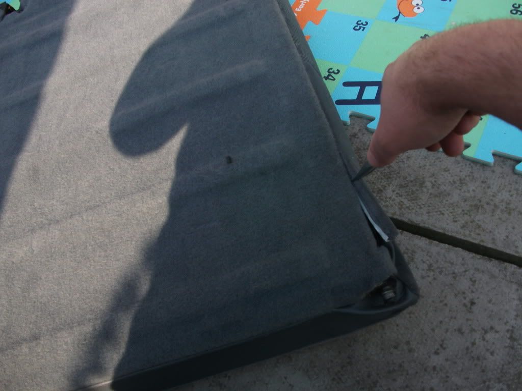

Now we come to removing the metal from the seat. May look scary, but it's really easy. If you look closely around the edges, you'll see this:

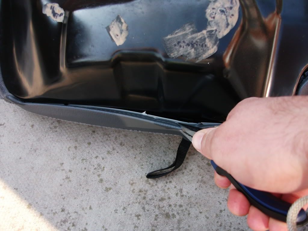

Get some needle nose pliers on there & pull the cloth up carefully, but firmly & work around the whole edge of the metal:

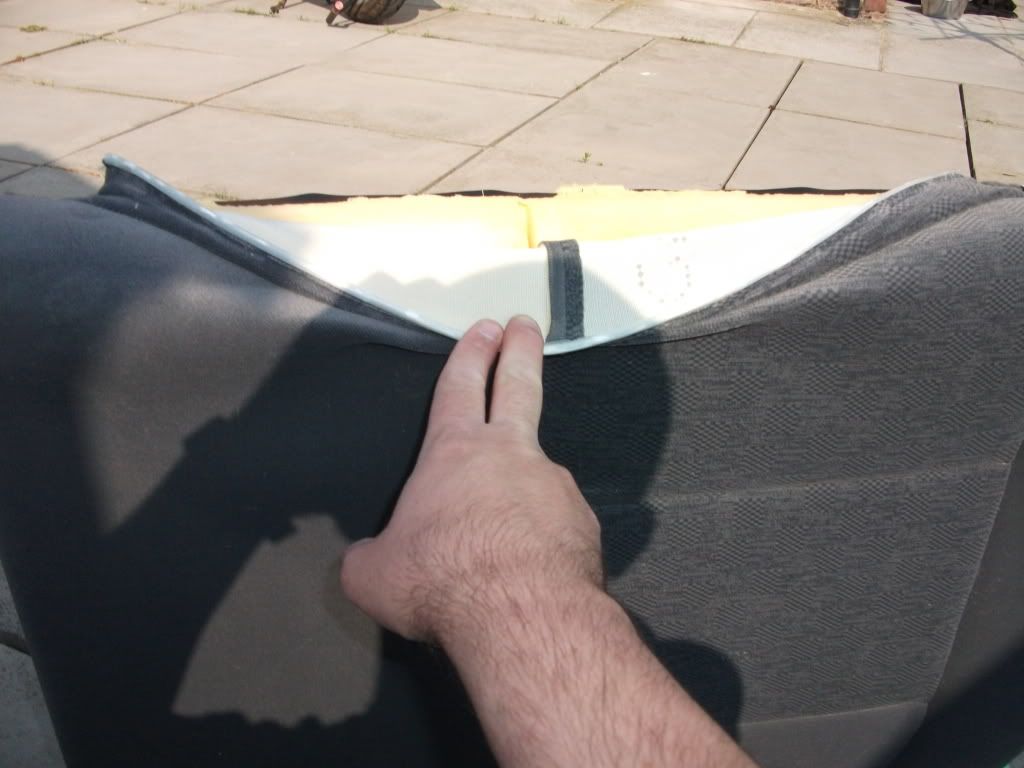

Once you've got a start, you can pretty much pull the whole lot off with your fingers. Refitting is simply the reverse of removing, just a little bit fiddly on the corners.

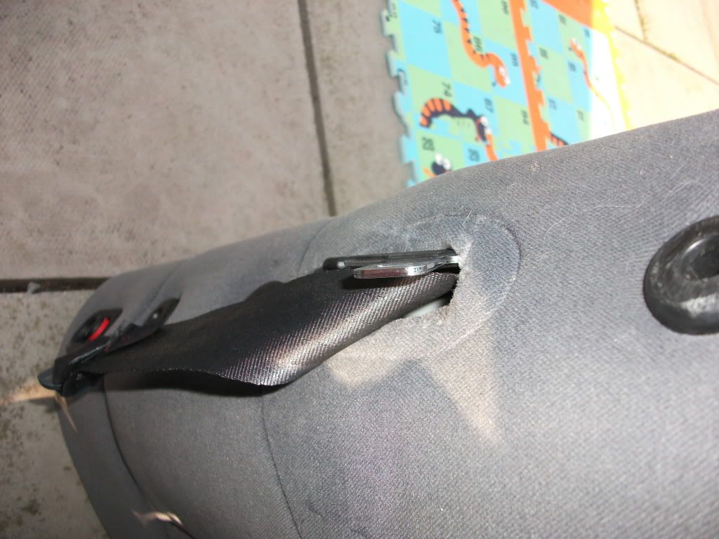

Once my shiny new metal bases were fitted, I decided to have a go at something else which has caused me a few problems now & then - the middle rear seatbelt. Quite often you'll try to pull this out & it'll totally lock & most of the time when you fold the seat back down it'll disappear back into the seat. I've been dreading this breaking properly as I'd have no hope of getting another half leather rear seat back, so thought I'd see how easy it is to remove & refurbish. As it turns out it's a piece of p**s to remove, but don't bother trying to refurb it - I took the sucker apart & this massive metal spring twatted me in the face & made it's way across the garden.

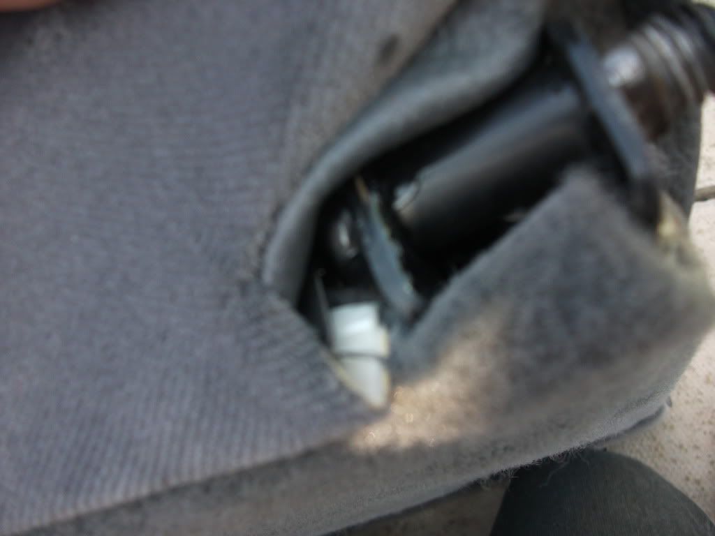

Removing the backrest cover looks nigh on impossible, but thankfully you don't need to totally remove it to change the seatbelt. At the bottom, if you look very closely, you'll see a fixing similar to those that held the metal bases into the squabs:
Pull this out & you're left with a nice big opening in the bottom of the backrest that gives a view of the seatbelt mounting inside:
