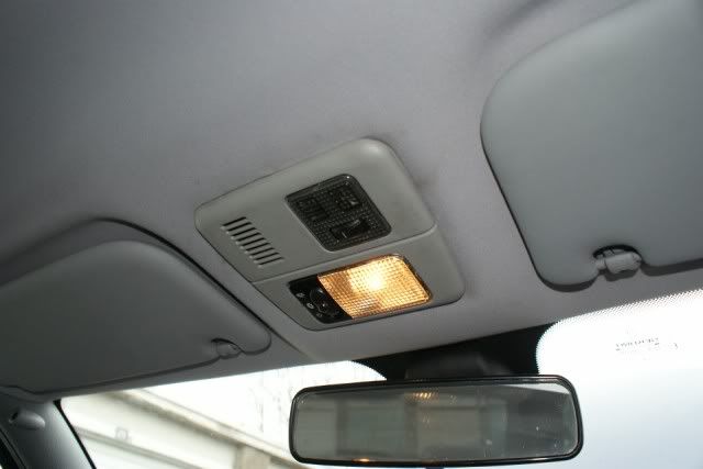

The problems? Well firstly there is a little fan in the light console that buzzes constantly (I'm assuming it's used for the A/C) but for the life of me, I can't get the console down! It's feels like everything is brittle and I don't want to break something. I'm sure there is a proper way?

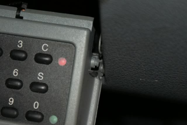

My immobiliser keypad won't stay up, the lugs are worn and don't hold it there anymore. Is this a common thing and can it be fixed?

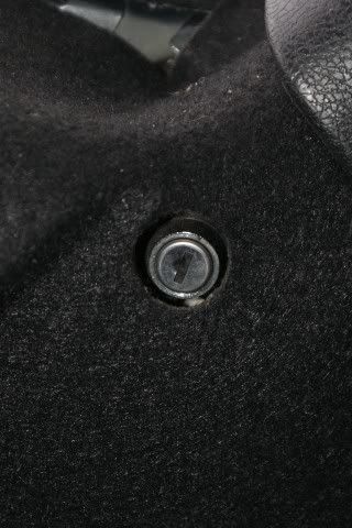

There is a keyhole in the boot, I'm scuppered if I know what it does!

Rammstein406 wrote:The problems? Well firstly there is a little fan in the light console that buzzes constantly (I'm assuming it's used for the A/C) but for the life of me, I can't get the console down! It's feels like everything is brittle and I don't want to break something. I'm sure there is a proper way?
Bad news I'm afraid, the screw holding it all up is behind the courtesy light, and you have the early version which you probably won't get out without breaking it. You need to lever it out from the centre of the side opposite the switch.
They revised the light design in 1998 (the shape of the switch is the giveaway) to one that comes out cleanly, but the connector changed too, so it's not a straight swap
No it's not common. Looks like someone's caught it :( You may be able to get a replacement panel off ebay. If your car is setup to work without having to enter the code, you can replace the panel with one with a little cubby hole, but keep the keypad for emergencies
It kills the alarm.
Thanks for the info! Not really ideal though! I need to replace the aerial too. I think I'll just buy a replacement light and remove the old one and just replace it! I don't know if the car can be run without the code, but I'd rather keep the keypad. I'll just strip it off and see what I can do!

Re: Hello, New Member Here
Welcome on in Rammstein! :)
Very tidy car, is it just the plastic on the keypad housing that's worn? You could always swap the guts over to another unit.
I think there's a "HowTo" in the knowledge base on cleaning the climate control sampling fan, as mjb says the plastic can be very brittle on the lens!

Cheers dude! Yeah, the little pins have worn down on the keypad, making it "sag".

NIce one! I took it down today, of course breaking the light in the process(!) The fan is so fiddly and no matter how many times I repositoned it, it started to rattle. So I carefully filed the edges of the blades down and now it's quiet as a mouse! I'm going to change my aerial whilst everything is down because it's on it's last legs and order a new light tomorrow. If the weather holds out, I'll be changing the plugs because they are definately due. I'll take some photos of how I did it and post them up!
