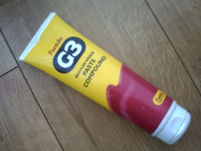

just be very carefull . only use this with your hand DO NOT USE A MACHINE BUFFER unless you know what your doing
Farecla G3 regular paste compound
i just lightly buff the offened scratch untill it disapears. it really does work its like magic
as i said be carefull this stuff takes away a small layer of laquer and if rubbed to hard for a long period of time you will go to the paint
but for general use via hand its brilliant stuff ,
a pea size blob is all thats needed per scratch. DONT wax this all over the car it isnt a polish
