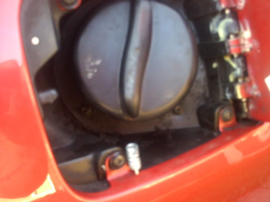

BTW, the spring I fitted was from a plastic clothes peg, the wooden ones we have are too small in diameter.

i think, this not gonna work properly
the "L" legs of that cloth spring not going like OUTSIDE, they going like INSIDE. better thing to fix this problem is spring from hair clipper

Mine works perfectly every time.
The spring on mine could do with replacing as it's a bit weak now with the rust, but I don't care, my car will be sold next week.

Yup, mine upped and died just recently, but thanks to this thread I had the savvy to butcher a clothes peg and bodge that mofo. Sorted ^_^
The man with no car
Re: fuel flap
this is were i put my peg spring, i took the torx screw out, bwnt the spring so one pin was sticking outwards
pic not that good but you should get it
Re: fuel flap
Gary406 wrote:this is were i put my peg spring, i took the torx screw out, bent the spring so one pin was sticking outwards
pic not that good but you should get it![]()
