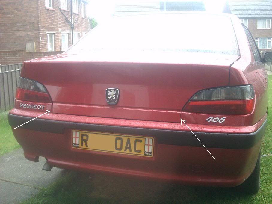

hello all, is it possible to adjust the rear bumper to the side about 2mm, with the boot closed the bumper sits 2mm to the left so
i was wondering if i could just slacken the bolts at the back and nudge the bumper to the right 2mm then tighten it back up,
i dont think the sides would be affected cos at sum point its been knocked over to the left anyway 8)
pic below should explain better, can you see the bumper doesnt sit inline with the boot lid , the boot lid is in the center there with the car so it has to be the bumper , i know the boot lid is high on the right its not been adjusted yet (its a new boot off a different car)
but my old boot was the same, smaller gap on the right, you can see the arrows in the photo,

Obviously not :oops: I guess it depends how much space there is for the fixing bolts, you could try slackening them off and giving it a push but you might end up having to take it off and turning holes into slots with a round file.

well after 1.5 hours i've finally got the boot lid centered :cheesy:
its still not 100% cusha but,,,,,,,,,, its defo an improvement and im back on the happy road
it turned out to be the boot lock mechanism, when the boot closed to the bottom it was dead center with the rear quaters and clusters
but,,, when the boot lid was fully closed i noticed that the lock were it meets the metal thing that clamps it down wasnt meeting up inline with each other so it was pushing the boot to the right 2mm ,
thanks for the replys steve 8)

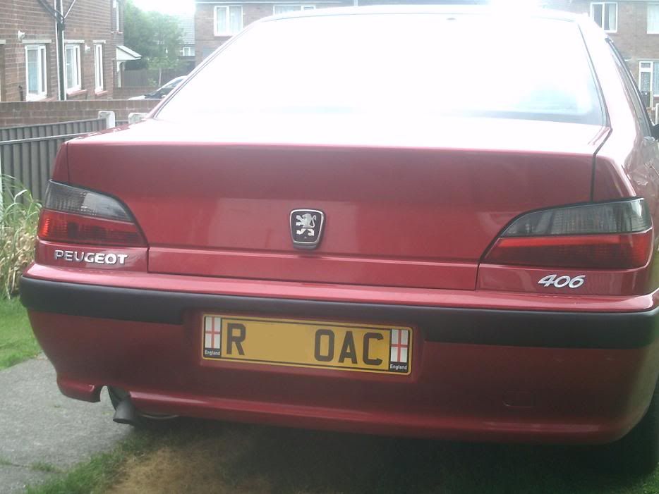

Re: Rear Bumper
heres the job , looking much better 8)
