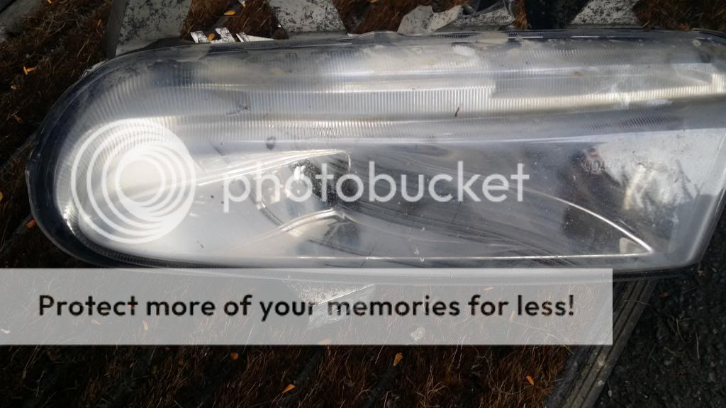

Decided over the last few days to clean up the foglights. They had gone really white and manky.
sorry about picture quality.
I started by removing the foglights from the bumper. And took the actual bulb holder out.
Even with my big hands i could still squeeze them into the lamp unit and using some g4 polish i could polish up the glass from the inside. All the white came straight off and they looked great. I also purchased some H1 LED bulbs to fit.
to do this i found that they didnt quite fit the lamp unit so i had to file the hole slightly larger to allow the bulb to fit. I also had to remove the inner piece of tin as the bulb was too long and caught on it. (I dont drive with my fogs on so wont blind anyone)
I then rebuilt the lamp unit and refit to the car looking super clean and put out excellent light on a night.
match really well with the HID KIT. LED sidelights and LED main beam.

Looks good, I always assumed they discoloured on the outside......

I wasnt sure how they would clean up but turns out that the white stuff is just like some type of powder?? Really finished off the front end. Ill get some pictures of it all lit up with all the leds.

Nice job, makes a huge difference to the front of the car. I did mine recently...they had the same cruddy white deposits on the inside of the glass.
One point though, by removing that metal deflector, won't the spread of light be uncontrolled now?
Re: Front Foglights discoloured
I missed that bit, yes it will affect the beam pattern (and not in a good way to be fair) that 'cap' over the bulb is to control the focal point within the lens, without it you pretty much end up with a Torch effect.markw wrote:One point though, by removing that metal deflector, won't the spread of light be uncontrolled now?

Yeah that is true didnt really think about that. But also at the same time i dont use the foglights much at all and with the upgrade to hids then the fogs are more for looks now

I've just had my head under the front of mine, and there seems virtually no access to the foglights.
And the Haynes says remove the front bumper to get at them.
Is that right... ?
Is that right... ?
2006 Toyota Yaris 1.0 T3
1993 Mazda MX5 Mk1 1.6
2000 "W" HDI 110 Executive Saloon (Recycled).
There's an access panel in the bumper underneath as I remember.

All i had in the way was the wheel arch liner on both side. The o/s was harder to do due to the washer bottle and it required a little persuation past the bumper but once wheel arch liner was pulled back out of the way there is 3 torx30 screws holding the lamp unit in.
