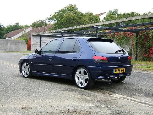

I reckon these will look really good on the 406, i have attached a pic of these fitted to my old 306 which i imho really set it off. I'm sure you will agree.

They look amazing - these would look superb on the 406 - but with bigger walled tyres (55 or 60) These are the challenger or the 180 gti wheels - will the offset be the same I think they will need spacers.

ivor406 wrote:They look amazing - these would look superb on the 406 - but with bigger walled tyres (55 or 60) These are the challenger or the 180 gti wheels - will the offset be the same I think they will need spacers.
They are the 180 GTi wheels, which didnt need spacers on my 306, so not 100% sure they wil fit the 406 with or without the spacers.

Easiest way to tell challengers (307 wheels) from Vortex (206 GTi 180) wheels is that the Challengers have removable centre caps whereas the Vortex have solid centres. The Challengers are also a different offset (ET18 IIRC) and will bolt directly on, whereas the Vortex are ET28 IIRC and will ideally require 10mm spacers to get the correct offset. By the way, the actually tyre size you ideally want to run on 17's on a 406 is 225/45/17. That's the closest rolling radius to stock and offers good grip too. I can vouch for this! :supafrisk:
