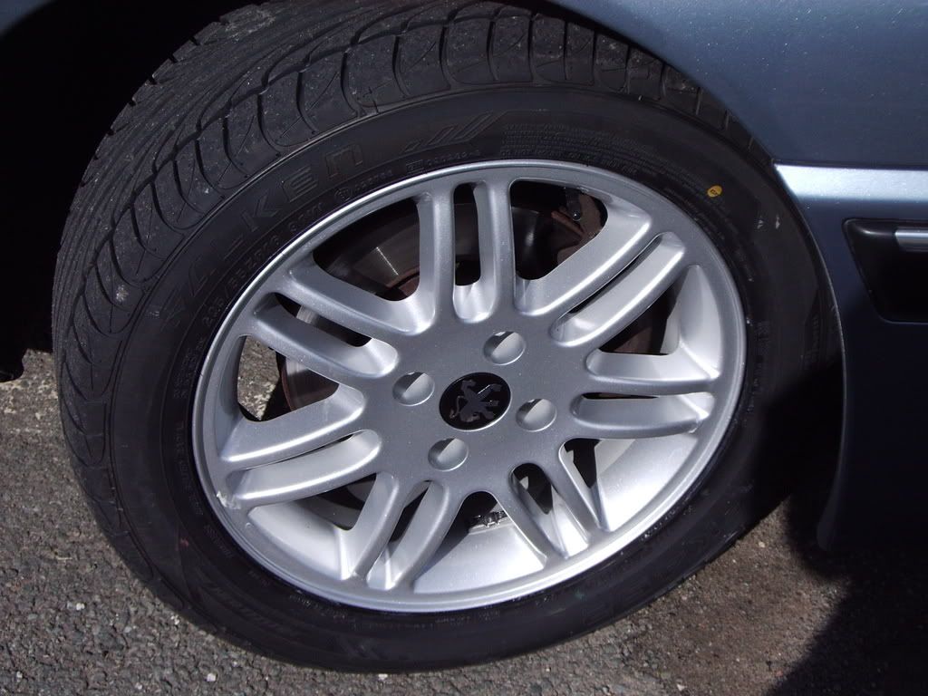

I have pug Vulcans on mine and the recomended tyre size is 205 x 55 x 16's

Are the ones on the ebay add Vulcans?puggy wrote:I have pug Vulcans on mine and the recomended tyre size is 205 x 55 x 16's

[coloLMFAO !!! yes you do stever=#FF0000][/color]

Look decent, I double checked - the tyre size is 205/60/15.
