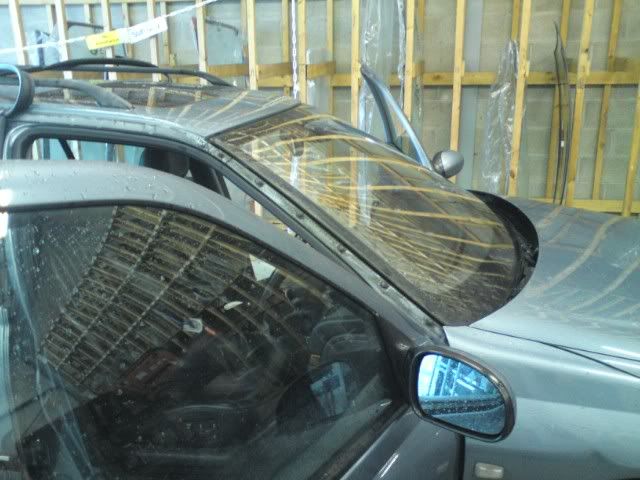

OLD SCREEN with the side trims removed ready for slicing out with a stanley type tool which cuts through the 'glue' holding the old screen in after removal of wipers etc.

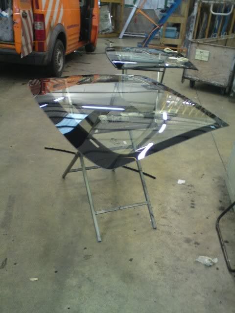

New one ready to go in.

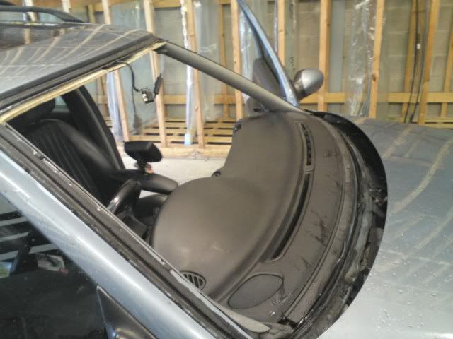

Screen cut out ready for cleaning up the window frame.

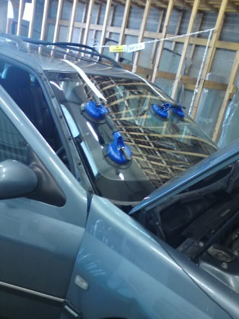

New one fitted waiting for the new 'glue' to go off.
All in all it was done in an hour or so and an extra hour for the 'glue' to set.
