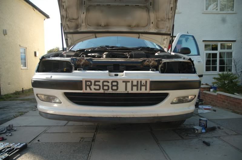

Went back to the scrap yard and got a new bumper (my current one has poor attempts of using touch up pens for a whole area, not by me) with fogs and headlight washers.
Also picked up a splitter

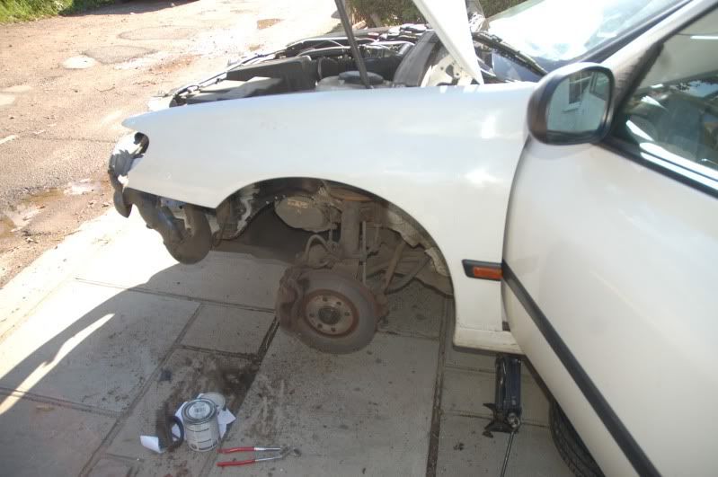

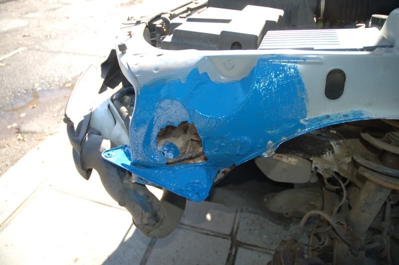

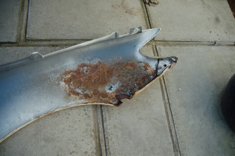

Off with the old wing to reveal the damage caused by an removed arch cap
Wire brushed the rust to metal and removed the most flexible pieces to metal/ rust
Hammerited the area and used aluminum tape to cover the hole
Fitted the wing
Then fitted the bumper with renault scenic splitter and fogs

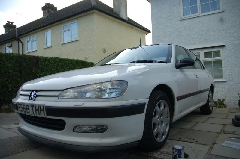

All in all a much nicer look i think for very cheap.
Next on the cards is to rust proof the underside and get it ready for an MOT

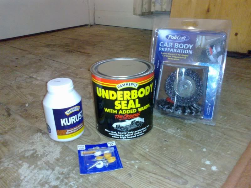

Well my MOTs due by the end of the month so its booked in for next week and i'm hoping to fix anything that comes up myself. I bought a new set of brake lights today and i'm trying to sort out the little jobs that could cause it to fail. If it passes, i plan to give it a full service and under-seal the rear as parts are looking fairly rusty.
Also if i can figure out pay pal i'm looking to buy some mud flaps for the winter months and a strut brace from e-bay
