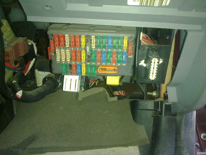

While I was at it, changed the replaced fuses for originals
Not the cleanest...

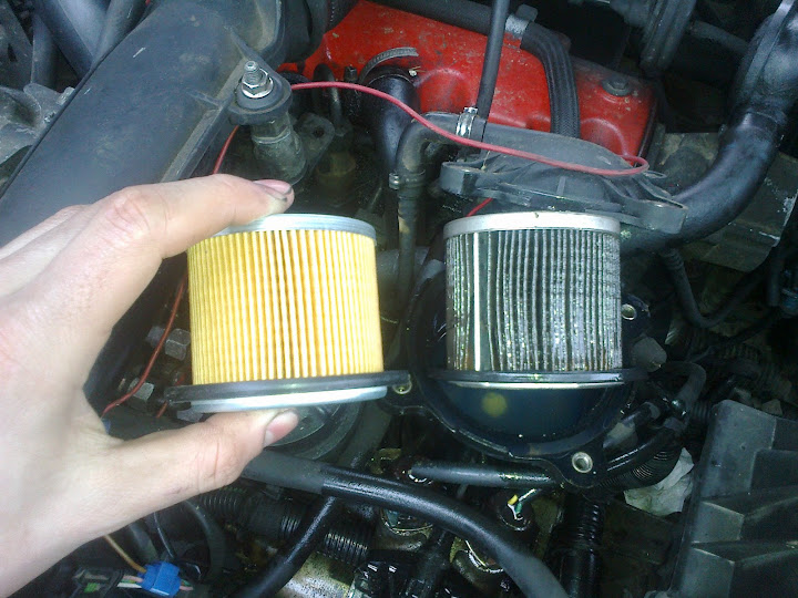

A fuel filter changed...
Oh dear.... 5k miles....
