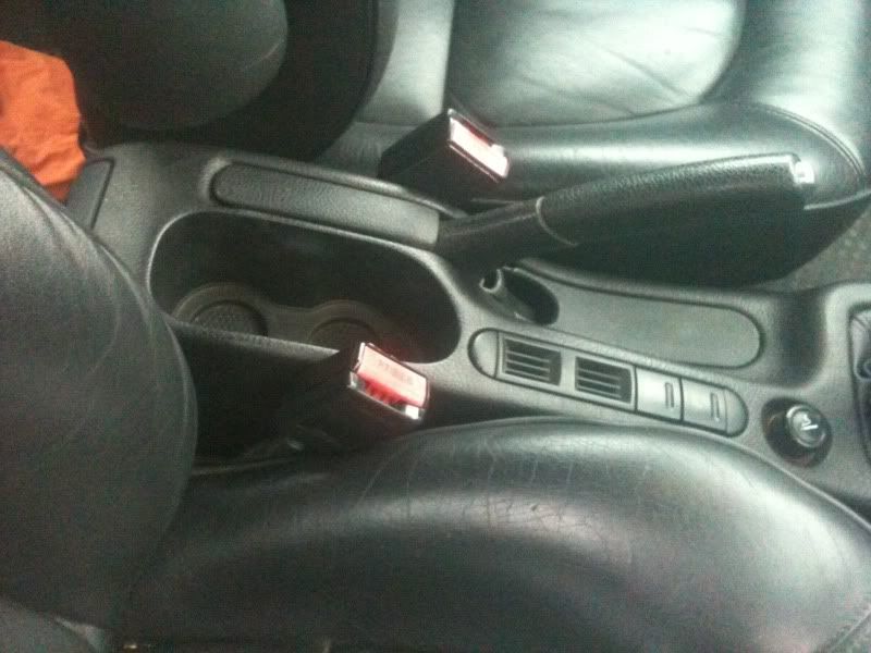

Where's the pen holder in the centre console? I'd actually quite fancy that in my car as I usually just stick one in the sun visor.
Re: Plod's HDi 140
Where the heated seat switches reside, in my car is a pen holder insteadwaue1978 wrote:Where's the pen holder in the centre console? I'd actually quite fancy that in my car as I usually just stick one in the sun visor.
However BALLS BALLS BALLS
The other week, when I had the rear calipers off Nigel, I had a check strap and a centre console
The console I had for the fag lighter plastic as mine has a crack in it
Well I binned the rest of it
Today, come to look at the pen holder, as thought it clipped out and the heated seat switches popped in
NO
On mine it's moulded in !
Guess what?
Yep, the one I binned had the slot for the heated seat switches to slot into
So I need a centre console after all, so i'll be sourcing a D9 one to fit into it

Ah, won't be putting a pen holder in mine then. I've still got the airbag on/off switch in there on my centre console.
Re: Plod's HDi 140
A trip to Ade the coupe breaker "on the way back" from Kendal ( Snake pass was "fun" in the lorry
and £15 later, I am the proud owner of a D9 centre console
Got back and got to work
I had a cigarette lighter off Omega as wanted it for orange plastic surround as mine was broken but turned out it was different
The cigarette lighter in the D9 is different again, and a tad smaller in diameter
I glued up the fracture in my orange surround, and had to open up the hole to get it to fit
Had to transfer a few bits over from mine, and got it fitted
Fitted the heated seat switches into place but not yet tested
A quick pic from off my phone
