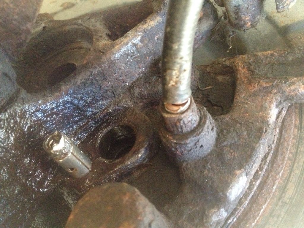

As my readers will also be aware we chiseled the ABS sensor away from the retaining bolt and took the old sensor off that way.
I was going to get a mobile mechanic out at the cost of £30 and although that is MUCH cheaper than the local grease monkey, it is just simply money I'd rather spend on an MOT / Tax and getting her back on the road.

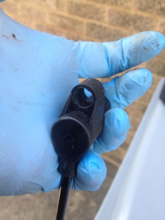

One my long-distance mobile mechanics advice I invited my mate Dave back over to DRILL the new metal sleeve from inside the sensor. I don't have a drill so I needed a man with more tools than I have. :)
All drilled out ~ Thanks Dave!
Now it can slide over the old bolt and sleeve.
ABS Rear right (off side) sensor in place.

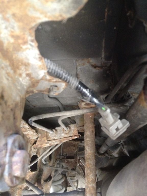

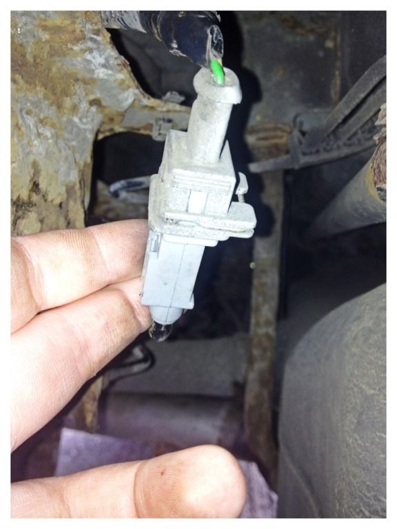

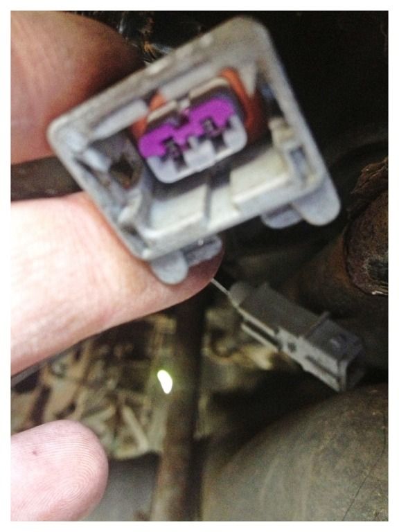

When clipping it into the connector we noticed the were wires exposed that had come out of the casing, nothing a bit of electrical insulation tape couldn't fix.

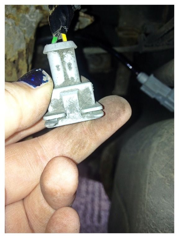

Pics from today:
Citroen logo :lol: (Better than seeing the Renault logo! :D
Sorry for picture quality on this one.

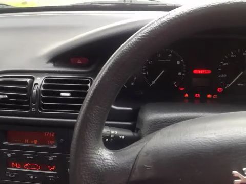

This is what I am dealing with at the moment: how soon it beeps the fault at me.

Just a bit of advice from a forum newbie, make sure the connection you have repaired is good, if there is any resistance in that circuit, ABS will still show a fault.
The other thing to watch out for is to make sure the sensors are as close as possible to the reluctor (toothed ring)
Hope this helps

UPDATE:
Touch wood, it's all sorted. No diagnostics needed and nothing other than time and WD40 used.
I did disconnect both 15amp fuses in the engine bay yesterday, which had no effect on the warning light on the dash might I add. :evil:
MOT on Monday 4:30pm - Wish us luck! :D
