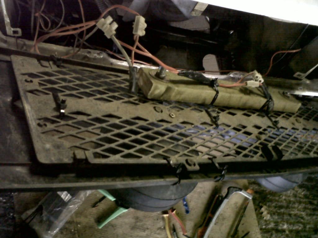

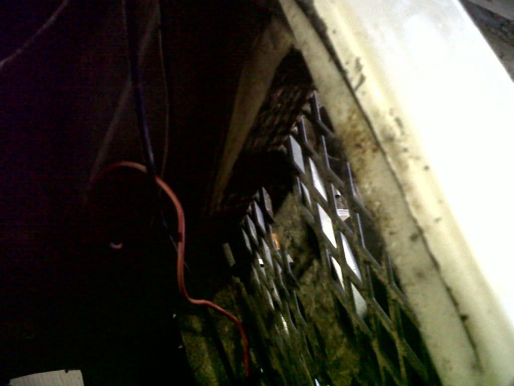

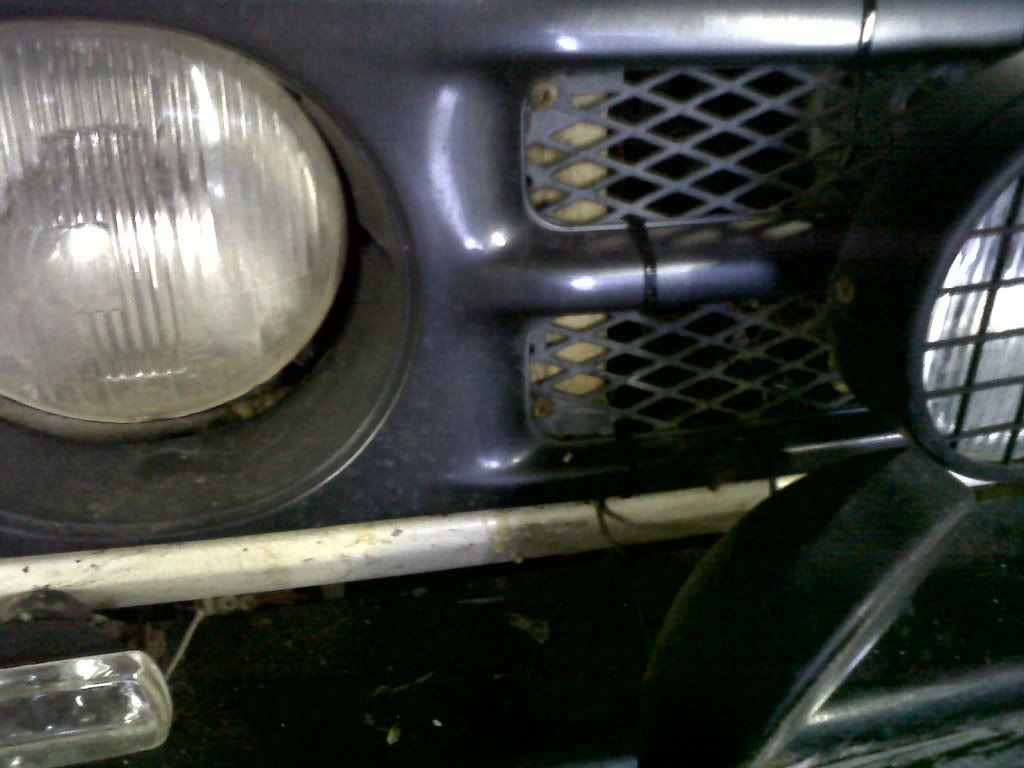

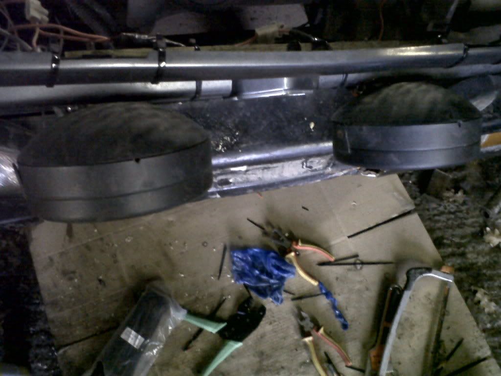

anyhow on the subject of the jeep, waiting for a hydraulic jack to prop up the gearbox to get the mount into place, so i decided to fix the issue with the spot lights, they bobbled, bounced and moved like mad, and the main reason was they were badly mounted. Look at how flimsilly mounted the grille is put in place on a samurai, just one bleeding screw keeps it in place:

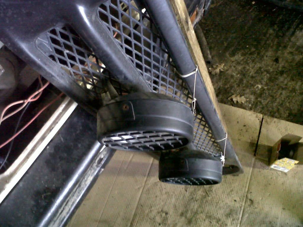

they were just bolted onto to the flimsy grille, and had a bit of string at the top to stop the lights bouncing:
but where this thing got used that didnt work.

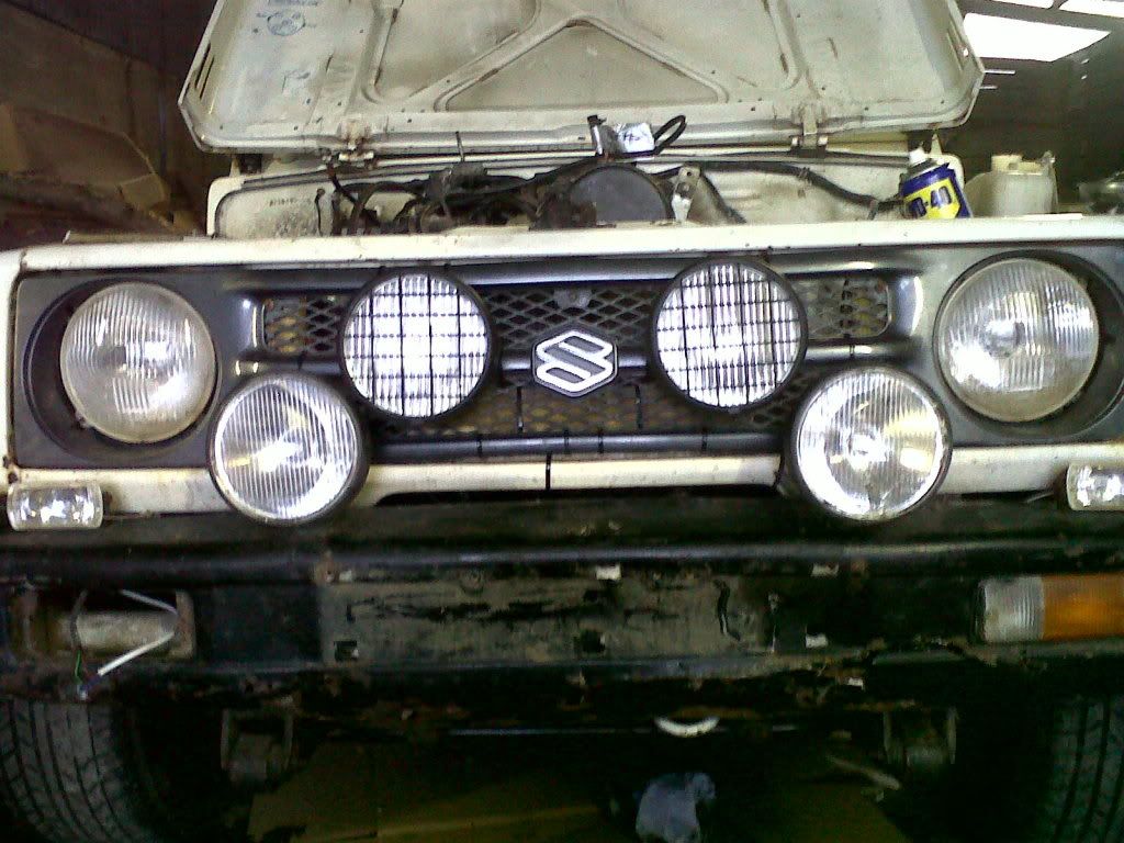

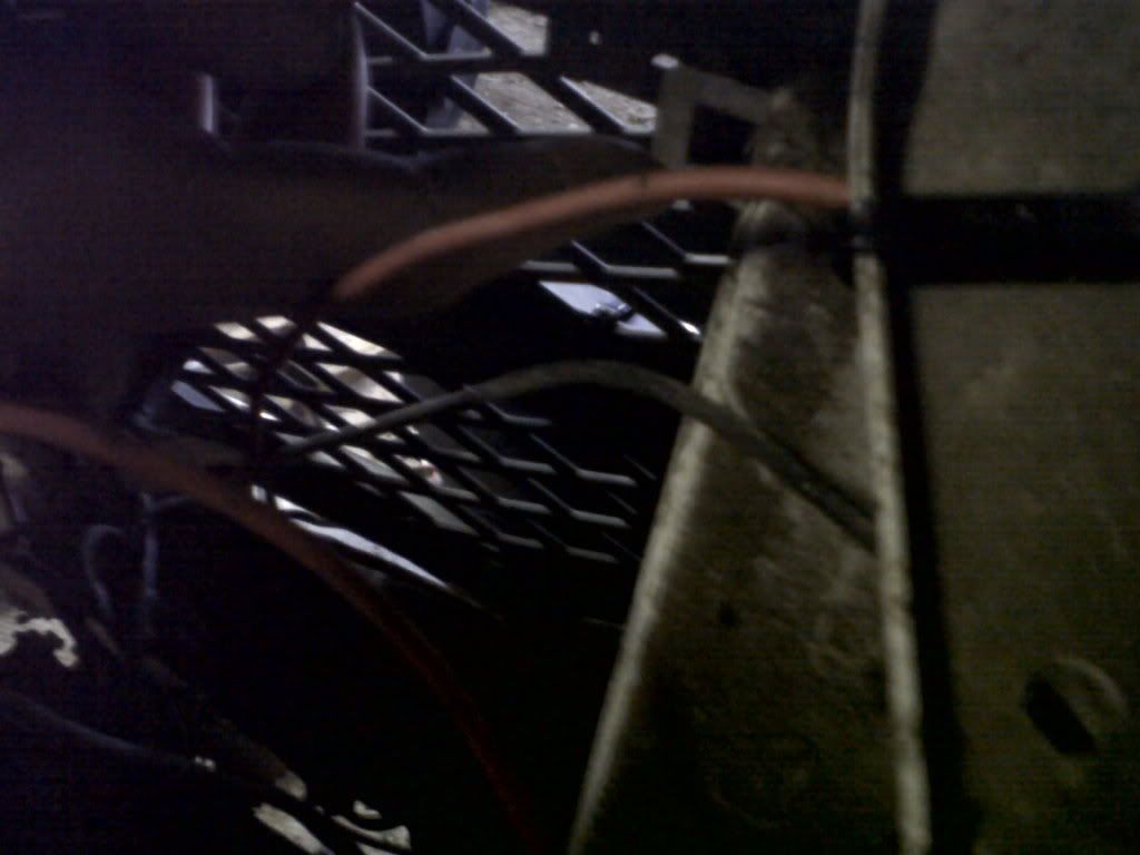

so i got longer bolts and put them onto the brackets for the lights, then cut a length of wood, drilled 2 holes and put the bolts through, and also 2 screws put through the middle of the grille to keep the lights firmly on it:
see firmly mounted onto the grille:
yes a sh*t load of cable ties were used to hold the meshy bit of the grille tightly to the outer part of the grille.

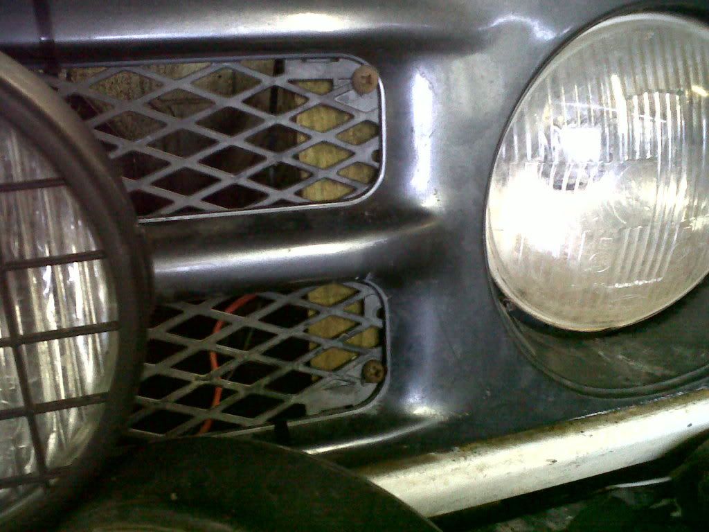

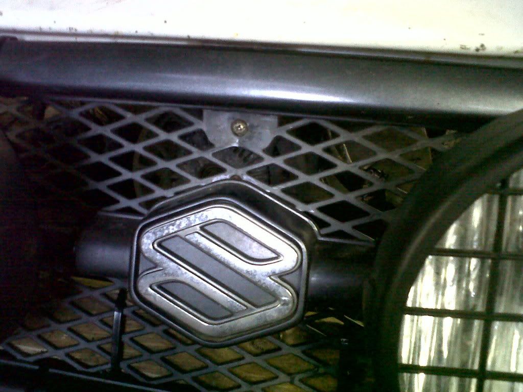

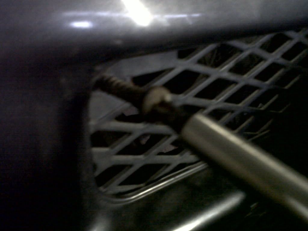

so that was the lights firmly onto the grille but it didnt get away from the fact that the grille wasnt mounted to the jeep very tightly, so i conveniently seen these square holes mounted behind the corners of the mesh part, so i put screws through the grill, the holes, and into 2 blocks of wood i had at each side:
nice rusty screws to match the theme of the jeep:
and the grille completley in place:
still might need another 4 spots up on the roof.
