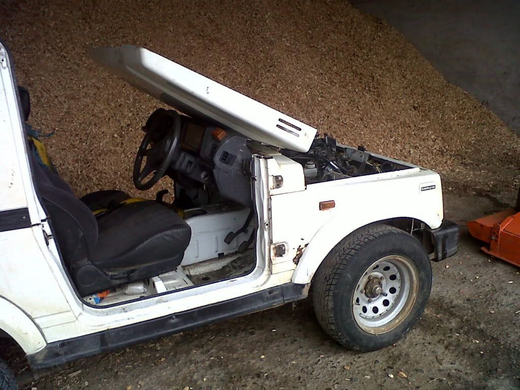

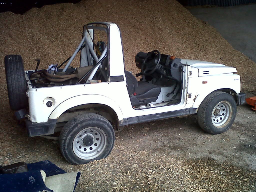

so the jeep had to be moved out of the shed, along with all the tools so it could be cleared out for the apple boxes, while the jeep was out i blew up the tyres, and took off the doors, roof support bars, and windscreen, driving these jeeps without such unnecessary extras really is the way to go:

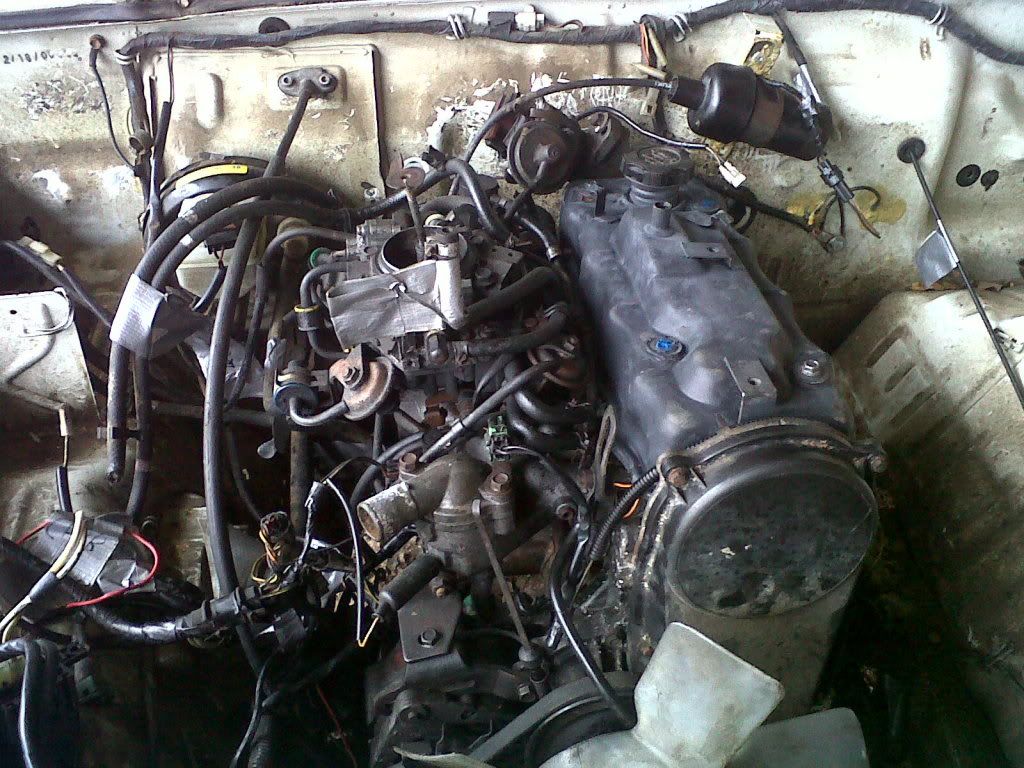

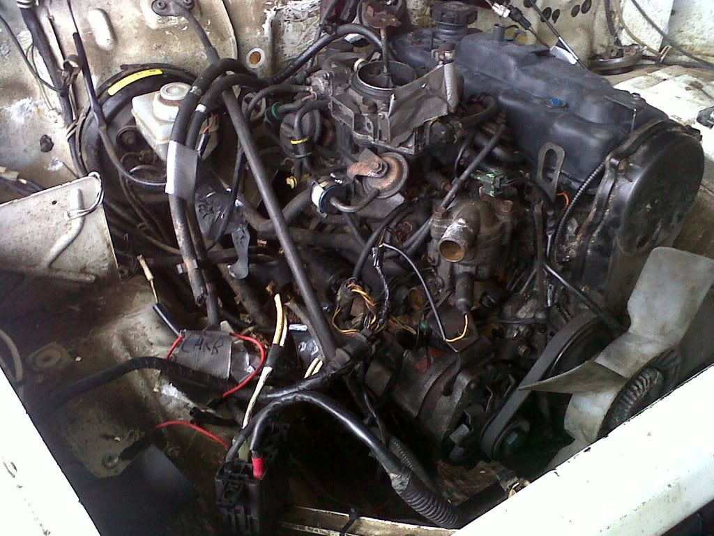

fuel lines now connected, starter connected, negative terminal all ready, just the altenator and push button switch and the coil to sort out, the sump, and the gearbox mount, and whatever else i havent said.

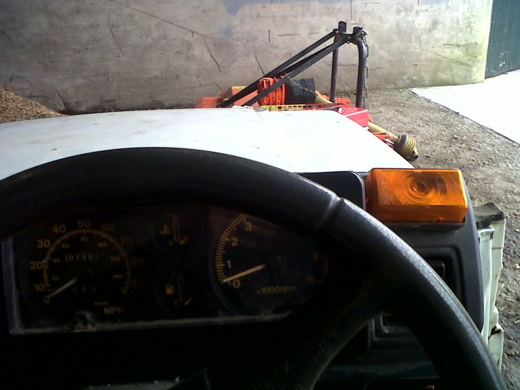

its not too bad looking, nice simple little engine bay.
improved driving experience:

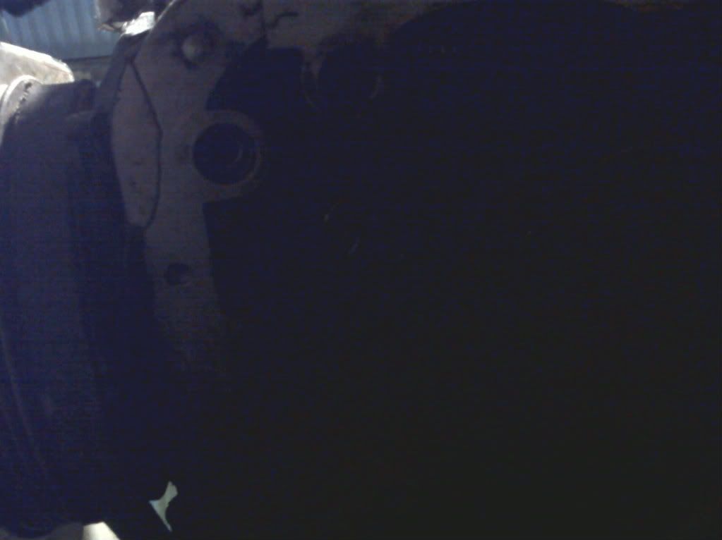

the problem, which was declared as not a problem with the crack where the sump goes:

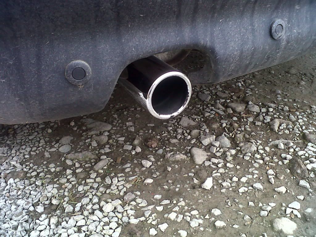

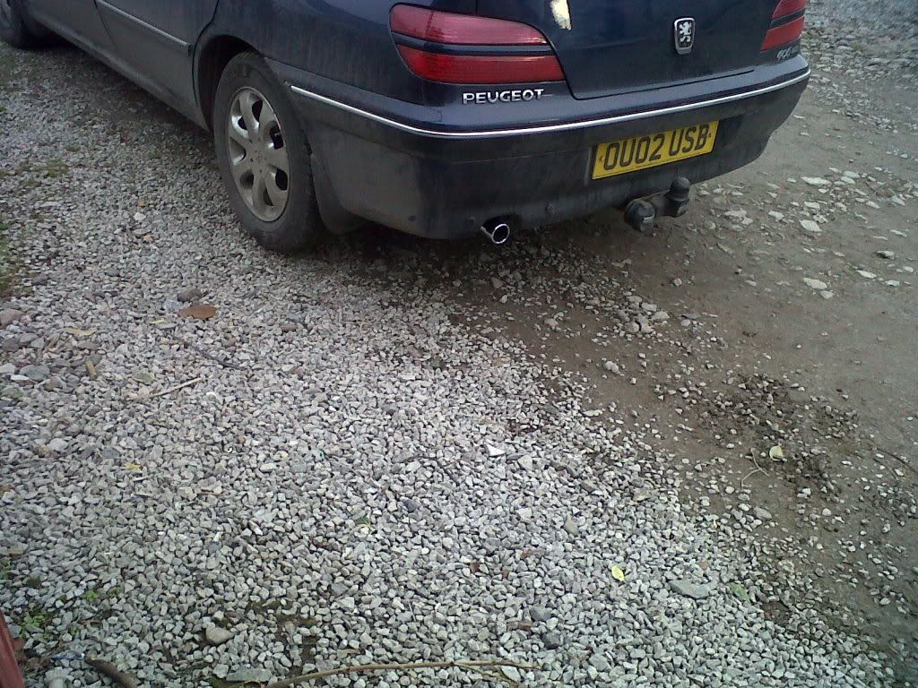

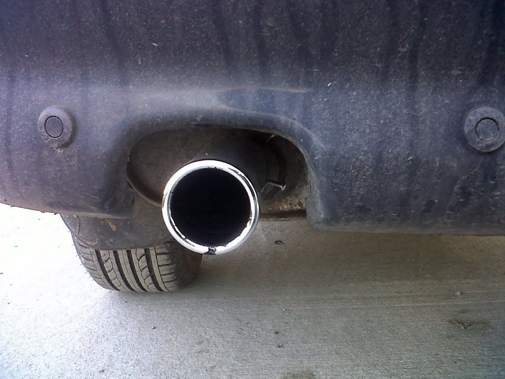

finally got a chrome exhaust tip that fits, ebay £5 and then £3 postage, slid right over my exhaust, and clamped on with the clamp in it, i was prepared to do some sawing at the exhaust but it wasnt necessary, anyhow here it is and it looks quite good, i think subtle, as i was trying to avoid a chavish look as so many aftermarket exhaust things do:
and after a good diesel blow out, i got only this much black soot on its tip:

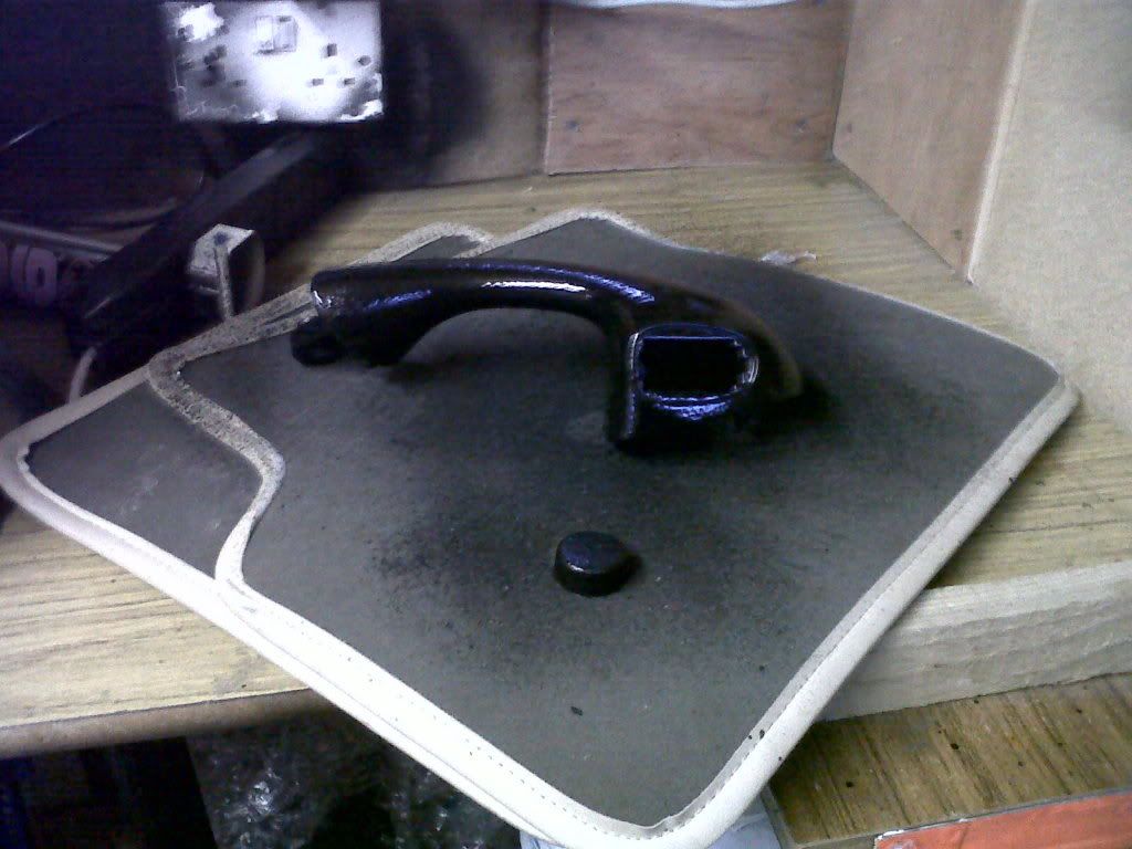

onto the plastidip issue, its a waste of time, it doesnt come out as a nice fine spray as you tube suggests, perhaps because in ad land everything works perfectly, no but mine came out all lumpy from the can even when new despite shaking like mad. So ive asked the seller about this and await a reply because look at the state it left my grab handle in:
looks quite poo.

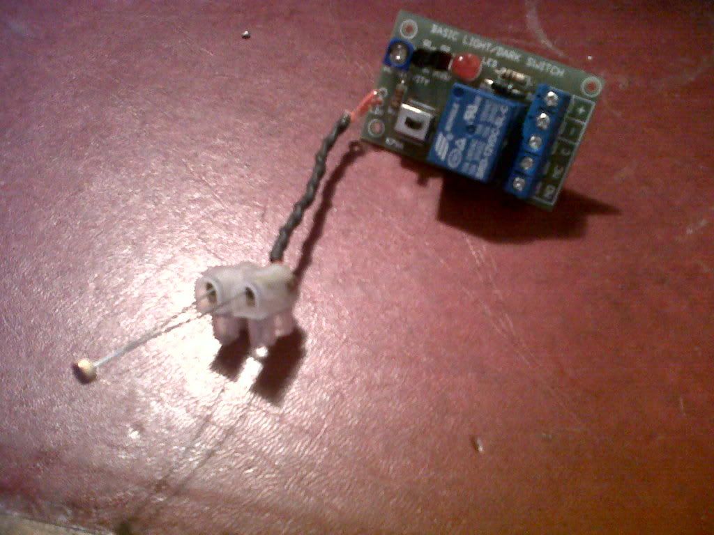

on a brighter note, i finally got a ldr activate circuit that appears to be functioning correctly:
it sends the multimeter buzzing like mad in the light and shuts it up in the dark so that is working well, and its not from ebay its from some other company who isnt ebay but conveniently accept paypal, ill not give a link unless it works when i install it in my car, or someone asks.

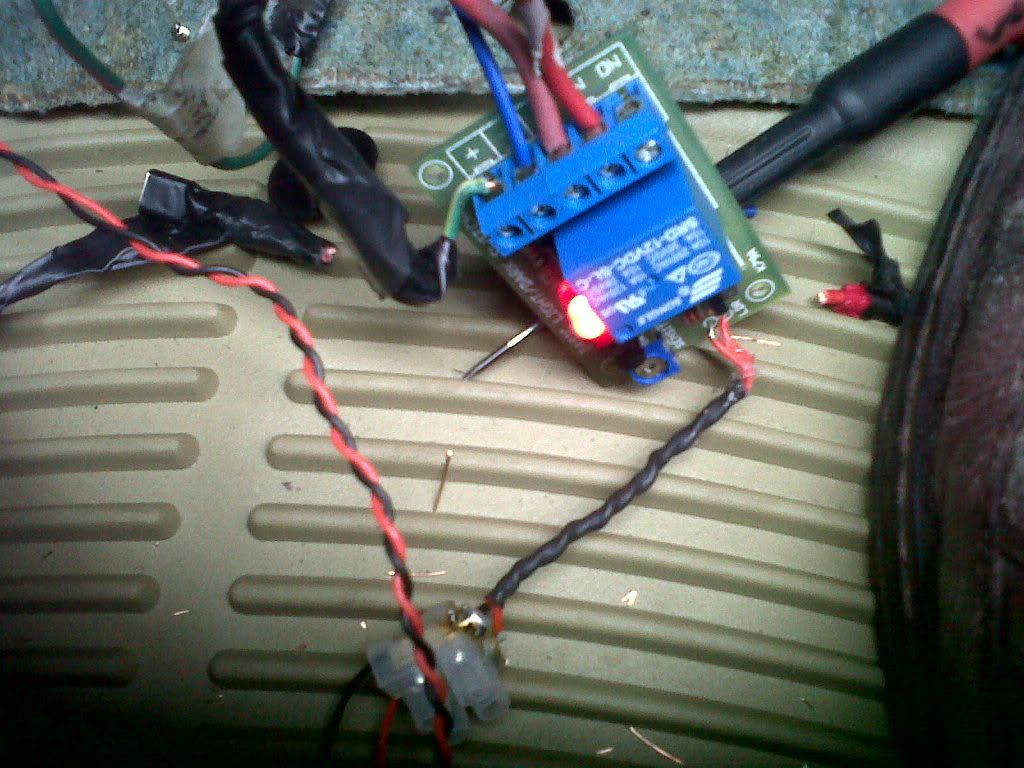

the bsi can play havoc, if you directly wire the footwell lights to the overhead courtesy light, or doorcard lights it fecks up the bsi and everything will go mad. So what my circuit is to do is effectivley take a safe power supply from the battery which i brought into the car, there is an ldr mounted over beside the courtesy light, and the circuit should turn on and off the relay which disconnects and reconnects the power supply to the footwell lights. Thats the plan anyhow, all the previous 2 attempts were let down by the circuits being the wrong type so this one should hopefully work when wired in. As for lights in the door handles, if you have this system its possible to use the same relay to switch on a bigger relay (because its all too much for the small relay in there just 5A) to send the power to the lights in the door handles, but the issue there is threading all the wires, and mounting the lights into the handles properly, thats what put me off but if someone found a way to mount lights into the handles id give it a try.

SUCCESS the footwell lights are working:
however this device/circuit is supposed to be switchable between light and dark activating the relay but i can only get the thing activated by the dark. So that means just wiring it up different into the relay, but i wonder when the relay is on is it draining power because if it is i need to sort that out. But other than that the reaction time of the circuit is instant, no delay at all, and its nice in that as you know the 406 courtesy light comes on when the central locking is unlocked, this also comes on.
I also need to install it in a bit better, at the moment its only just sitting back up under the carpet and rattling like mad, but if i do get another circuit with a working switch id need to take it out again, DANG diddly squat.
