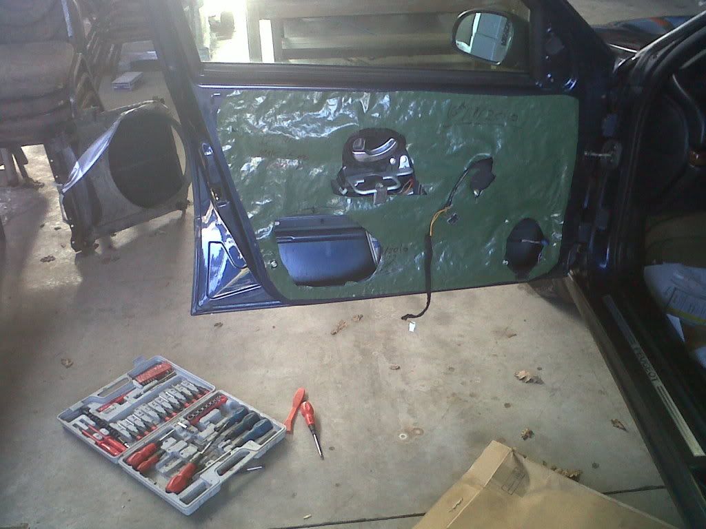

Got this in the post:

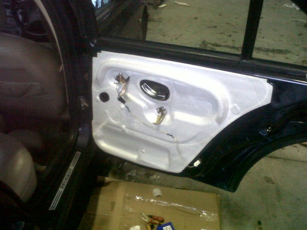

the new door sealing skin, at £30 a skin they are bleeding expensive, so to ensure this thing was going on properly i spent about 2 hours in preperation, that included removing the old one, cleaning the surfaces, removing the metal plates over it, and drying the surface.
I used a hair dryer to heat up the surface, it also made the adhesive stickier.

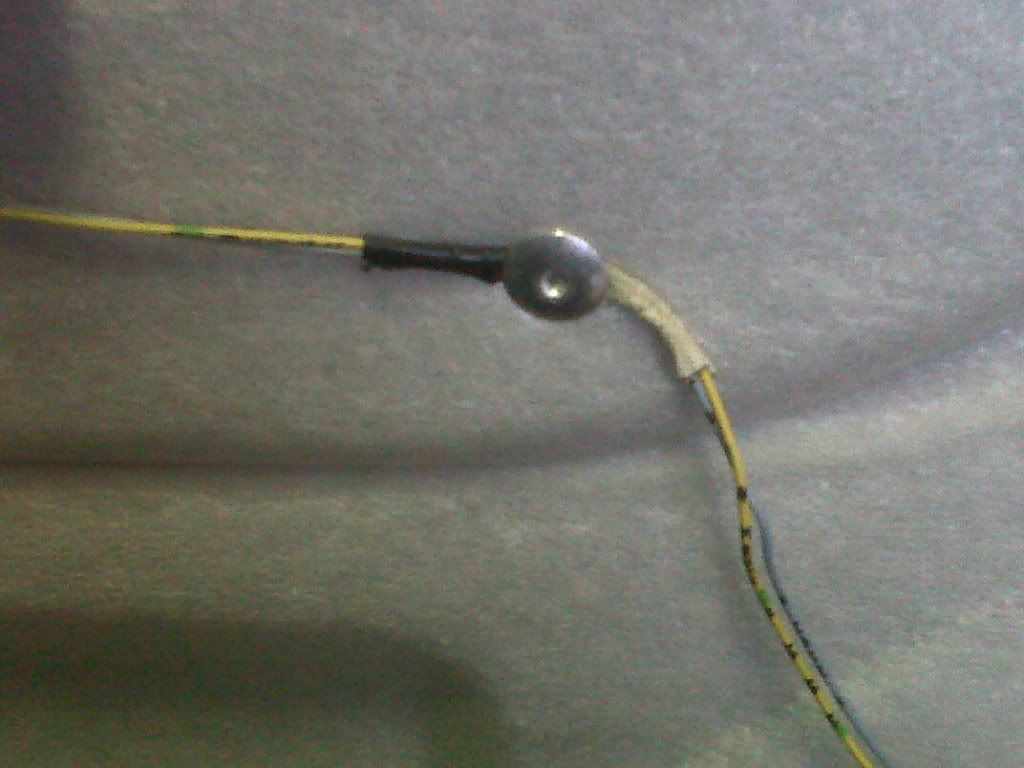

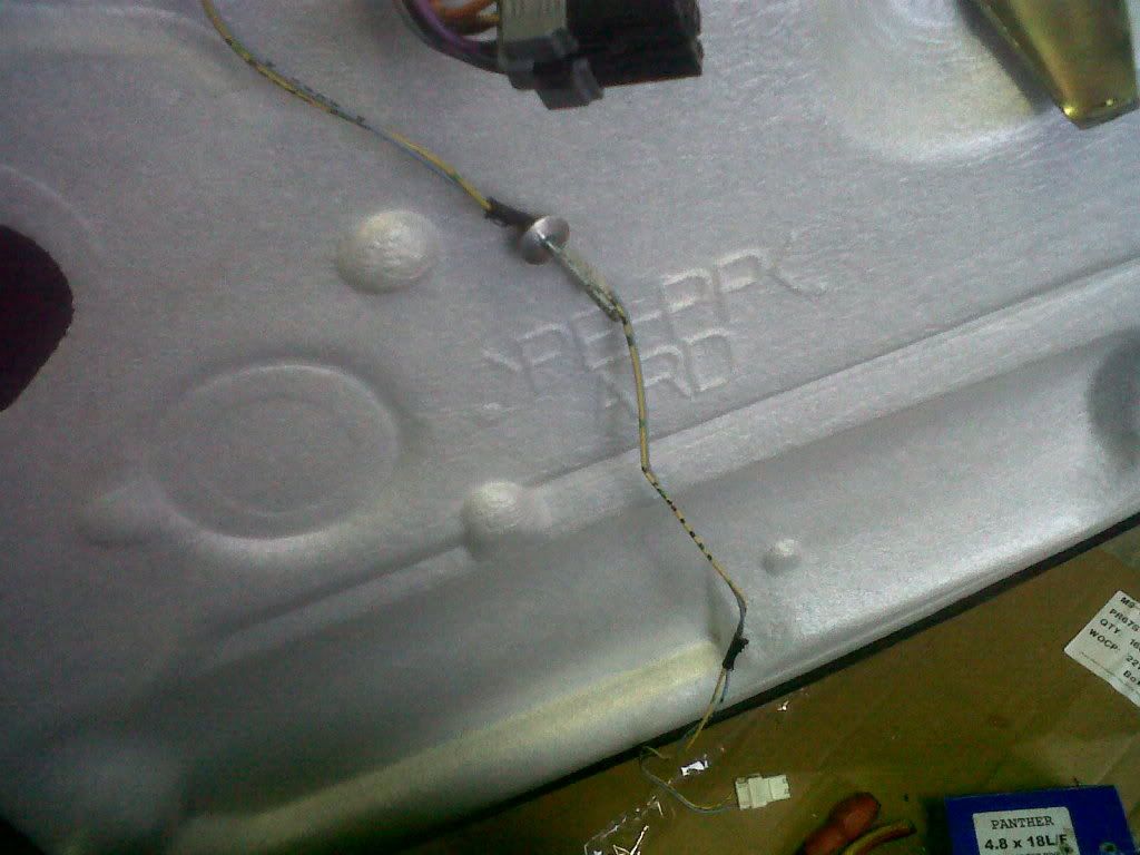

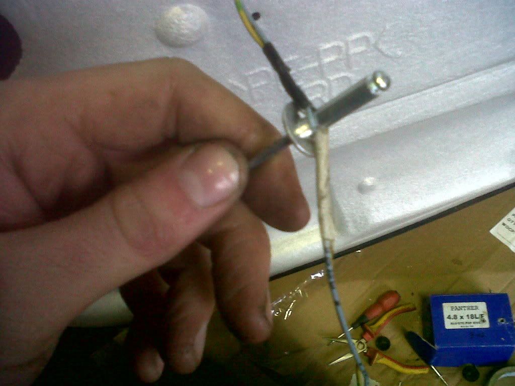

It went on with no problem, only issue was the wire going to the puddle light was held in place by plastic clips, but i simply put 2 bits of tape close together on the 2 wires and a pop rivet in between which holds the wires much better and neater:
and thats it, one completley new and fresh door seal, no leaks tankfully, and no irritating rattles or squeaks.
but still £30 is a rip off.
heres the thing, ive seen the equivilant part on a vee double ewe passat and its a pressed metal sheet with a rubbery bit sealing, its bolted in place, and can be removed easy. But here, what if i need to get at something behind a sealing sheet, are they something you must replace every time you work behind the door or is it possible to remove them for future use?

Re: The Car (and jeep)
It's all money for PSA
The VAdGe version does seem to be a better solution, I found one site about resealing it on an Octavia (8 roads?) and they referred to it as a "carrier" as it had a lot of the door gubbins mounted on it.
I think the point of the Pug ones is they're a water barrier and a sound deadener. There's a lot of stuff in the US about that sort of thing, whole companies that just seem to produce sound deadening sheets for cars. There's a lot of data on their sound absorption but being waterproof doesn't seem to be too high up in their priorities. Have a look at this: http://www.dynamat.com/

but the thing is realistically, these things are just spat out in some machine, its not a hand crafted bit of perfection just a slab of foam. In fact the box it came in, probably cost more to produce. But its hard to beat the peugeot and citroen logo on the box of original parts, its like its saying well done sir you were not a cheapskate.
But really it should be easier to remove without breaking. The problem with the vw system is it rattles.

I did the same today for the passenger side ie nearside door:
this shitty attempt at making a door skin never worked, but i had it held on with silocone, getting it off was fun. But its on now, as well as new clips on the door card. All finished off with me walking into the corner of the door, and cutting the side of my head, hurts like mad.
it wont work with that big hole there.
