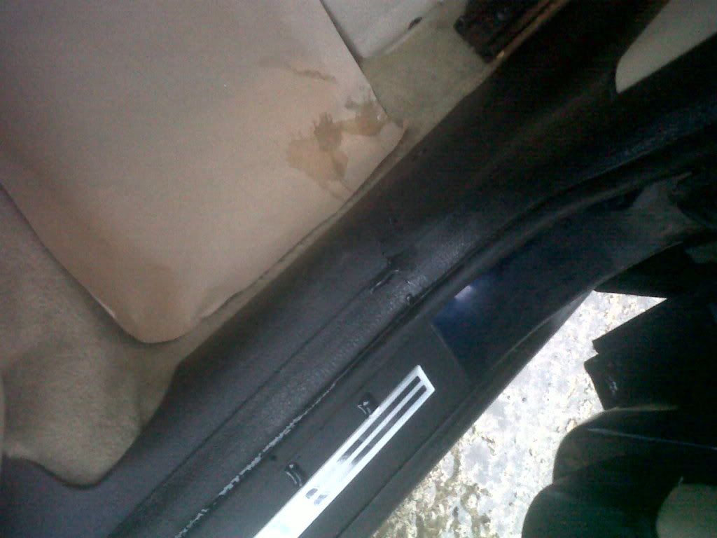

After checking all the seals , alls good the boots not leaking, sunroofs fine alls good, but then i spotted this drip after setting down some brown paper:
so the plastic sheets could be to blame.
What next

That looks like the leak I had on my old D8. Next is to take the door card off to investigate further...

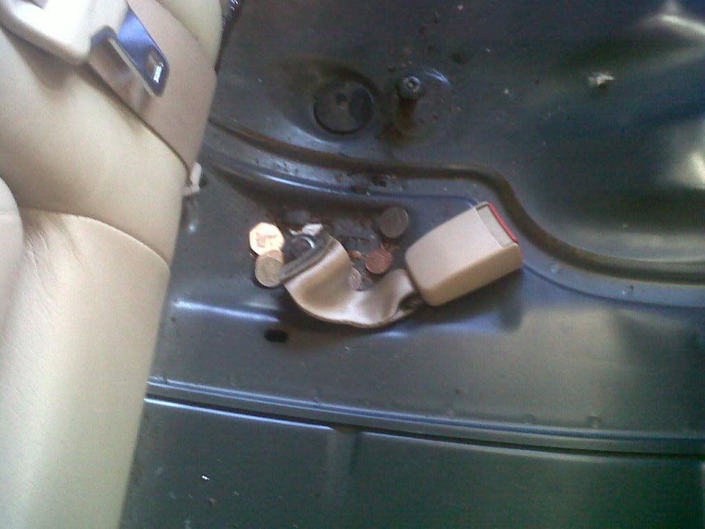

Heres one joy of buying second hand, when i took out the back bench seat i found this:

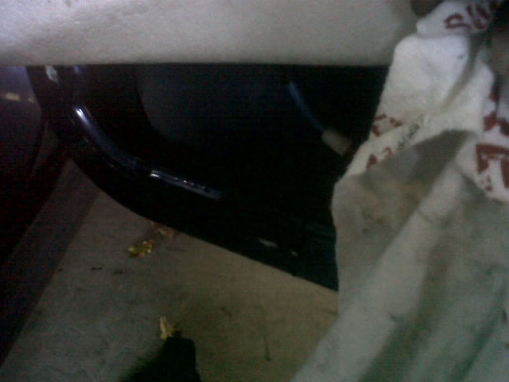

Right i looked at the back doors. But yes the white things werent on right some tool had stuck them on using double sided tape which got damp lost its adhesion and let water pass. That tool is not jean claude, pierre, or vincent its no one from peugeot its my own self i did it, so again another problem fixed on my car and the source of the problem has been me.
It was definatley getting in here:

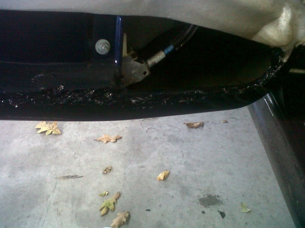

Some clear adhesive sealant not silicone was used to stick it all back on:
