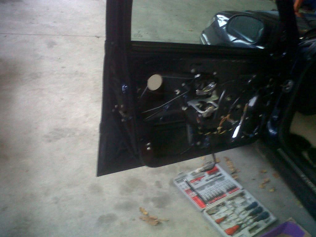

About the front drivers door which didnt have any there at all:

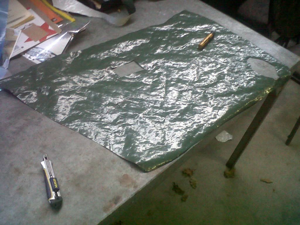

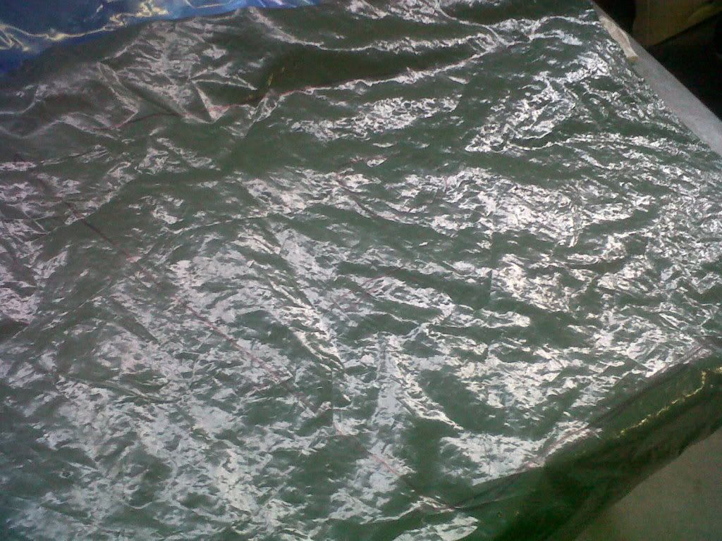

I took the be creative option rather than paying £15 to buy a foam thing, so i got a square of the plastic used to cover the mushroom houses:

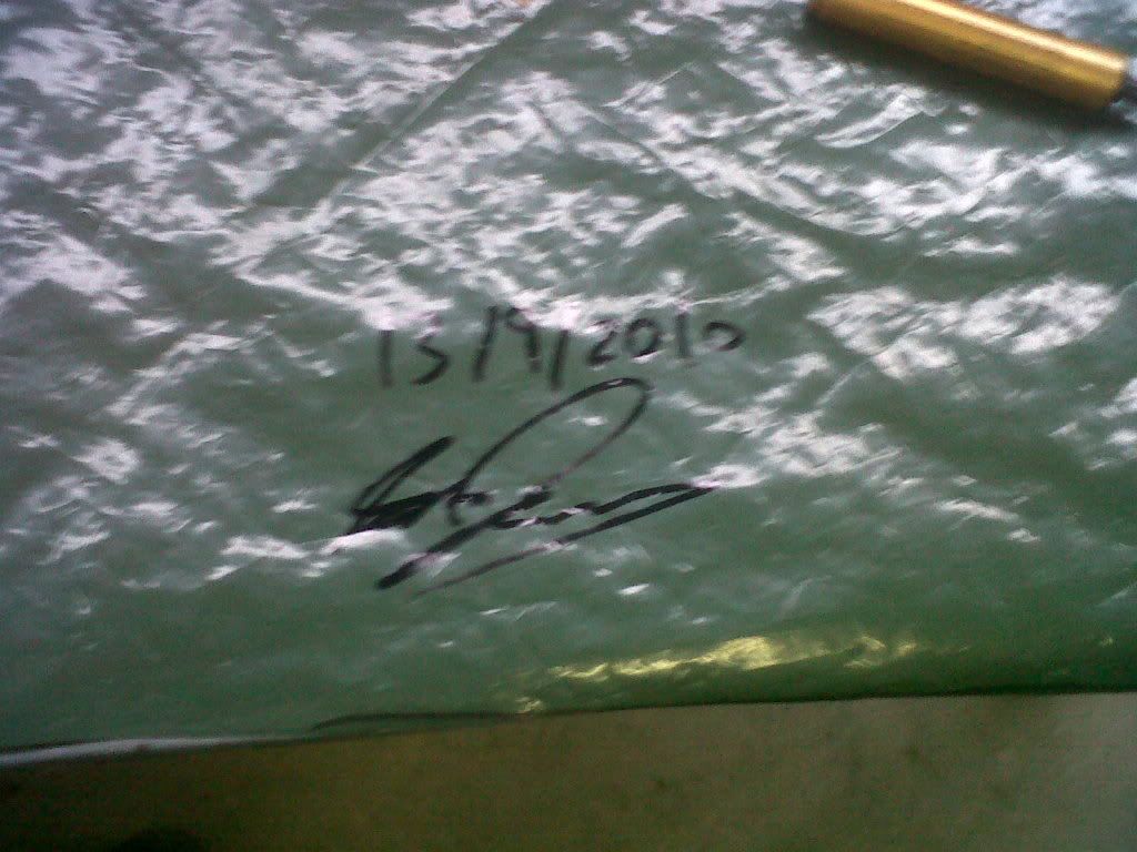

I sat the doorcard over the plastic and drew a line around it, i work on the principple that its easier to take away than to add so dont worry if its too big originally:
Here was the thing cut out:
I like putting a date and signature on my work:

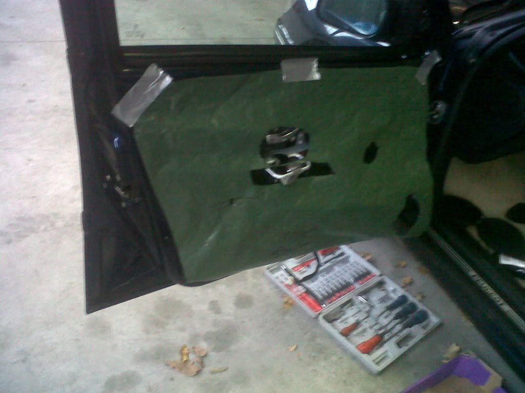

Get it on over the door and use a bit of duck tape to do a bit of trimming to get it just right:
Then i took the thing off, and put on the sealant where the protector will come in contact with the door, a good thick bead means a good seal:

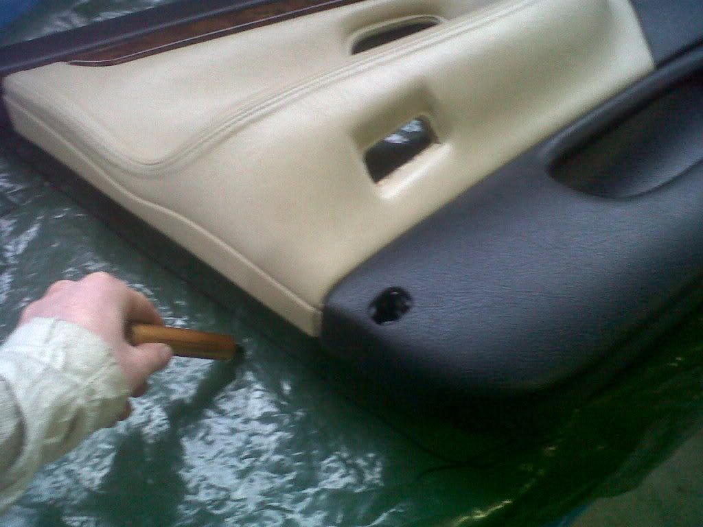

Then i put the doorcard over it, noticed that in the left bottom corner a bit of foam needs a hole, so i cut it out and put the door card back on, with a protector like this one, give the clips a good firm bang on, its popping through the plastic for the first time.
Thats it

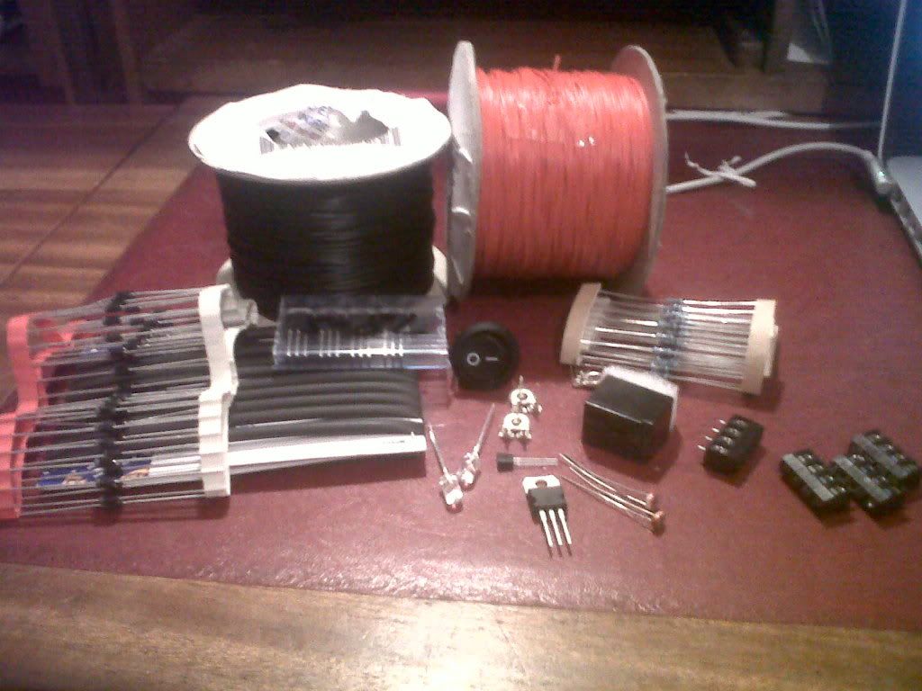

Ive got stuff in the post today, a tub of leather colour restore so ill show you how my seats are kept like new but the best bit is this stuff that come in the post:
A big electrical project is coming up, just waiting on the breadboard now to put it alltogether.

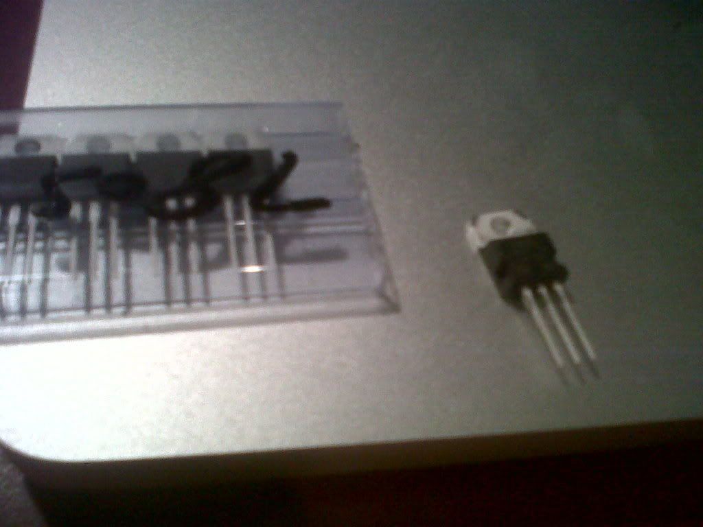

This is plan B of the footwell lighting solution, a ldr controlled relay circuit, it can be used to switch on the footwell lights using a ldr placed over the courtesy light, but with this setup ill be able to hook up another relay to the headlights that will turn them on when the car is unlocked. The key to the circuit is these:
The circuit turning on and off the relay runs on 5v and these voltage regulators do this job, it also should mean that the circuit when not powering the light uses less energy than the thing that remembers the clocks time.

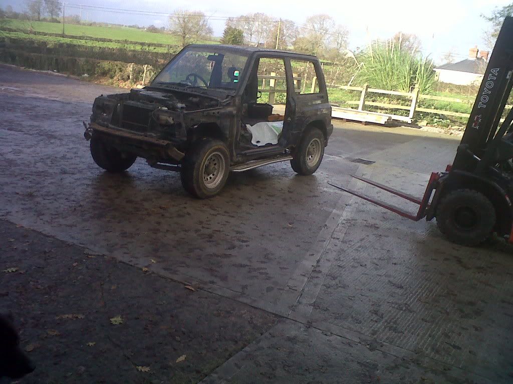

The jeeps ran out of petrol so i started to pull out the engine which on a suzuki is a very easy task only spoiled by the sophisticated suspension (in relation to the samurais leaf springs)

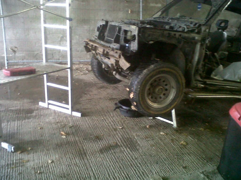

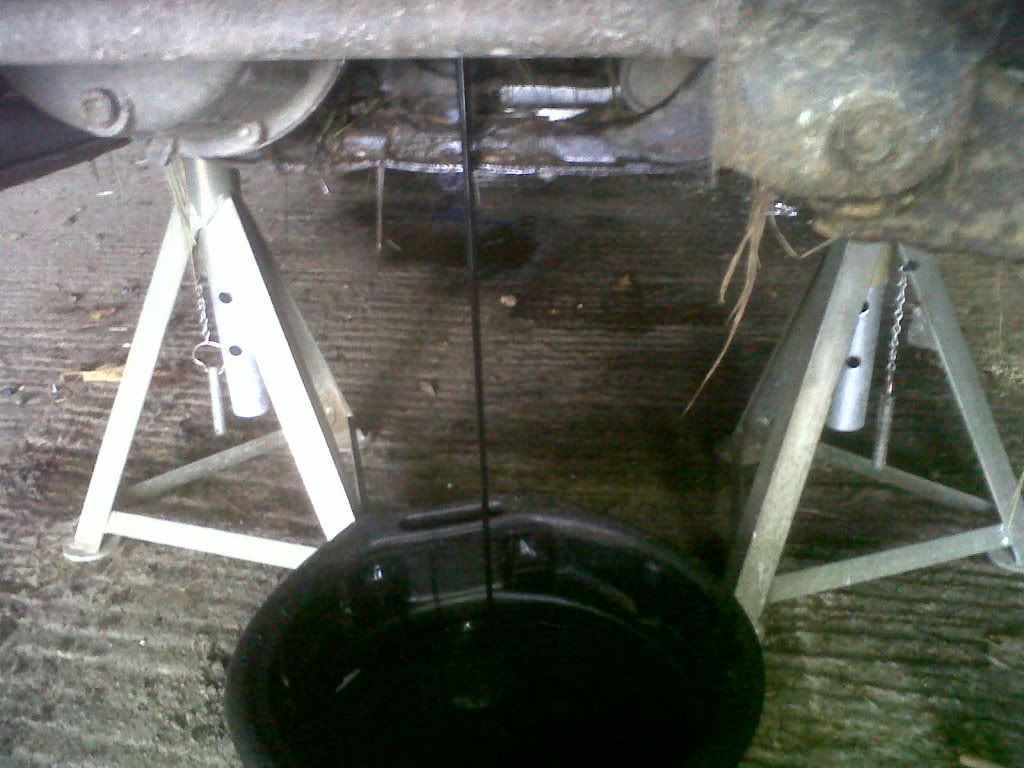

I have no engine lifts, or car jacks, just one thing available, a toyota forklift, so it got lifted up onto axle stands, and kept it from rolling back with bricks:

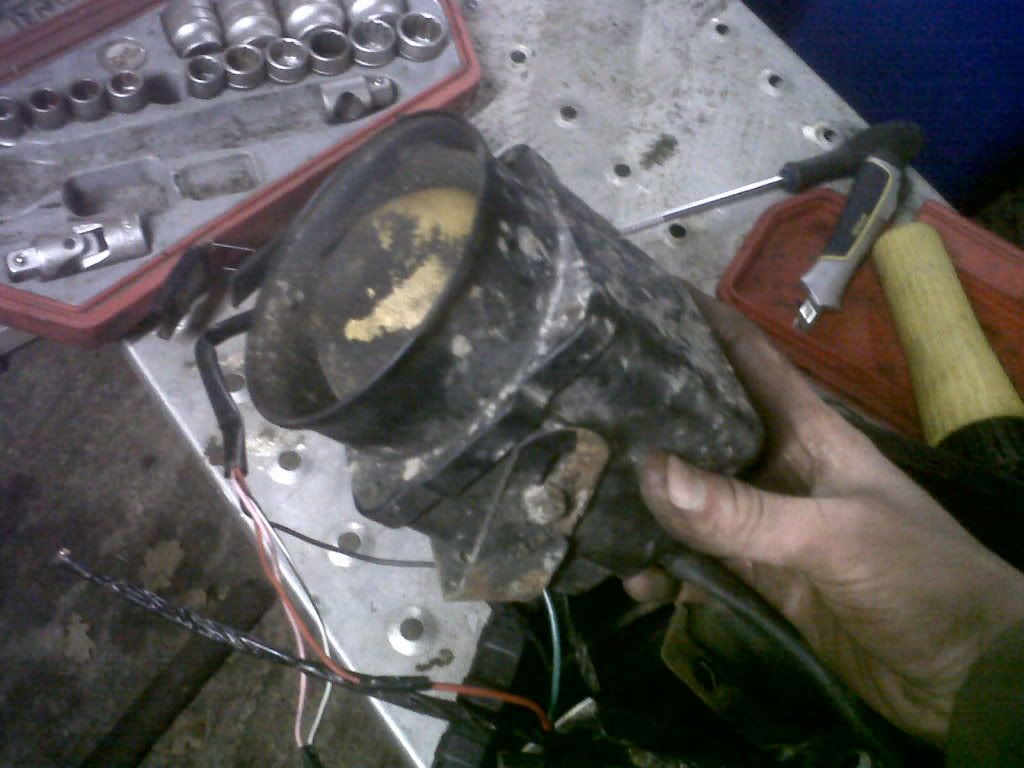

So its now just held in by the engine mounts at the front, and the driveshaft, but whats this odd looking device:

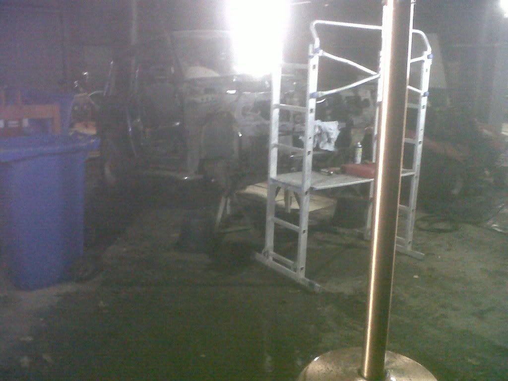

I quit taking it out early since the patio heater im using to keep the shed warm ran out of gas.

Dunno what that is :? at first glance it looked like an alarm sounder but dunno now.
